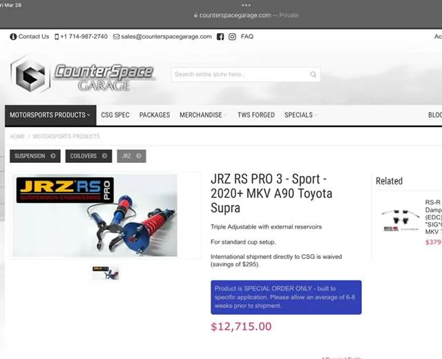

So you're saying I need to drop $4k on the KW full coilover kit with DDC that I've had my eyes on?? Twist my arm.....
You always have options. I’m hoping you get these ?

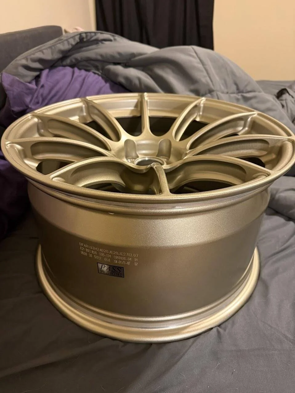

Interestingly you say this - I just got my new rims in today from Apex so that variable will be ruled out as soon as I get some tires mounted on em :)
I have a MT with KW DDC and I have no wheel hop.
