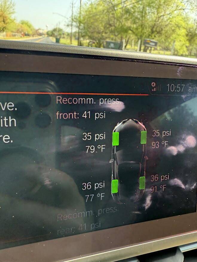

On the topic of tire pressure - I lowered mine down to ~35psi. Less wheel hop. The computer wants me at 41psi. Sorry baby can't do it ?
Of course I still think it's a bit of a band-aid - I should be able to brake stance this thing into a barricade and catch the tires on fire without wheel hop. I've ran plenty of cars at 60+ PSI on drift courses with no wheel hop. Yeah its sketch and you have no traction and the tires over heat super fast but again, no wheel hop in those instances. ?‍♂

WTF. So my sticker recommends 32PSI, my iDrive recommends 34PSI and yours recommends 41?. :crazy:
Is the car taking into account tyre temperature and or/weight? Surely it's not that clever?
Think it might. In the summer I’ve seen the recommended pressure increase 1-2 psi as the tires heat up.

Interesting sticker. I’m in the U.S. and it only lists the pressure for the wheels on the car, and only lists 38 PSI, not a range. I’ll try dropping tire pressure when I have some time to cruise back roads.
Better traction, lower gas mileage.
That’s really the key ain’t it (what Thrax said ?). Those high pressures must be an across the ocean thing to keep our gas mileage on the higher side. Is CAFE standards still a thang?
Doesn't surprise me one bit that you have wheel hop/traction issues when running your tires that high.
On track (turny track) I aim for 32-33psi hot and go out with 25-26psi.
True dat on those hot pressures. By habit, I’m used to pulling outside the garage, check the pressures, bleeding down to 32psi & add gas, all day long. And it’s funny you mention 26psi, cuz the next day/morning when I check em before going out, they’re roughly that every time ?. Guess I could switch it up every now & then & start checking cold pressures.
I’m not worried when it’s as hot as Hades out. But when we do get the occasional 40-50 degrees mornings, I tend to go out higher psi to start. Suppose it wouldn’t hurt to just leave em at 26psi?!?

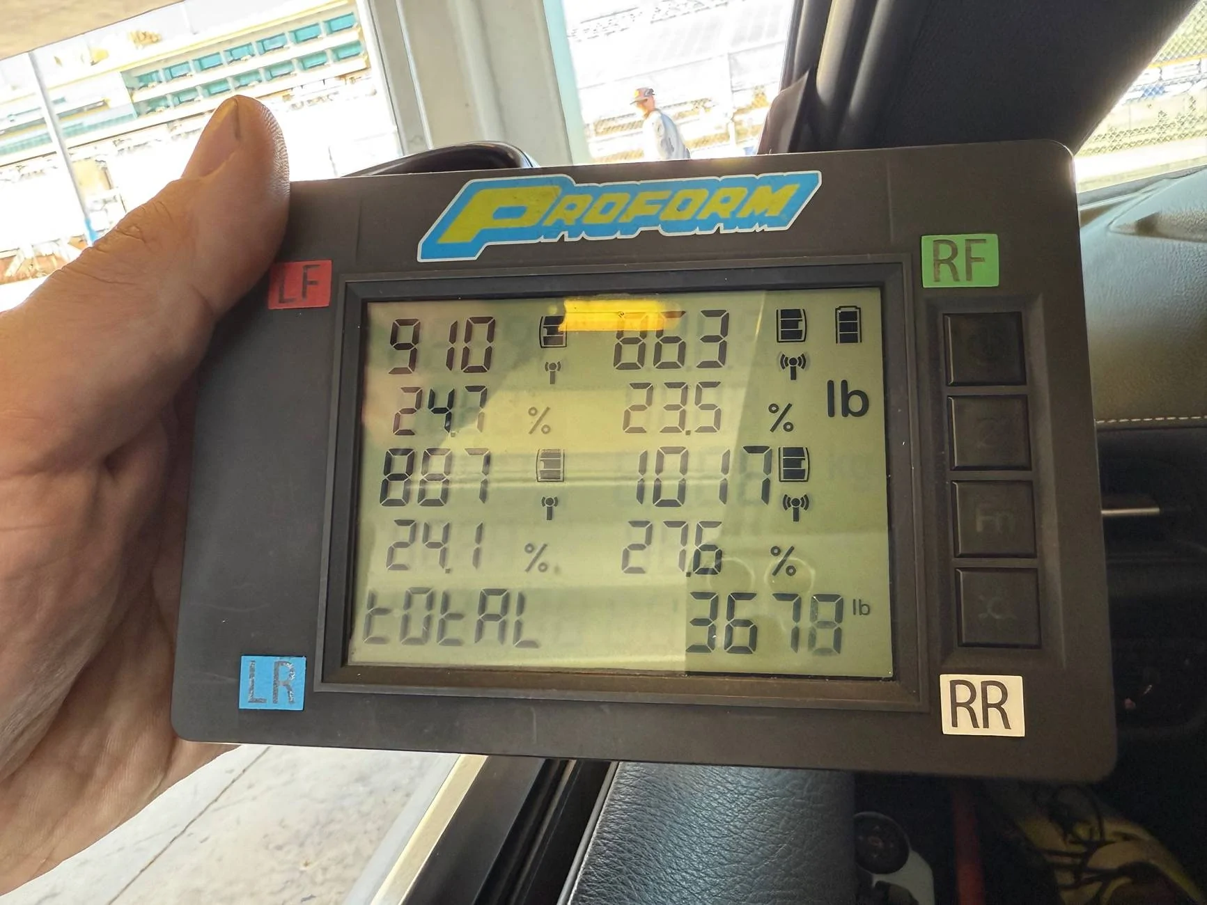

Here is what mine weighs with a full tank of gas.
3363lbs or ~1525kg - she's a big girl! ?

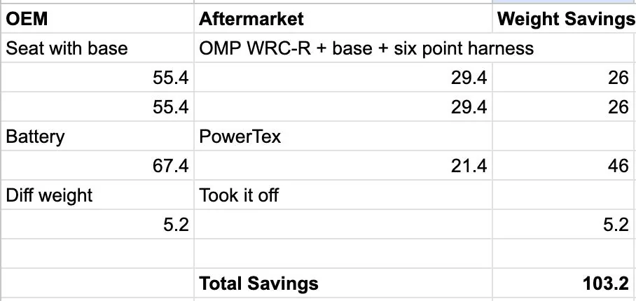

Both seats + lightweight battery + removing rear diff weight saved me 103 lbs.

I wanted to pull that diff weight off as well, but I was assuming it was for NVH and I would get some strange noises or something.

My weight with me in it (~190lbs) and before I switched out the OEM battery & seats. Like Bryan said, that battery and seat exchange makes a big difference!
