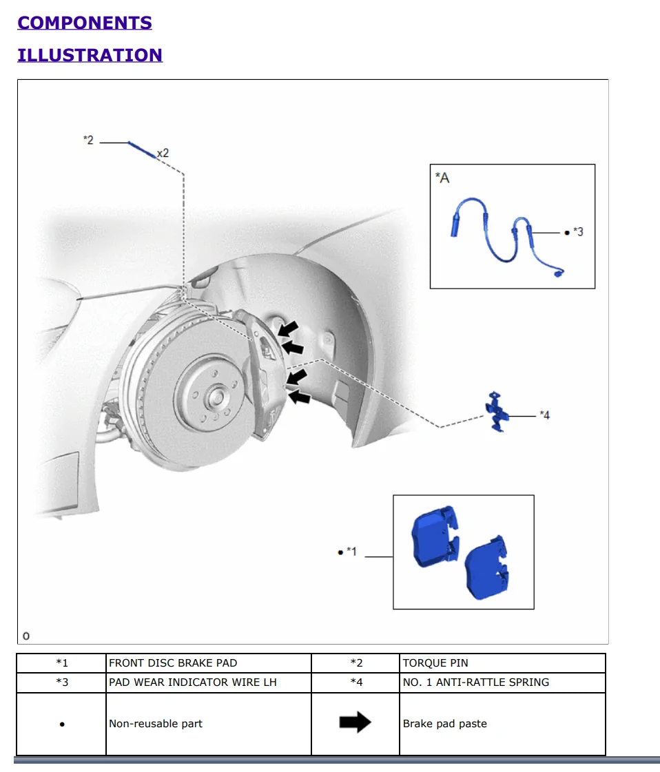

Not the best visual but this is from the factory service manual.
One end of the cable goes into a small black box where it clips into the main harness. The other end pops onto a tab on the inner brake pad. It's very easy to do, it will make sense once you look at it. Just be careful with the clip that goes onto the brake pad, it is not exactly robust.
Thanks for the diagram, bro!
I went and had my car lifted, removed the wheel, and it was 100% straightforward.
The ONLY thing that seems iffy are the little groves that hold the wire in place. It seems to be a slightly loose fit, which is why I'm guessing it fell out lol.
Hoping it's not the case again but if it does fall out again, I'll just tape the wire onto the metal groves.
