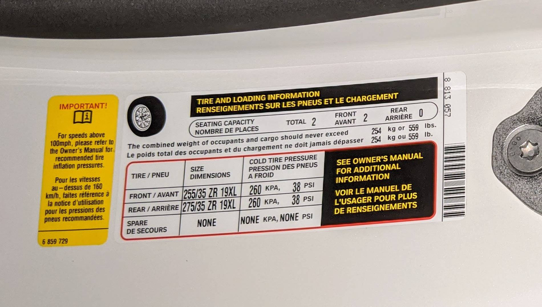

38-40
Just whatever the computer yells at me to do.
whoa...seems way too high - i'd have have double check but I think OEM tire/wheel is like 33psi?

Doesn't surprise me one bit that you have wheel hop/traction issues when running your tires that high.
On track (turny track) I aim for 32-33psi hot and go out with 25-26psi.
Isn't 32-33 on the high (edit: i meant low!) side for cars that weigh as much as ours?
This is from trackdays.ie, but also mirrors most of what i've come across online about this. Appreciate any advice you're willing to share about this, because i've been struggling while trying to get this right.
