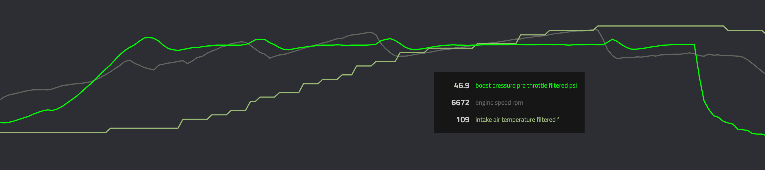

Why do I always see IAT numbers posted on this from cruise or idle?
What would actually be useful are logs from single WOT pulls so we can see IAT increase through one gear and also logs from sustained WOT pulls across gears. Like this:
Because I don't know what the hell I'm doing and just take screen caps of my phone when I'm not at WOT so I don't die wrapping myself around a tree or a light pole.
I believe I can do this now with Ecutek logging. So I'll figure it out.

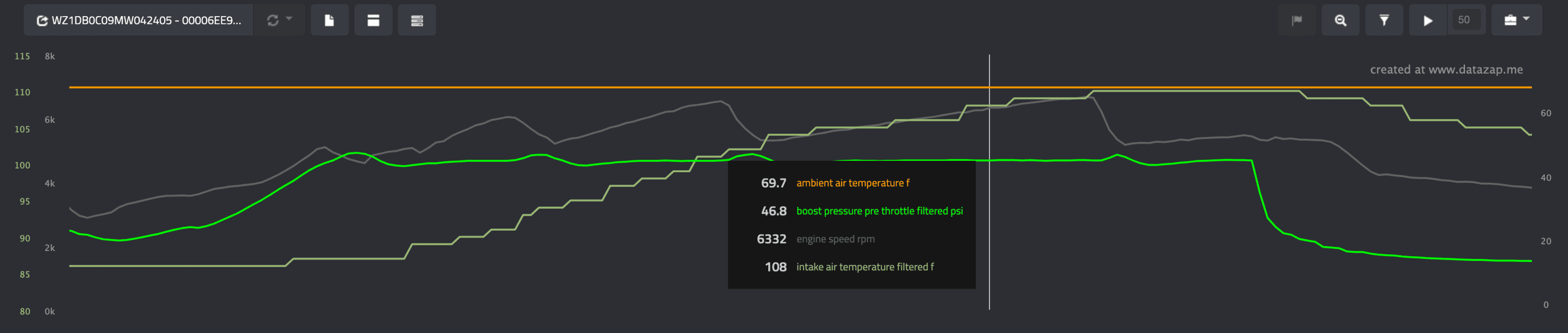

How's this?
79
8,402
13,712
I'm assuming that is top of 4th gear at 32psi?
So about a 22F gain from the beginning of the pull until that part of 4th gear.
That's right. Weather was hot and sticky last night. I usually don't see increases that high. I'm also suspicious that meth didn't trigger or something. Maybe it did, but a 22°F increase is very high for a race like that, in the evening.
I don't know what's good or not with upgraded IC's on this platform, so I'll trust your experience. :)
