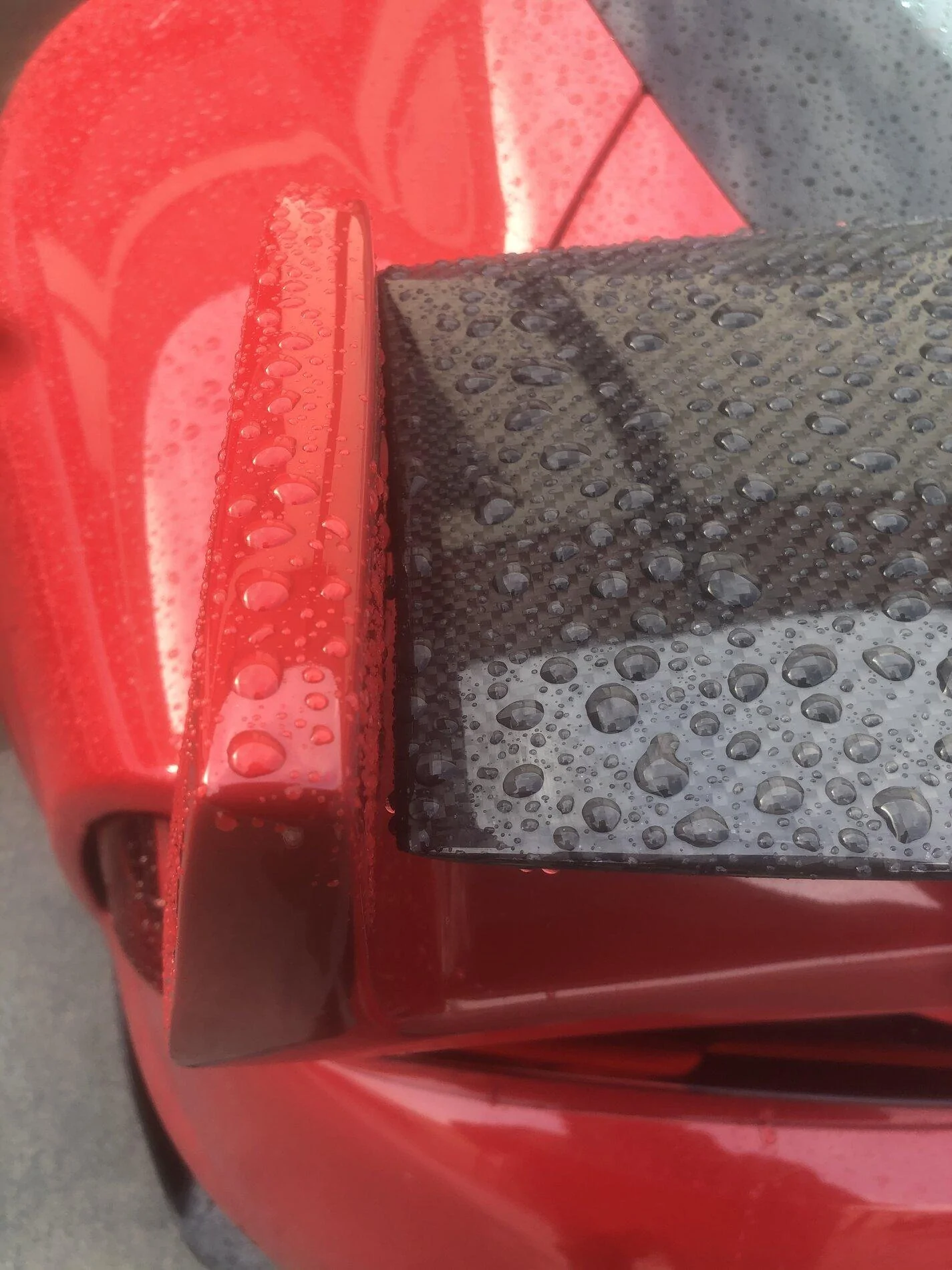

I didn't have a problem with fitment but the fact that the screws provided were not rust proof shows the lack of experience in parts development. The screws are rusting and its causing rust water to drip all over the rear after every car wash. It's so annoying!
Eek! I would run to Lowes and get some stainless steel hardware before they become hard to remove.
Most hardware stores will have that board which will allow you to match up thread/bolt sizes for both SAE and metric. I'm actually thinking of getting one for home.

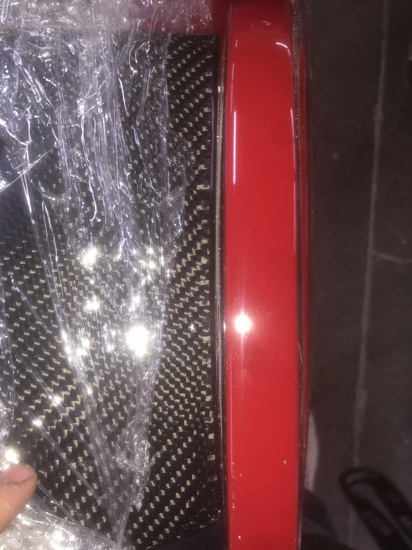

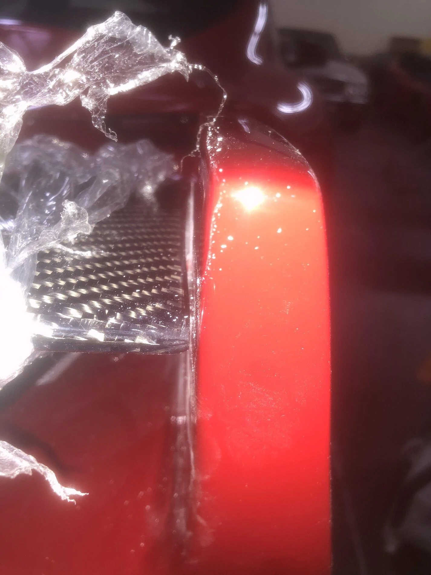

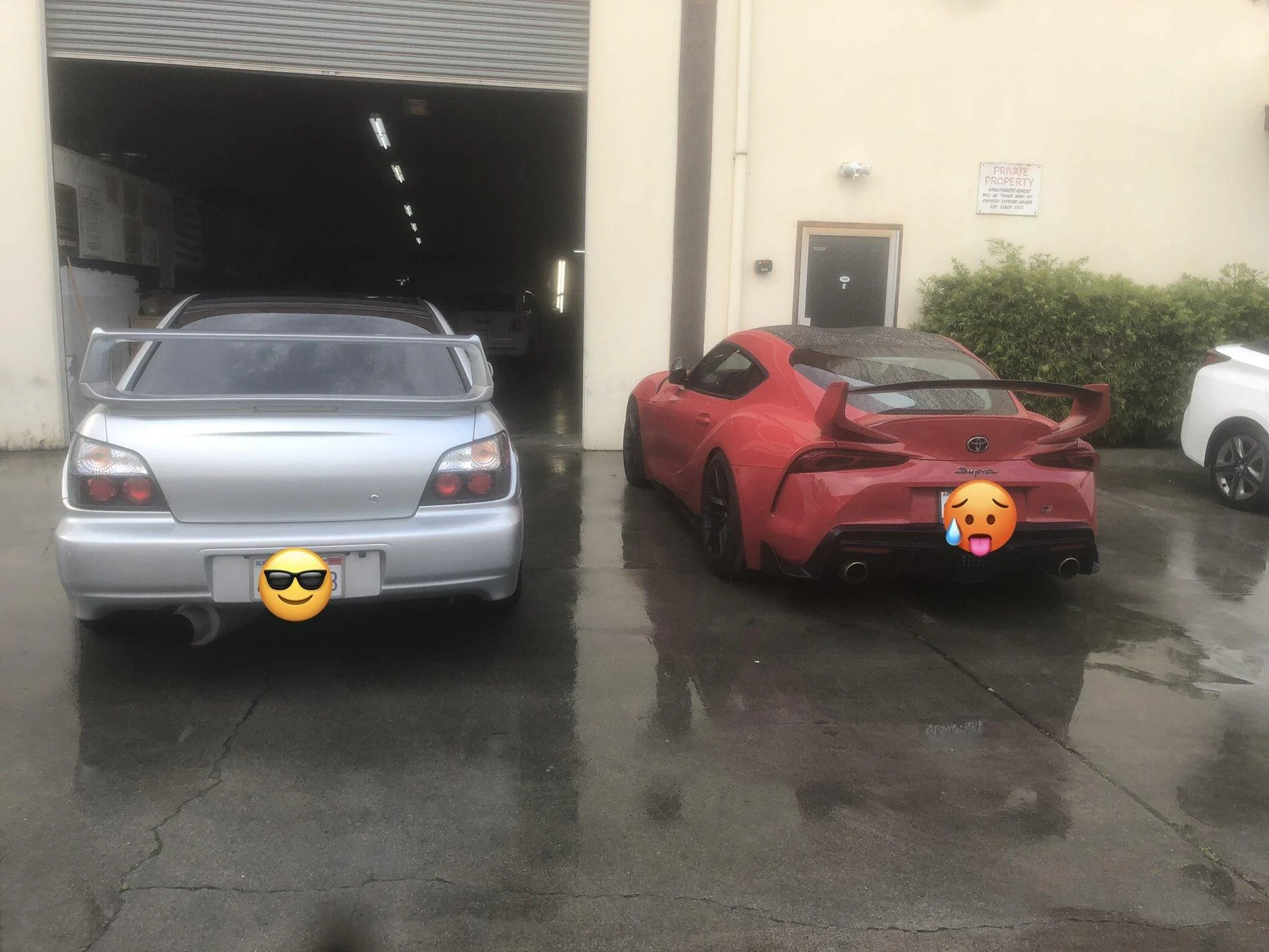

Hi all,
I recently purchased the StreetHunter Design rear wing for my 2020 Supra. Overall thoughts on this are it is a great and design, Toyota should’ve had an option to add a wing similar to this like the mkiv trd wing, but the quality could’ve been a better especially for the price paid. Also to mention there is no template for drilling the holes into the trunk lid which isn’t the end of the world, but it could’ve made life a little easier. After driving around with the wing, and from what I saw on another post, it seems the hardware included with the wing isn’t galvanized so that’s one thing to keep in mind.
I brought the car and wing to a high end shop here in the Bay Area that specializes in bodywork, paint, installing high end aftermarket parts for cars such as Mercedes Benz, Bentleys, Porsches, Ferraris, Lamborghinis, and so on. Euro Design in South San Francisco has been around for more than 25 years and they have lots of experience with aftermarket modifications such as installing a wing like this one.

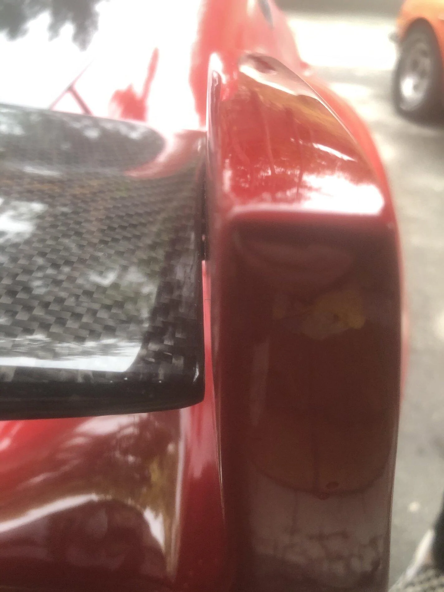

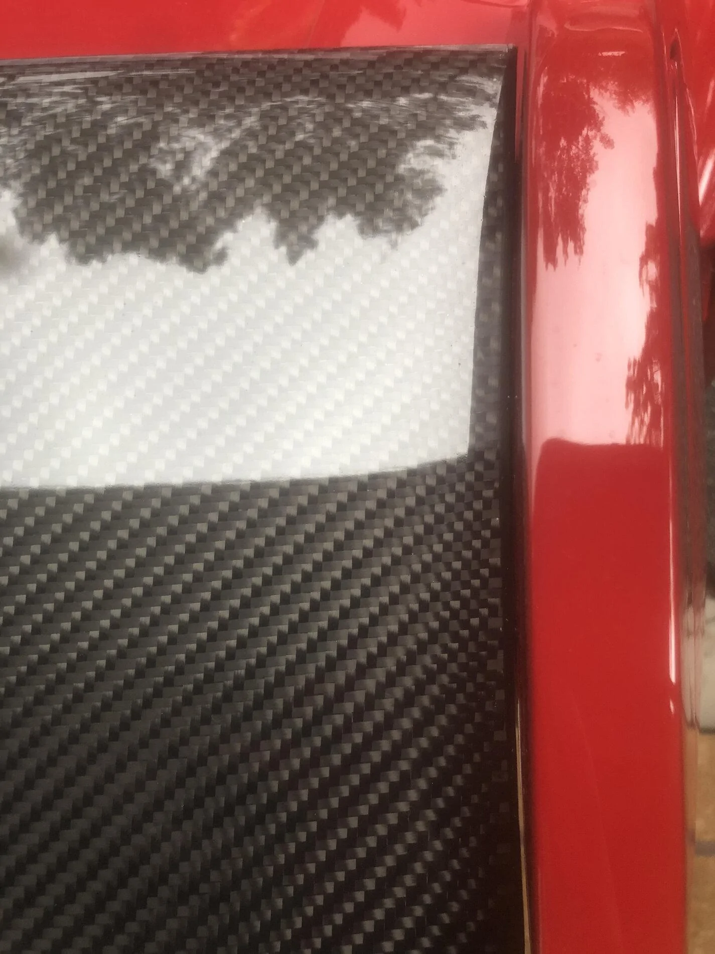

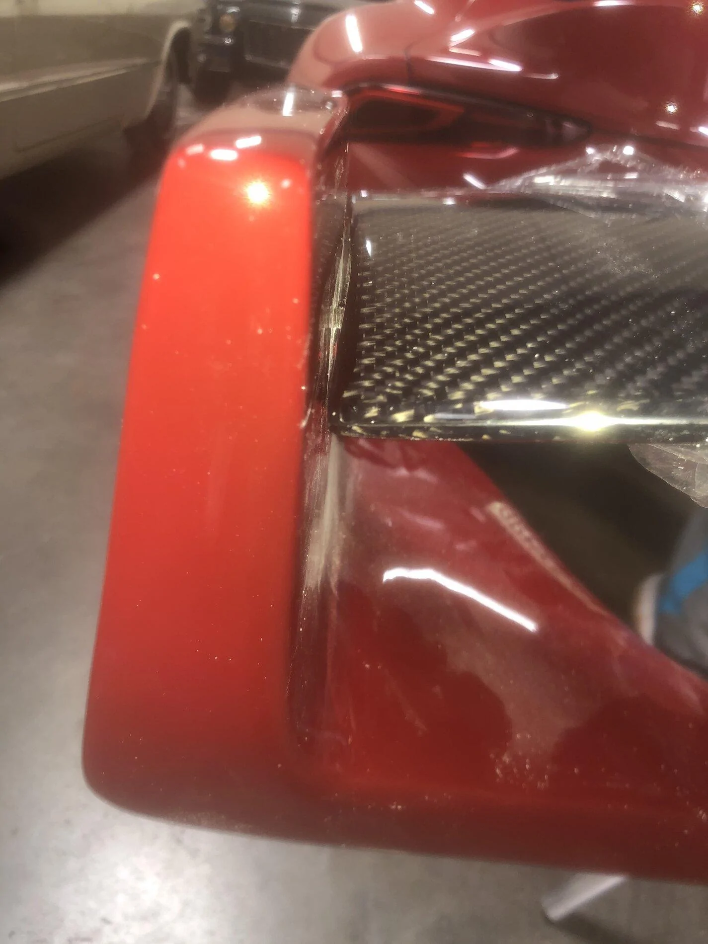

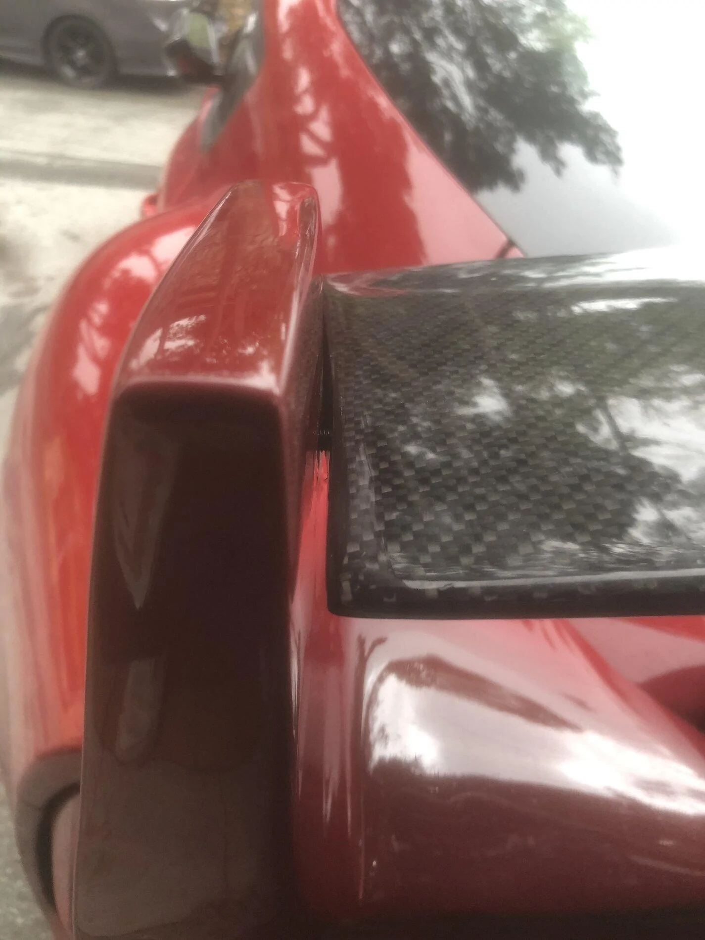

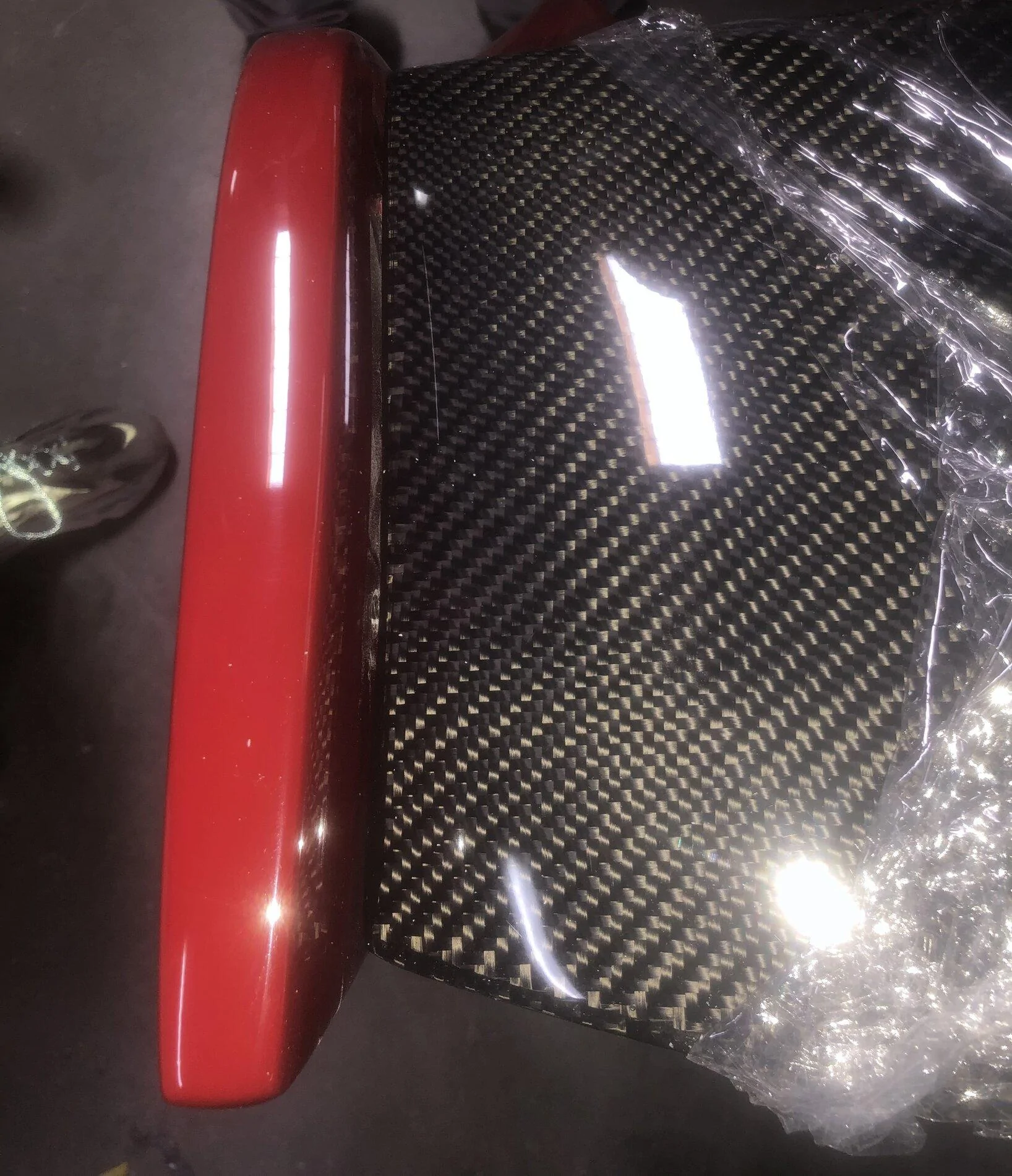

I was present during the install process. Upon initial inspection of the wing supports and bridge it looked nice, like it would be a piece of cake to install. It would have been nice if the center of the supports where the screws are supposed to Mount to the bridge was pre drilled and ready to go. Not the end of the world, but would’ve made life a bit easier. The shop drilled those holes and painted the supports in Renaissance red 2.0 because they figured the fitment of the supports to the bridge would be pretty much perfect especially for the pretty price tag of the wing. Once it was painted, they tested the fitment of the assembled wing and noticed immediately in between the two holes that we had to make in the supports, there was a bit of a bulge on each support not allowing the fitment of the bridge to the supports to be flush. I then emailed and spoke to someone from the StreetHunter Designs team who said that their supports are hand made and the shop is doing something wrong. He also said it would fit fine once the bolts connecting the wing supports and the bridge were tightened down.
Upon further adjustment of the wing and fitment of the bridge to the supports, the bulges were still an issue. In order to correct it, they grinded the bulges down, not too much but just a bit, and the fitment was much better than before however not perfect. They then mocked up and drilled the holes into the trunk lid. Another thing to mention is the provided hardware that goes into the underneath of the wing supports and attaches it to the trunk lid fit the holes in the supports but were a bit loose, you could wiggle them around a little.
(Edit: Apparebtly the looseness is intentional, it is there so if the holes you drill don’t exactly align with the holes in the supports, it will still fit)
After the fitment was finalized, the wing was taken apart one last time and the supports were touched up with more of the Renaissance red 2.0 paint to match beautifully with the rest of the car.

Chiming in has anyone found galvanized hardware or a direct replacement for those rusty screws? Running into the same issue
Not sure if you have them in your area, but Ace Hardware has the best selection by me.
I would not count on galvanized from experience, go with stainless steel.
In the interim, I would take the fasteners out and wire wheel them to remove all the rust. Then use anti-seize on the threads and paint the heads with oil-based nail polish.

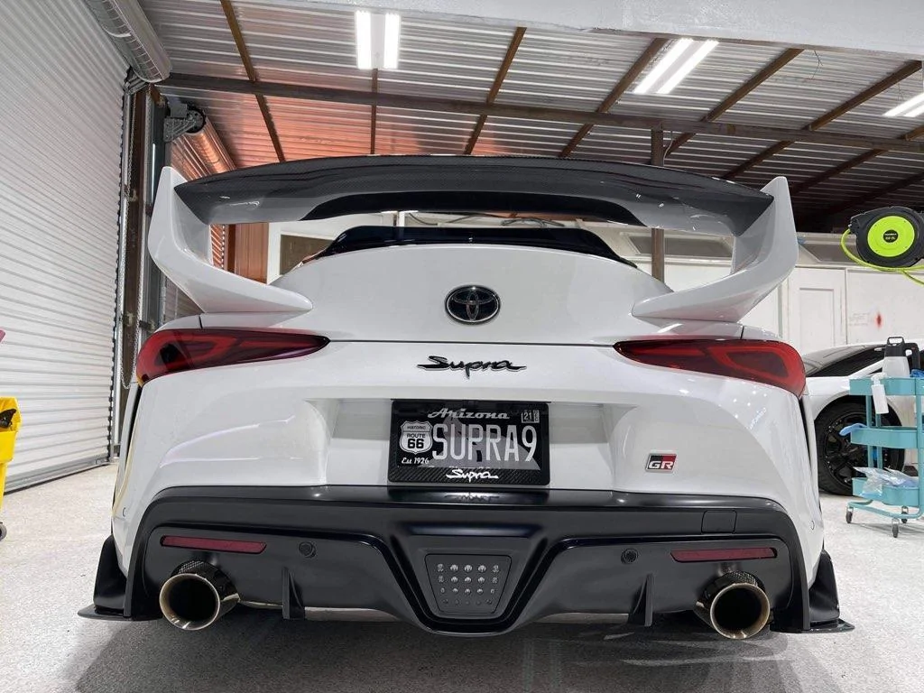

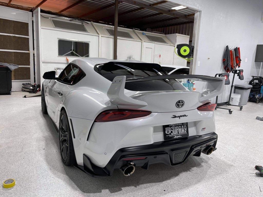

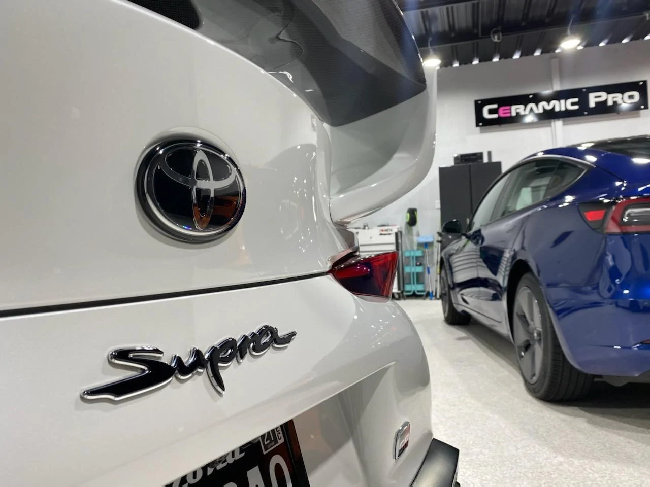

For those of you with the Street Hunter Wing - What adhesive are you guys using between your wing and trunk to prevent any water leaking in? Just got my wing recently and was wondering if the adhesive would show on the Absolute Zero white.
freeform911
Steve
Nov 21, 2020
905
870
Beaufort South Carolina
Get some closed cell foam...
1/16" is enough to keep water out n shouldn't show (much)...
