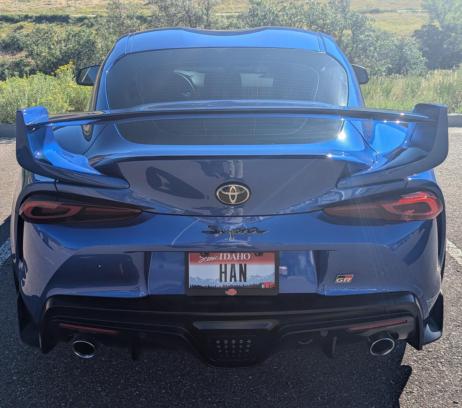

FYI the non-cf version of the Streethunter style replica "sh style" on their website does not come with pre drilled holes for connecting the blade.
3 holes pre-drilled on the bottom of each stand
2 holes pre drilled on each side of the blade (which is CF)
But not the two holes to bolt the blade and the stands together unfortunately. it does come with a piece of tape placed with white dots to indicate where it should be drilled, but I definitely don't trust those.

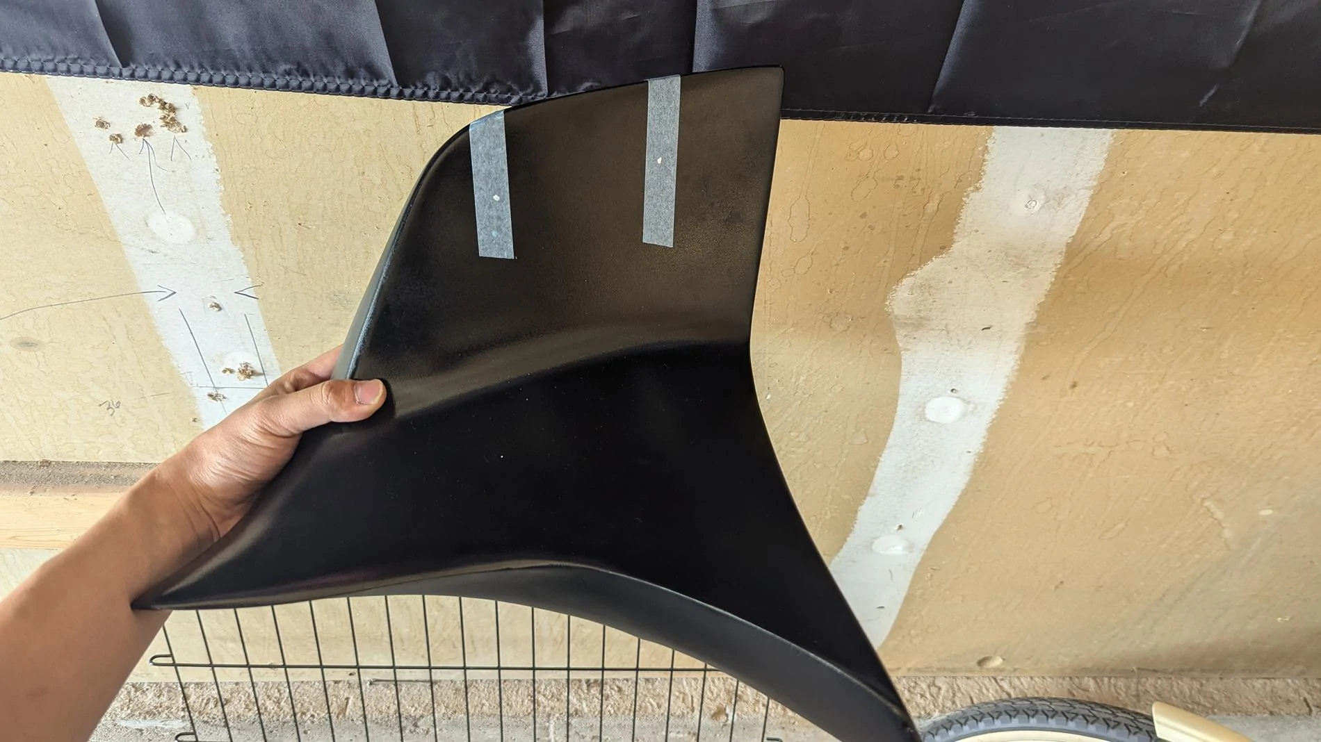

The outside of the stands where the end caps are does have a hollow cut for the outside, but the inner wall still has to be drilled.
On the full CF version from thicc whips YouTube video, all holes are pre-drilled including the cf stands for mounting the blade.
Secondly I've found the item is no longer listed on suvneers website at the moment

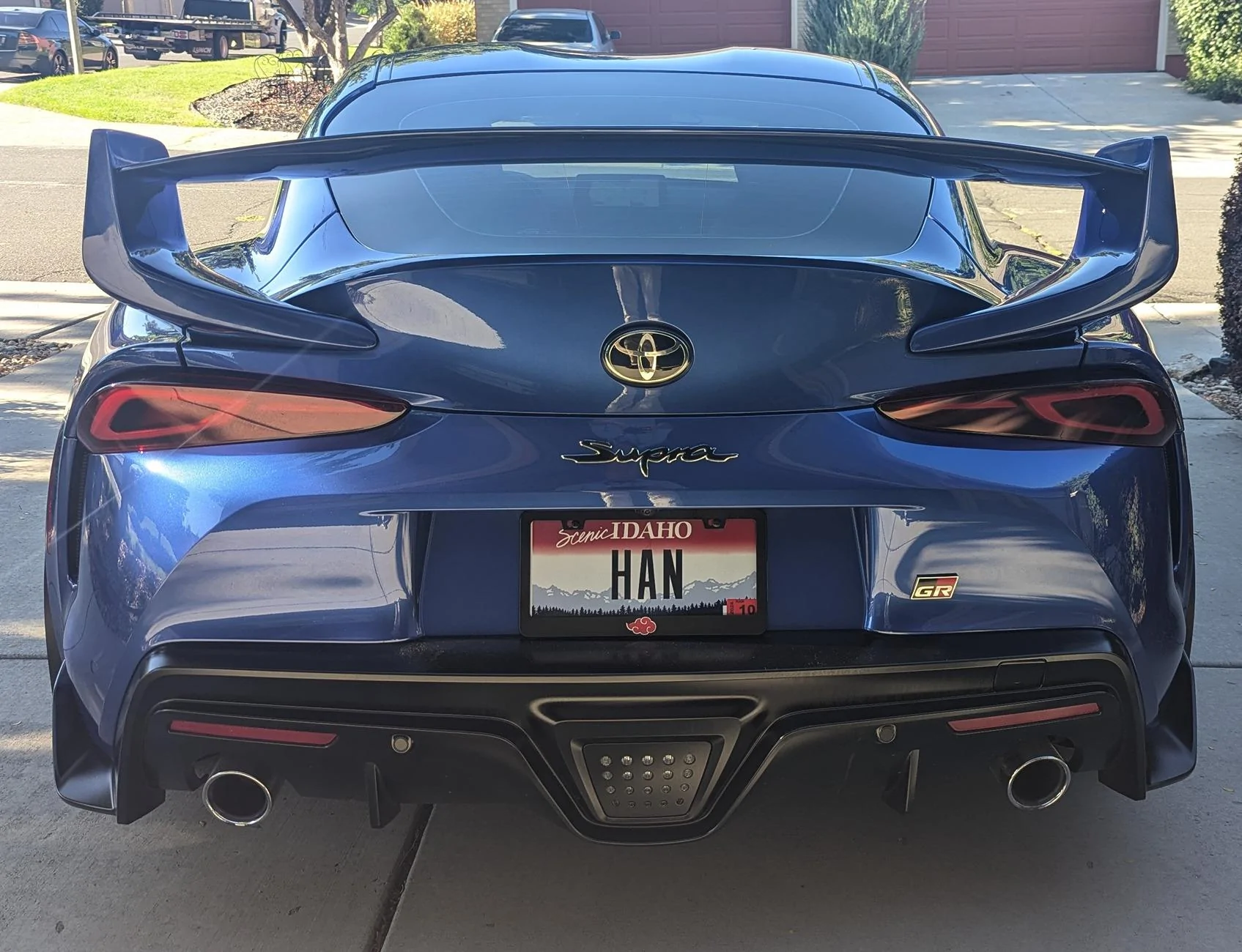

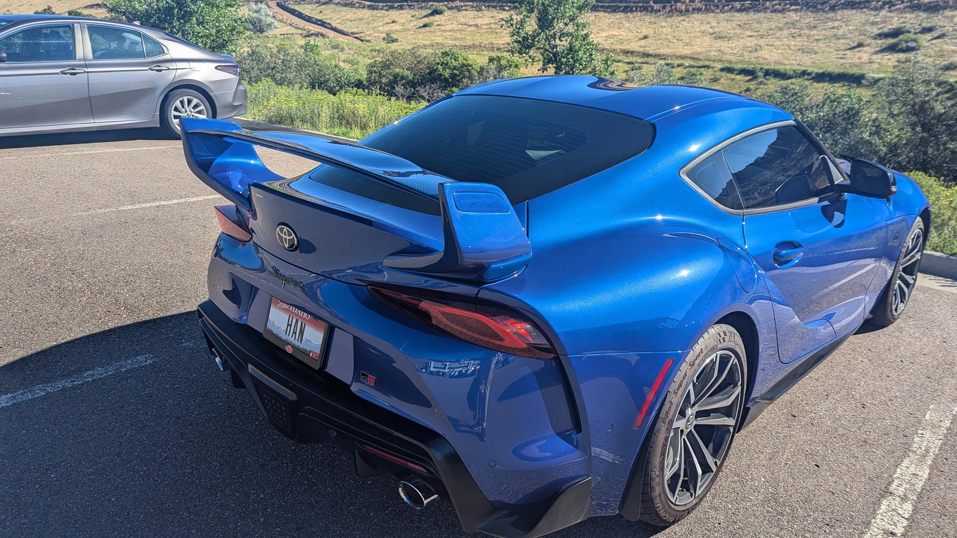

Once I'm at home I can give the full hardware list I used. In the meantime, here's updated photos.
@Erty in the end I actually preferred that those holes were not drilled. Because this meant that I could choose my own angle of attack for the blade portion of the wing. Some people choose a more aggressive angled style, I chose to have it more flat.

6x M6 bolts @35mm length
6x M6 washers @ 16mm outer diam
4x M5 bolts @40mm length
4x M5 washers @12mm outer diam
All in stainless steel. The washers you could go a bit larger in outer diam like Vegas17 is suggesting.

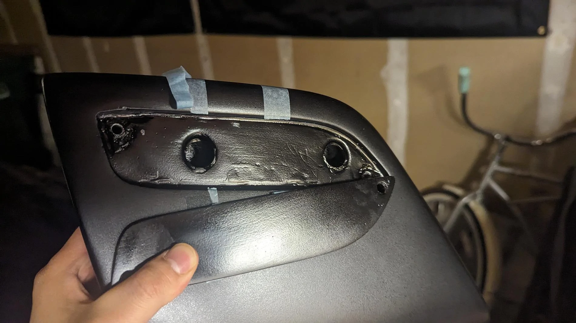

I also had the shop removed the screw holes and used a combination of 3M to attach, and silicone to water proof

Definitely spend the time to fill the holes on the cover plate. Looks much cleaner and the 3m tape is plenty strong to keep it in place. Fortunately the carbon blade is really well made imo.

Wait dumb question, but they took off the wing and then used 3m tape to full the holes and then screwed the wing back onto the car?
He's talking about the end plates on the winglets. They come with holes to cover the mounting points. There are no longer holes in them because he filled those and stuck it on with 3M.
Han_Supra
Jul 26, 2023
56
34
Denver, CO
2023 Toyota Supra 2.0 Stratosphere Blue
Yup, Erty is correct. I don't know what material they used to fill it. but the 3M tape was for sticking it on there since it no longer screws back on.
