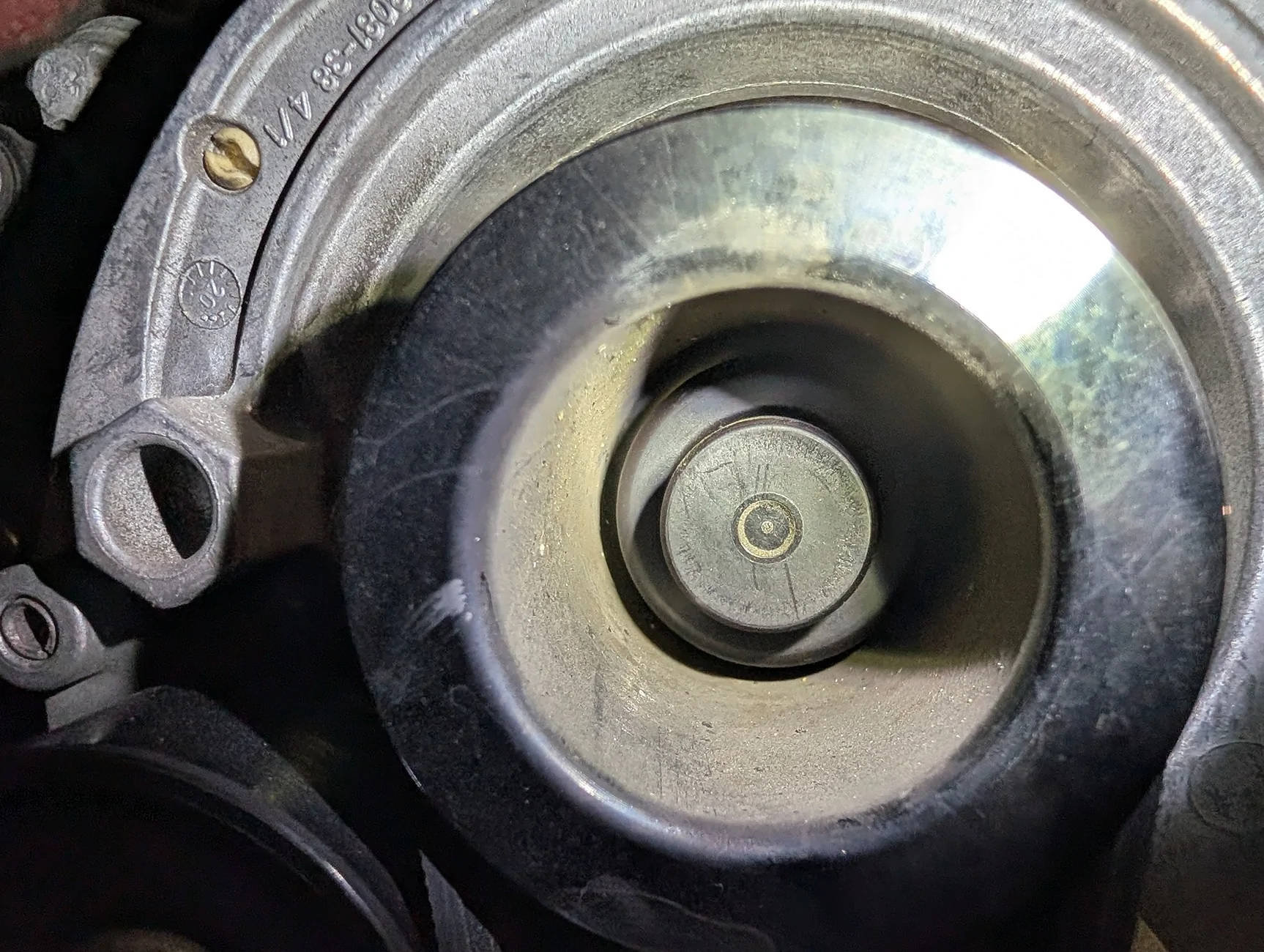

I'm trying to follow their instructions -
  • Detension belt
  • Remove plastic cap in center of alternator pulley
  • Hit nut inside current pulley with impact gun to spin it off
  • Remove old pulley
  • Thread on new pulley (we do not recommend loctite)
  • Hold center of alternator shaft with a torque wrench in the off (counterclockwise) direction - the alternator shaft is a 10mm 6 point hex (do not use 12 point). Hold Strom Overrun pulley hex with 27mm open wrench and tighten to 38lb/ft - 50Nm
  • If you do not have a torque wrench that can go in the off direction then hold it with a normal wrench and make it nice and tight, it is not a critical torque spec and the pulley will self tighten in use as the alternator spins and loads.
  • Reinstall belt
  • If you don't understand these instructions then do not install this yourself and have a mechanic do it.
Anyone know how to remove this? I dont see a cap or nut
