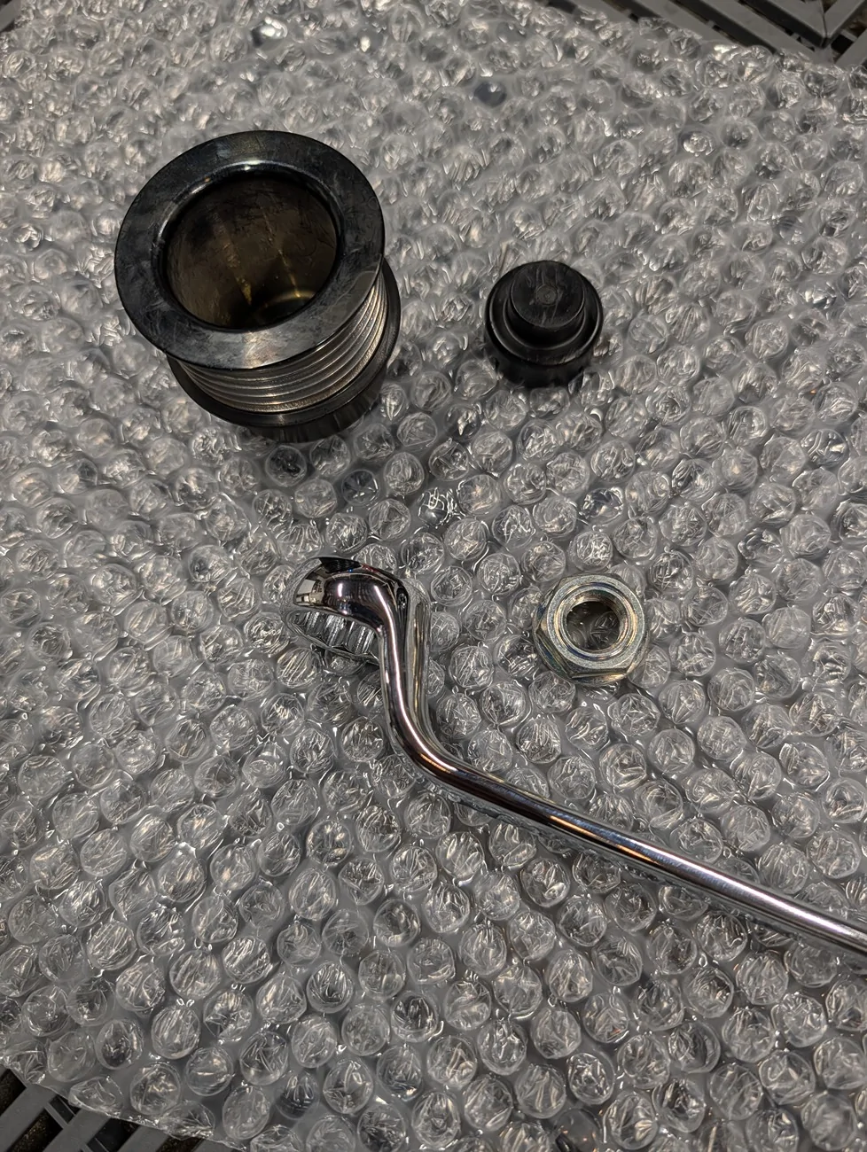

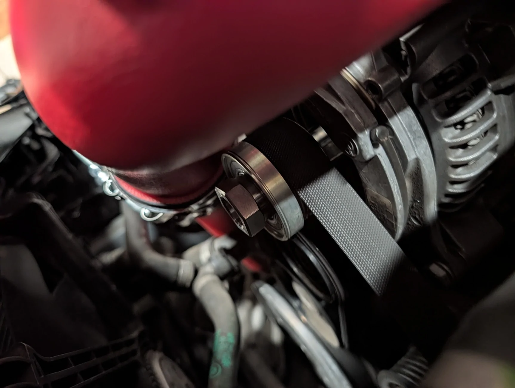

I yanked that knob and it worked!
Some added notes in bold
  • Detension belt
  • Remove plastic cap in center of alternator pulley (pry off with a pick)
  • Hit nut inside current pulley with impact gun to spin it off (impact gun didn't fit the space)
  • Use a pass through deep socket (22 mm) and hex key to get the current pulley off.
  • Remove old pulley
  • Thread on new pulley (we do not recommend loctite)
  • Hold center of alternator shaft with a torque wrench in the off (counterclockwise) direction - the alternator shaft is a 10mm 6 point hex (do not use 12 point). Hold Strom Overrun pulley hex with 27mm open wrench and tighten to 38lb/ft - 50Nm
  • If you do not have a torque wrench that can go in the off direction then hold it with a normal wrench and make it nice and tight, it is not a critical torque spec and the pulley will self tighten in use as the alternator spins and loads.
  • Reinstall belt
  • If you don't understand these instructions then do not install this yourself and have a mechanic do it.

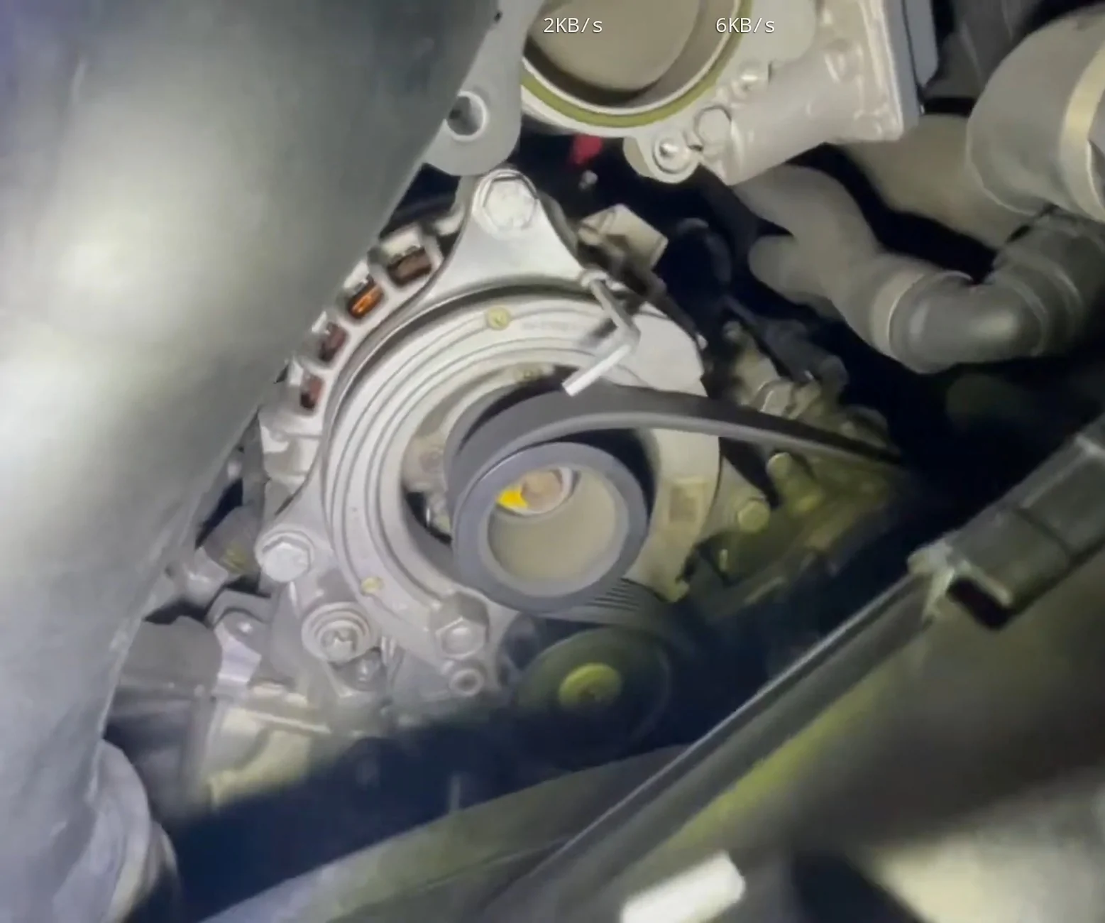

I didn't use any special tool. If you can fit a plier to grip the plastic cap, a firm pull should do. I had to use a pick tool and small flat head screwdriver to get it out. Other than that, maybe a pass through deep socket?
They also updated their instructions PDF.

Ah ok. Wasn't sure if we needed an offset tensioner tool or thin-wall passthru socket.

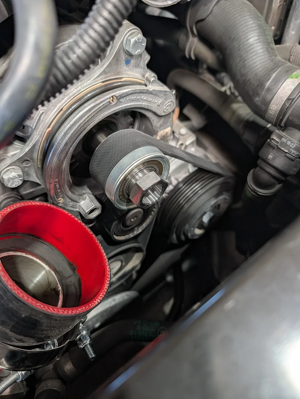

Found a neat tip on YouTube, after you use a 16mm socket to rotate the tensioner pulley, you can shove an allen key in to hold it in place.
I have been looking to acquire a larger set of pass through deep sockets and I can't find anyone who makes them. GearWrench used to make a set that ran up to 29mm I believe but it's discontinued. Is there anyone who makes them now? If you don't have a pass through socket that size, what do you advise? My current set only goes to 19mm.
