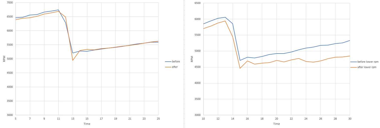

From what I remember, the effective inertia of an traditional (non-MGU) alternator is somewhere in the ballpark of ~10% of the rest of the engine system (including crank, recip assembly, and flywheel/flexplate, excluding everything else downstream of the clutch). So I would expect the upshift time to reduce by something like 10-20% quicker, tops, assuming the same clamp load.
Obviously, the tensioner is going to be happier regardless of the actual amount, since we're not momentarily turning the slack side into the taut side. The strom video shows the tensioner slap pretty well.

Looking at the data with MHD logs, results are inconclusive. I don't have enough resolution to really zoom in to the slope mid-shift - it's always 2 datapoints from peak to trough.

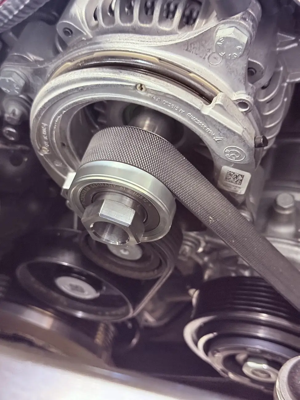

I installed it on my manual, it doesn't rev hang as much, which has helped with smoother shifts. Unfortunately, haven't driven the car much since installed so it might all be in my head.

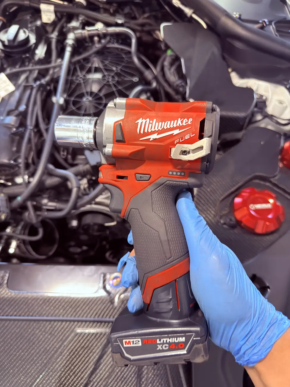

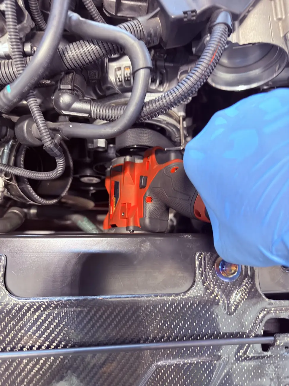

I'm an idiot and didn't use a 6 point 10mm on the alternator shaft first go....stripped....got a 6 point....stripped. Don't be me.
RyanA90
Ryan
Aug 6, 2020
32
1,149
1,205
Fairfield, Ca
www.instagram.com
‘23 Supra A91-MT Burnout
I didn't either but I didn't strip it.
That's good enough for me
