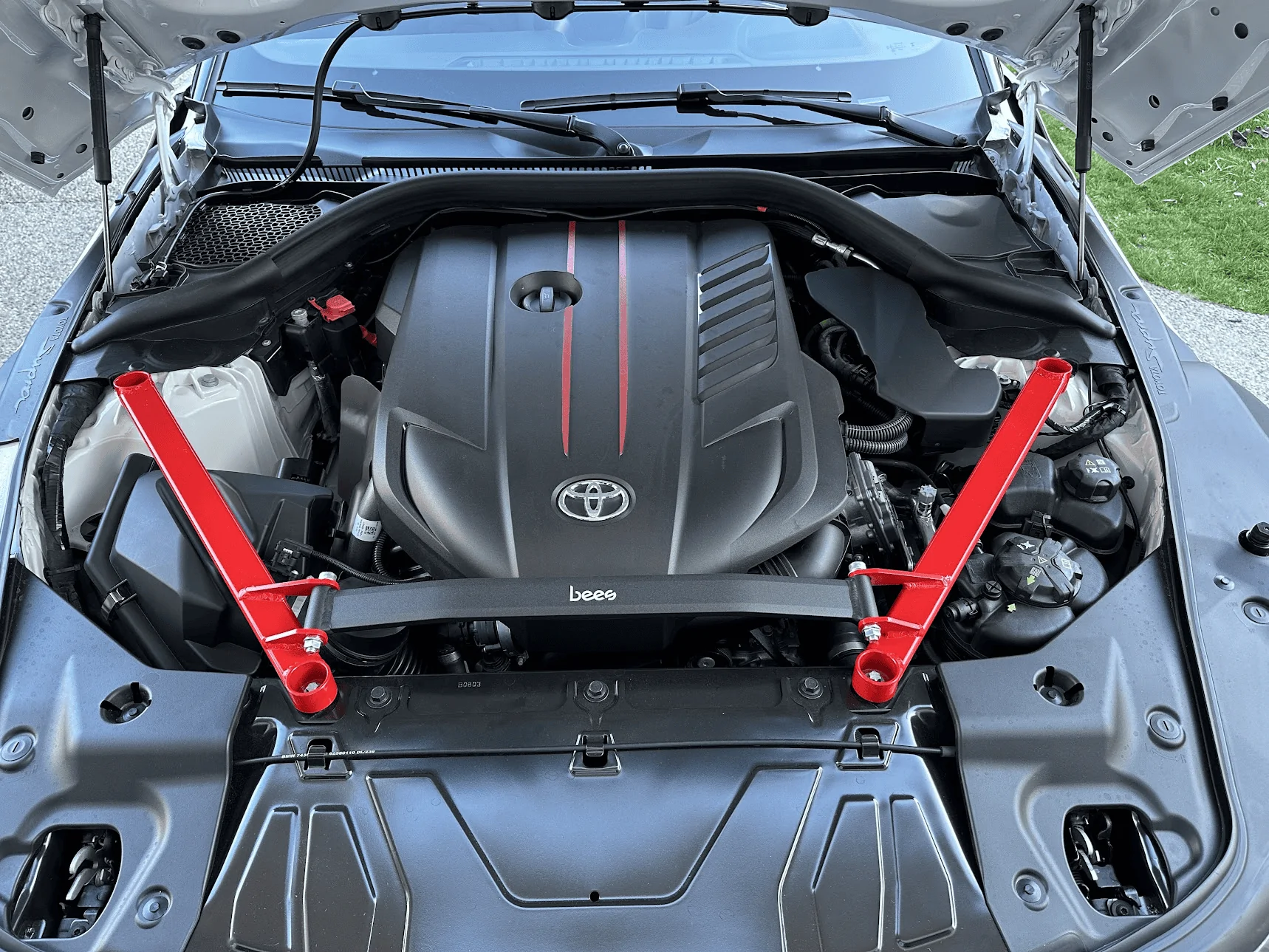

Your car will have the factory bare aluminum strut braces. I upgraded mainly for aesthetics but went with the RacingBees Strut bar, identical to the Blitz apart from the logo and it's a fair bit cheaper

In my opinion they will not add much stiffness. Keep in mind that the strut towers are already triangulated against the firewall (the stamped steel pieces under the rubber weatherstrip) in addition to the stock strut bars.

Every Supra already has a proper strut bar triangulated to the firewall. Even 2020’s. It’s under the weather stripping and windshield wiper plastics.

I put it on my 2020 and noticed in the mountains, the tight roads, turns, a more solid line in and out of the turn.
