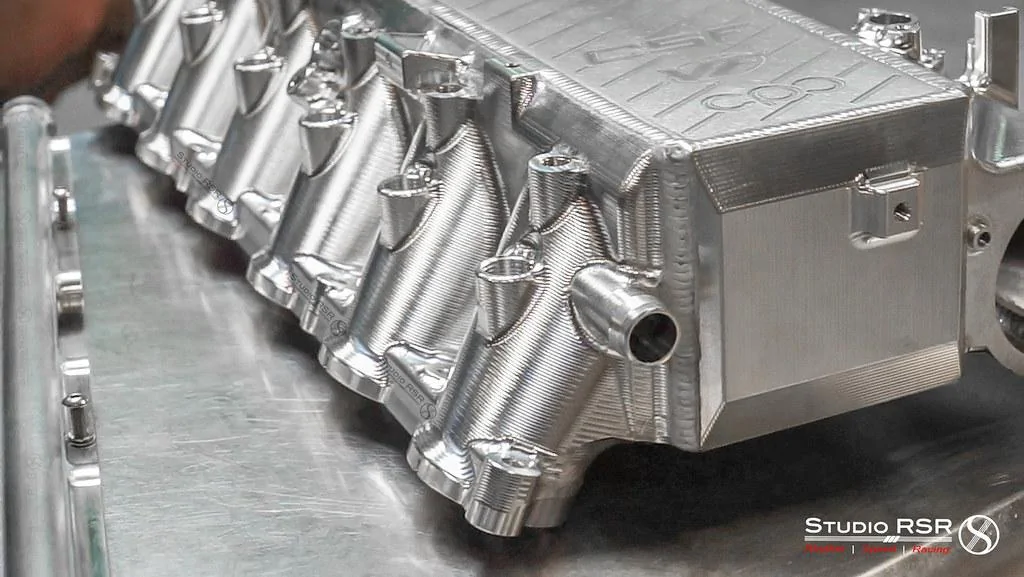

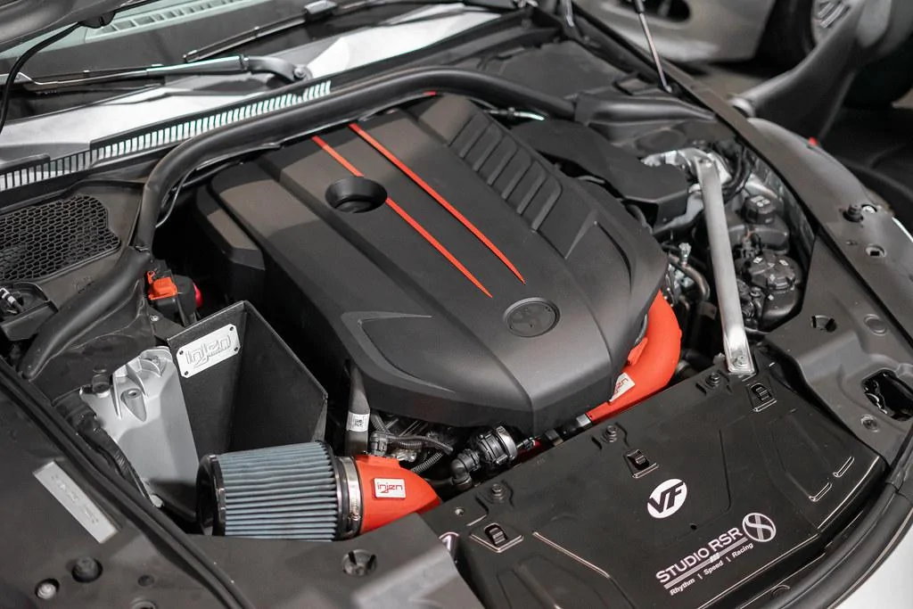

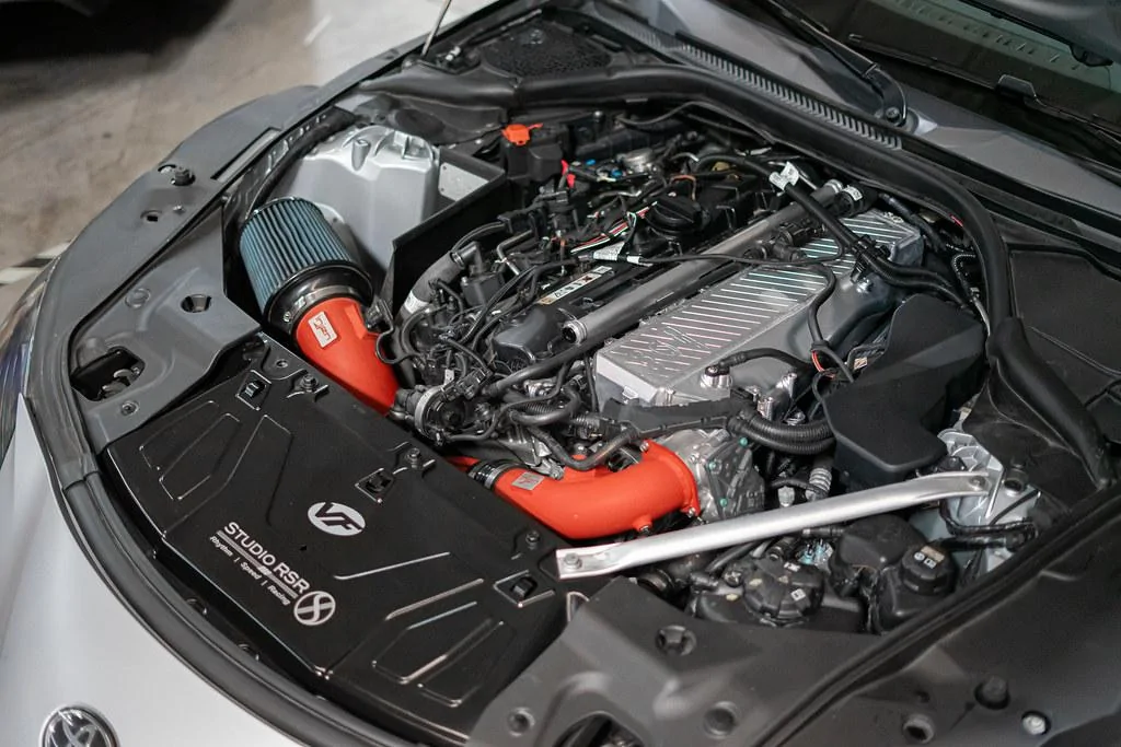

StudioRSR is proud to announce and provide the new CSF Radiators x VF-Engineering MK5 Supra Intake Manifold.

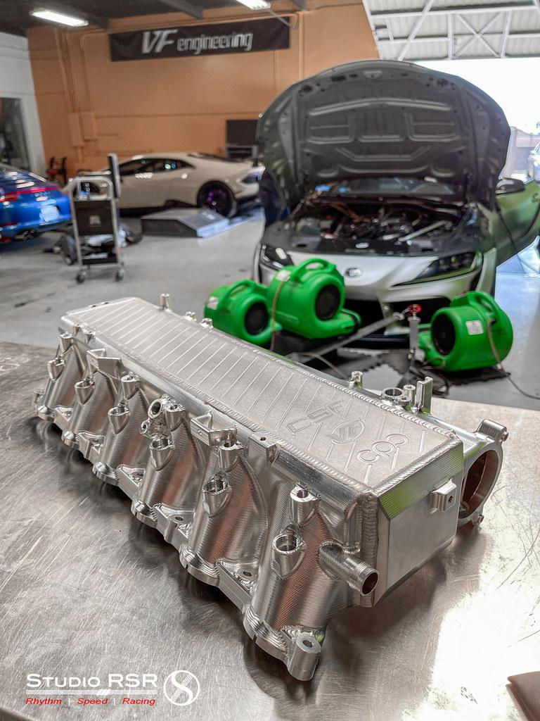

Our MK5 Supra project "Silver Speed" was used for the initial measurements, and recently, the first prototype was test-fitted and with the help of MotoIQ, validated for performance on VF-Engineering's Dynojet.
Here are some of the features of the new CSF x VF Supra manifold:
- Dual Pass / Dual Core internal heat exchanger
- Port Injection ports integrated w/fuel rail included
- 6-port NOS or Methanol injection capable
- CNC machined Billet manifold
- CFD Designed w/internal divider plate for equal distribution of airflow/cooling
- Direct OEM / Factory placement of throttle body and accessories
- Fits with factory engine cover
- For pricing, shipping and/or installation Click Here
- Package bundles with Port Injection and/or CSF's full line of A90 Supra cooling upgrades available through StudioRSR

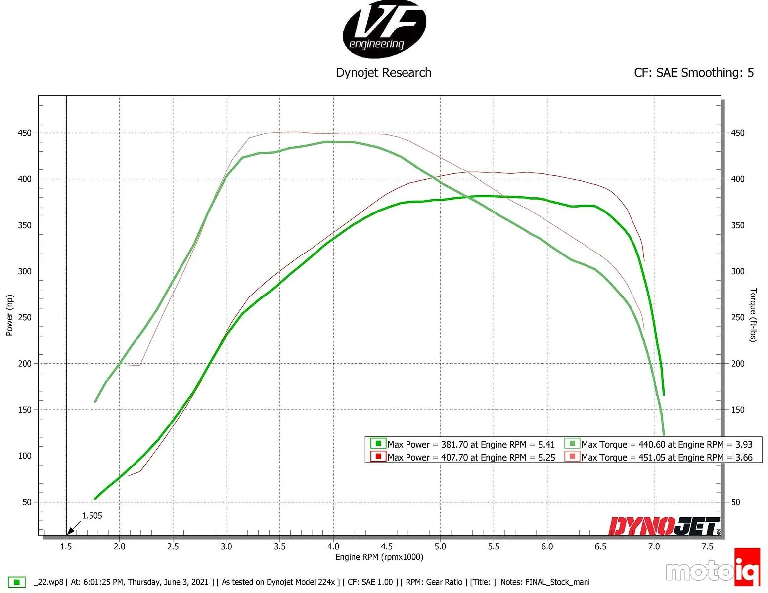

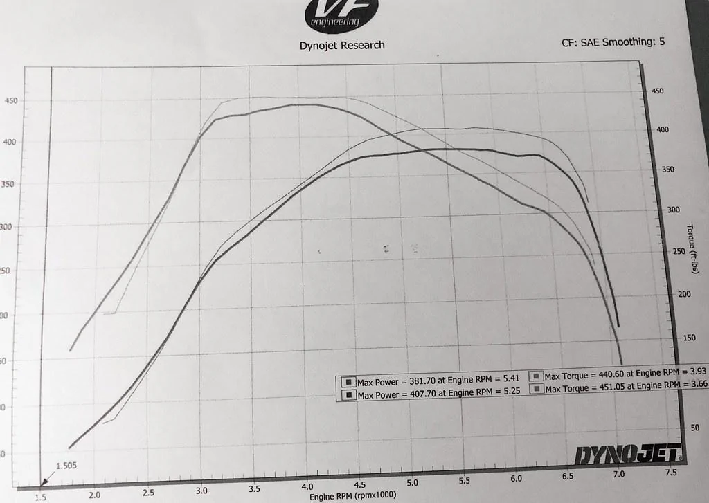

After 70+ hard, full-throttle pulls with periodic 30 second cool-down times, the manifold yielded 30 degree F cooler intake air temperatures (IATs) and a +26hp/+11wtq on a standard 91 octane "stage 2" tune. (scroll down for dyno plot)
The versatility and extreme attention to detail during the engineering and design of the manifold allows it to be installed without the need for custom tuning for MK5 Supra owners who are not yet going to be doing Port Injection and/or nos/methanol. For those with flex-fuel sensors, the manifold is designed to fit with no intrusion. For those looking to do NOS or Methanol, you no longer have to live with a single nozzle. The 6 ports on the manifold are placed for each cylinder to prevent from having to worry about even distribution. For those doing Port Injection, the fuel rail is provided with -8ORB fittings. (StudioRSR is providing packages/bundles including everything you need to run Port Injection and more...Click Here)
For added performance, CSF's dual core design means even distribution of the cooled air. The factory manifold design has the cooled water traveling across all 6 cylinders and absorbing heat along it's travel. The internal dual cores inside CSFxVF's manifold allow for the water to travel only across 3 cylinders each, leading to lower, more even air temperatures. The CFD-designed shape of the internals provides even distribution of airflow to each cylinder across the board using VF-Engineering's technical expertise to engineer and place an internal divider plate and a "speed pocket" to increase air velocity for the cylinders closest to the firewall where the external dimensions of the manifold hinder the usable space inside the manifold.
The manifold is a direct OEM replacement, retaining the factory placement of the throttle body and surrounding accessories with no re-routing of any hoses, pipes, or wiring. Additionally, the OEM engine cover still fits!

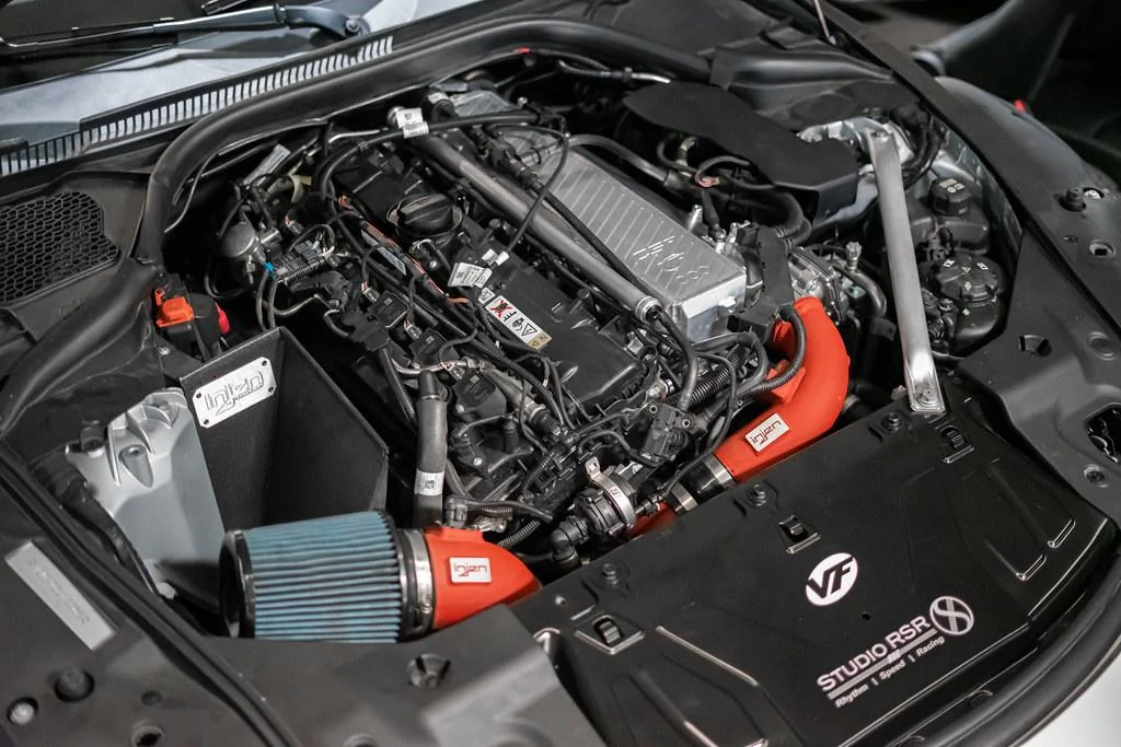

Can you still change the oil filter?
From what I've seen you do not have to remove the intake manifold in order to access the oil filter - unlike the EOS manifold currently available

Power gains are had with their intake alone (no tuning needed)
Full writeup by mtoiq:
https://motoiq.com/testing-the-csf-vf-engineering-a90-a91-supra-intake-manifold-intercooler/
Most importantly letā€™s look at the difference in power output. We had a lot of dyno data from all of the thermal saturation test runs we did. A thing to note is the CSF/VF manifold had pretty consistent power without a lot of fade due to heat saturation compared to the stock manifold which would fade considerably over many pulls. For our typical example of power increase, as shown here, we picked runs for both manifolds that were something like the 12th and 14th consecutive pulls, this is when the intake charge temperatures had stabilized. We didnā€™t cherry-pick the runs to make the CSF/VF manifold look better, just runs that were heat stabilized and middle of the pack. The manifold typically made around 26 hp and 10 lb/ft of torque more than stock.
This is with just by changing manifolds and no other changes. The power gains would have been a lot greater if the engine was tuned to take advantage of the lower charge temps and the improved compressor efficacy. If the boost was turned up and more advanced ignition timing was tolerated the gains would be much greater. We expect to see even greater gains with bigger turbos and more boost with this manifold.
