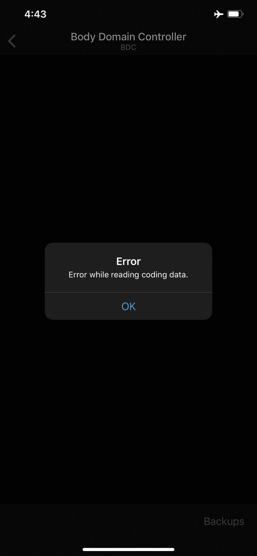

I just got an A91 and can’t access the BDC with z4 selected, assuming it has to do with the 2021s being locked out for tuning so far? I was able to change other things like chimes, auto start off, and that active sound stuff off. But can’t get to the sport mode stuff...
Are you able to access the other modules?
dhobb52
Dan
Oct 18, 2020
SLC, UT
2021 A91 Supra, 2021 TRD Venture 4Runner
ill answer for him because im experiencing the same thing. Yes we have access to everything else other than the body domain controller. Loads to 100% then gets that error message
correct

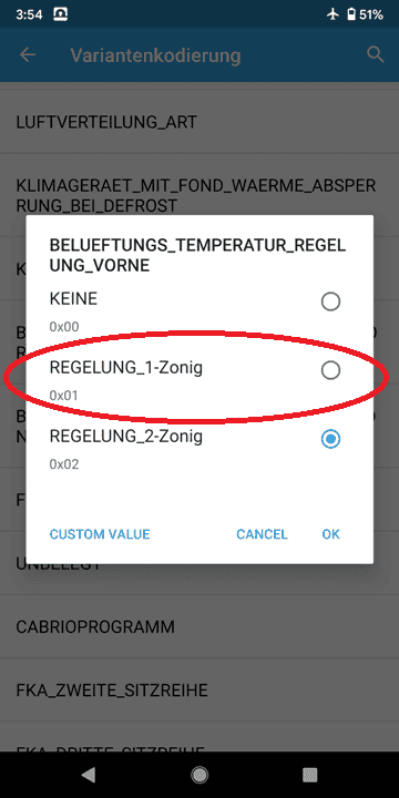

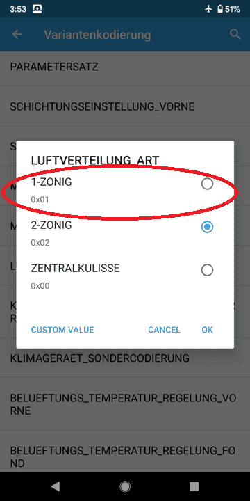

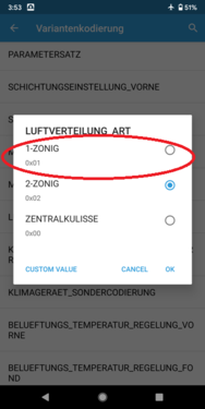

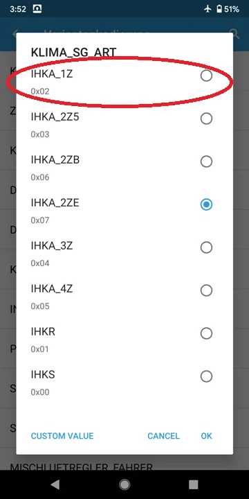

Here are the parameters that I messed with. I tried all three together and also every combination of them changing them from 2 zone (dual zone) to 1 zone.
  • klima_sg_art >> climate_sg_type
  • luftverteilung_art >> air distribution_type
  • belueftungs_temperatur_regelung_vorne >> ventilation_temperature_control_front
