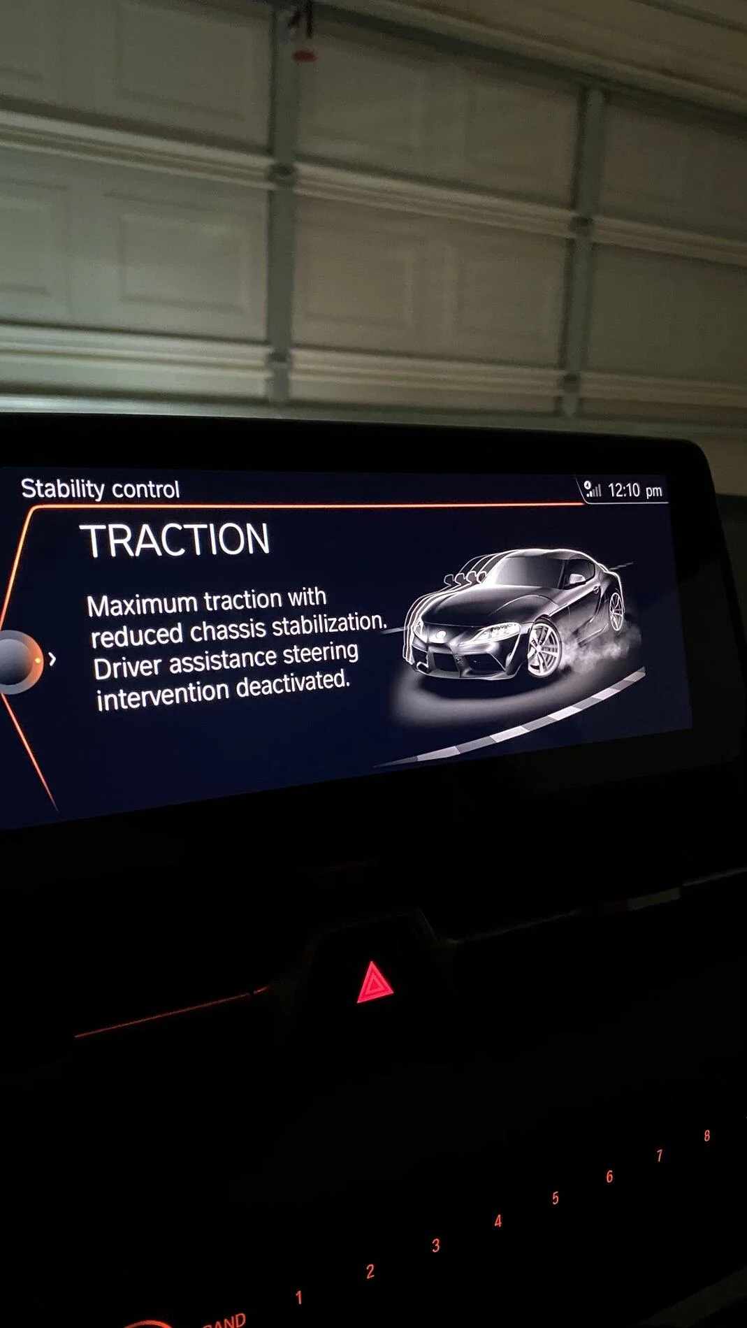

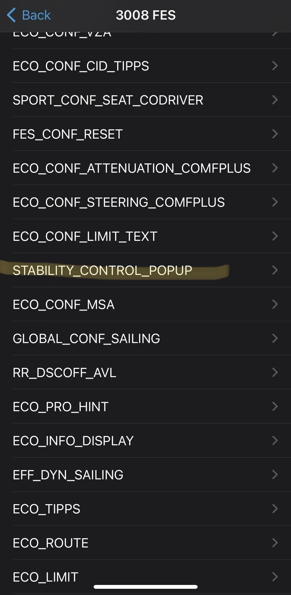

@DavesMK2JZ Here is how to remove Stability Control Popup. In Headunit, Expert Mode.
FeatureECUMenuSubMenuSetting
Remove Stability Control PopupHeadunit3008 FESSTABILITY_CONTROL_POPUPnicht_aktiv

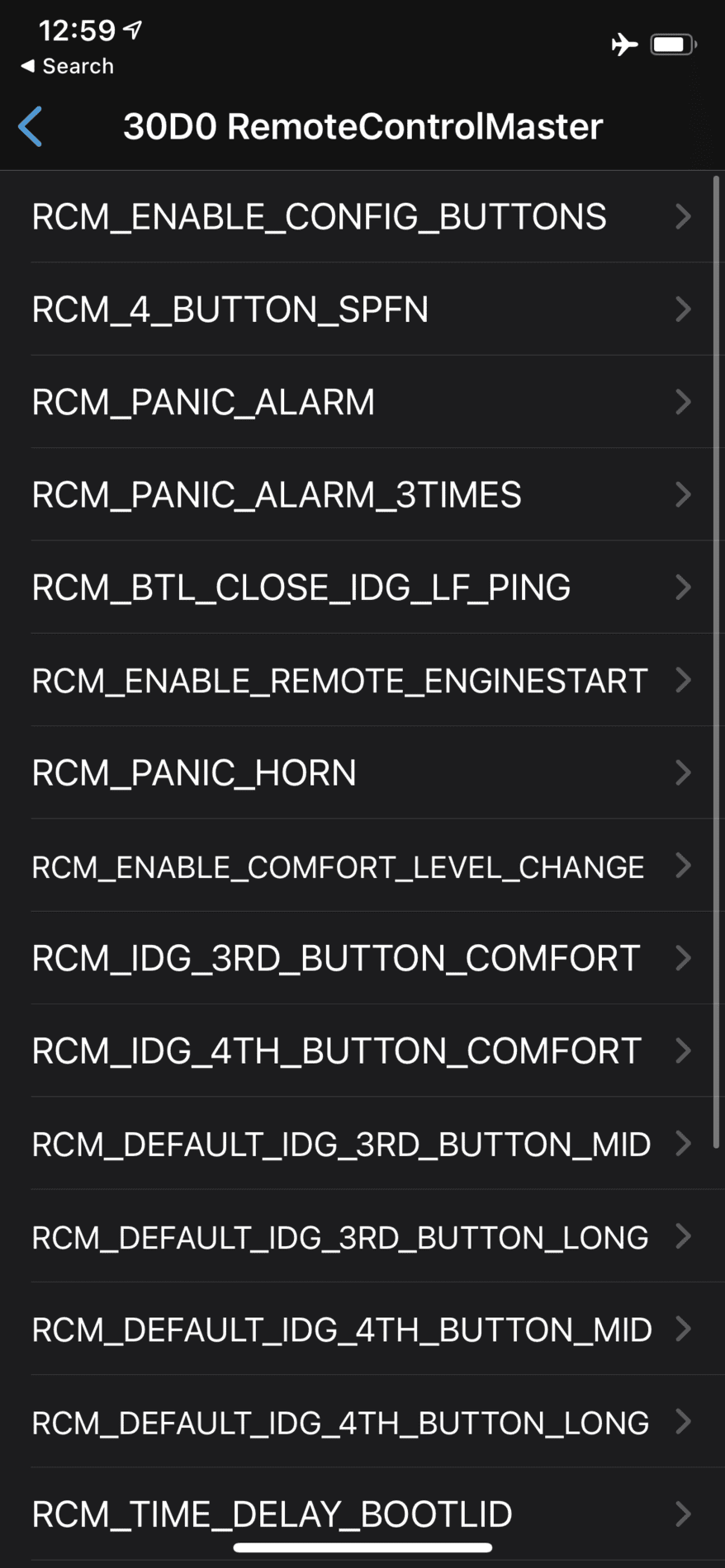

1st in BDC under Expert mode Scroll down to
30D0 RemoteControlMaster ->
RCM_Enable_Remote_Enginestart.
In that menu there are 2 options: Aktiv and Nicht Aktiv. Nicht Aktiv is selected by default.

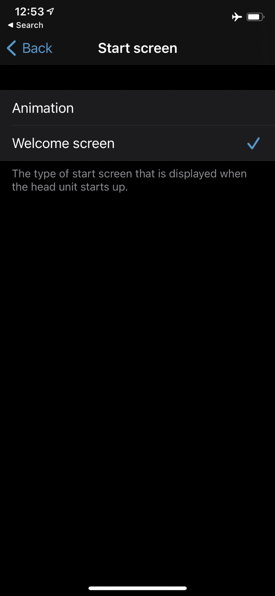

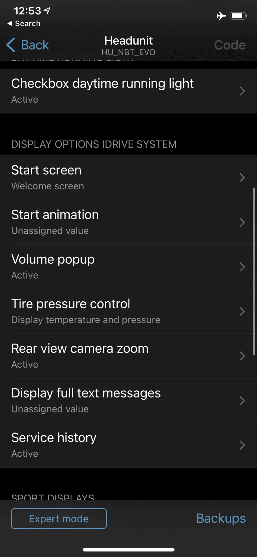

Also under head unit there are 2 options (I think they’re new)
Start Screen (Not the same as Start Animation) and Service History.
Attached are some pics of what I’m referring to. Question is who will be the one to test it out?
Potential Remote Start
Start Screen & Service Record options I was referring to.
