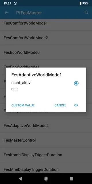

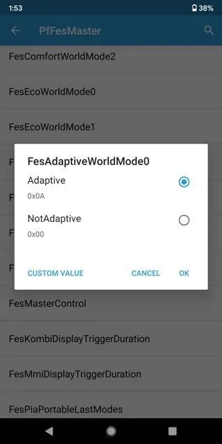

I noticed there are 3 FESAdaptiveWorldModes (0, 1, & 2). Have you activated these? I wander if it would activate the damper and steering for Sport Plus. The screen shots show that it doesn't have an option to hit aktiv.
But at the bottom of the selection you could put a custom code in. In this case code 0x01 usually means aktiv on bimmercode. I'm assuming its the steering and damper as BMW refers to those systems as Adaptive. Have you tried this or do you have any insight into what the Adaptive Setting is for?

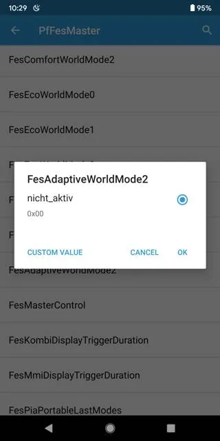

I played around with all 3 FESAdaptiveWorldModes (0, 1, & 2). I coded them with code (0x01) which usually means aktiv on bimmercode. I didn't notice any change or other features getting activated. I'm wondering if there is a second setting somewhere that might allow it to show up on the headunit to engage it. I will continue to mess around with it and see what I can find.
Now that I'm writing this, I glanced up at the earlier post and I wonder if I should have tried code (0x02) instead of (0x01). (0x01) means active but code (0x02) was the code that was used to activate the Sport Extra mode listed above. I will try that code next time and report back how it goes.
Update:
2 Days later - I tried custom coding the FESAdaptiveWorldModes with: (0x01), (0x02), and (0x0A). I could not get any of them to activate anything. So it's back to the drawing board as far as this feature goes.

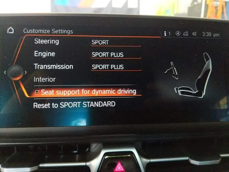

However, I did code for this and it showed up on the iDrive system. I don't remember how I found this setting so I will have to retrace my steps as I was in/out of a lot of menu/submenus.
I will test it out tomorrow and see if really works. It's supposed to enable the side bolsters to loosen/stiffen when doing dynamic driving. I'll be on the hunt for some curves tomorrow to see if I notice anything actually working or if it's just the display being shown.
Update: (next day) I went for a test drive and could not notice anything happening with the bolsters. Ideally I was expecting them to squeeze when needed. I tried several different scenarios: high speeds, curves, and combo of both. Unfortunately, nothing happened. I also went back into the coding to see if there was a submenu somewhere that probably needed to be activated too. I could not find it anywhere but I'm sure it's probably buried in there somewhere. As for now this feature still needs more testing.

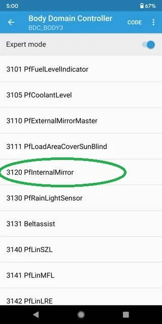

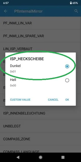

I did play around with coding to darken the mirrors at night (side and rearview). It allows you to adjust the electrostatic charge to darken the mirrors more to your personal preference. This is especially useful since the cars are low and have bright led trucks/suvs blasting into your face. It also helps out if you have tint on your windows too!
NOTE: Once you code for these you won't be able to tell a difference until you actually have a car shining its lights into the rearview mirror. But you will notice a big difference in how dark the mirrors will get.
There are 3 settings that you have to change (all are found under Expert Mode):
(1) BDC >> 3120 PfInternalMirror >>
(2) ISP_HECKSCHEIBE >> set to Dunkel
  • This tells the computer that you have tinted windows so it will be more sensitive to light that comes into the cabin and hits the rearview mirror.

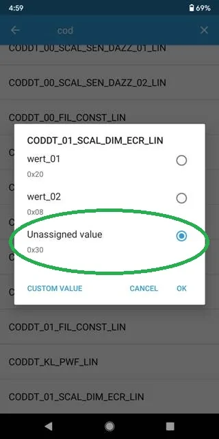

(3) CODDT_00_SCAL_DIM_ECR_LIN >> set to custom number anywhere from 20-39
  • This affects the Dim Ratio of Side-View mirrors based on sensor in Rearview Mirror
  • Max Setting = 39
  • The higher the number the darker the tint on the mirrors
  • I used 30 as my starting point and will adjust it later if needed but you will definitely tell a difference
  • (factory setting = wert_01 = 0x20)
(4) CODDT_01_SCAL_DIM_ECR_LIN >> set to custom number anywhere from 20-39
  • This adjusts the Dim Ratio of the Rearview Mirror
  • Same as above, adjust this number to your preference.

@CarGuy11 I didn't even think about decreasing the tint factor. For my purposes, I needed the mirrors darker and only focused on that. But in the settings there is a (wert-02) that came up as an option. This had a value (0x08) as you can see in the pic above. If you are wanting to decrease the tinting effect I would recommend trying this value and see how it works. I would also stay in (Hell) mode as the (Dunkel) makes the mirror more sensitive to light. So try these settings:
Tip: You can also set the side mirror a different independent value from the rearview mirror if you wanted to do that. For example, if you only wanted the side mirror to change then adjust that value to a higher/lower number. The numbers do not have to match on the 00_SCAL and 01_SCAL.
(2) ISP_HECKSCHEIBE >> leave in Hell
(3) CODDT_00_SCAL_DIM_ECR_LIN >> try Wert_02 (0x08) value
  • This will affect the side mirror tint.
  • The lighter the number should hopefully decrease the tinting affect.
(4) CODDT_01_SCAL_DIM_ECR_LIN >> try Wert_02 (0x08) value
Let us know how that works out!
