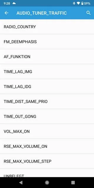

@thunderous_rs I was just looking around in demo mode to see if I could recall where I saw the settings and I think I found it for you.
Go to:
Headunit >> 3002 Audio_Tuner_Traffic
Radio_Country >> Select Australien (0x03)
Post up how this works out for you!

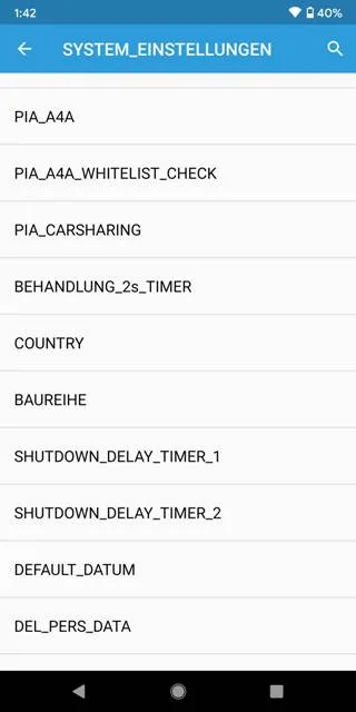

I just looked in demo mode and saw that they also had System Settings listed in there and one of the selections was for Australia. You might have to select that too to work.
Essentially, I would just go through all the menu's in Headunit/GPS and change any of them that have Australia as an option.
This one was under:
Headunit >> 3004 System_Einstellungen (means System Settings)
Country >> Australien (0x01)

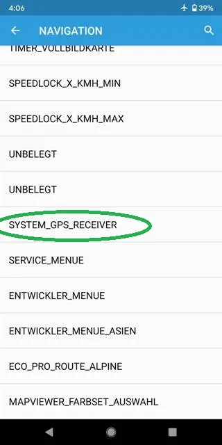

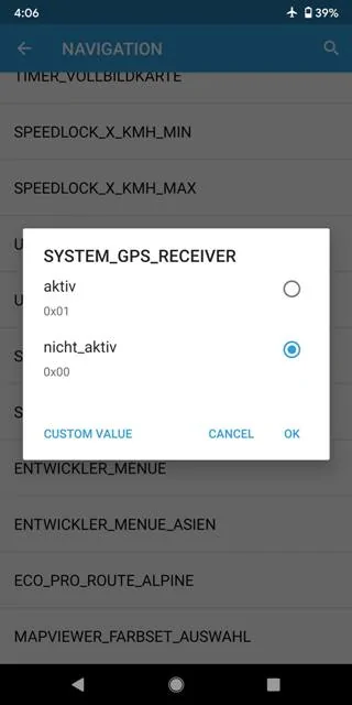

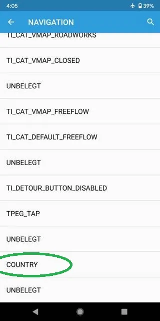

Only thing I am having a slight problem locating is the GPS protocol.
Try these (2) settings for GPS protocol. I'm not sure if they will work but it looks logical to me.
(1) Headunit >> Navigation
Country >> Select Australien (0x01)
You can maybe activate this too. It might allow the GPS to just get the date direct from the satellite.
(2) Headunit >> Navigation
System_GPS_Receiver >> Select Aktiv (0x01)
I hope this does the trick for you. Let us know how it goes.

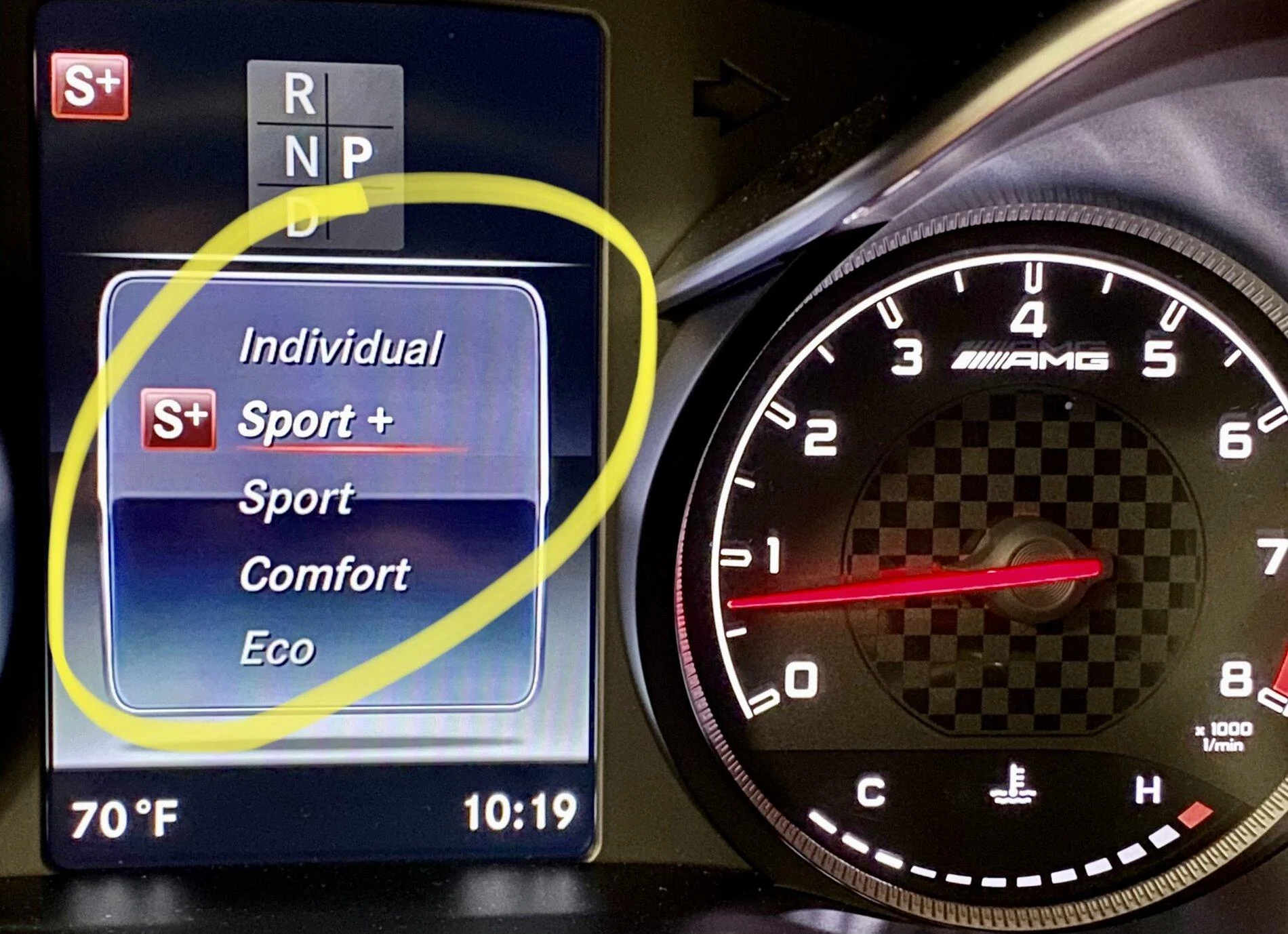

@CarGuy11 and whoever else contributed, that was a good find on the Sport+ setting! I finally got around to coding for it. I gotta say it's like putting a sprint booster on the car. The throttle is very sensitive and can be jumpy if you don't have smooth input with your foot.
~ I can select this setting on our 2018 MB GLC43 and it can become a bucking bronco if your not smooth on the accelerator. Almost overly sensitive. I run in Sport mode 99% of the time for the quick shifts, rev matching and cracking of the exhaust. A fun vehicle when room is needed for more than a party of 2.
