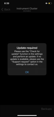

My BimmerCode app doesn’t let me select the instrument tab….. I did the update for the OBD and app but still shows gray and says to check for update or use support request… I thought I saw a way to have this fixed…. Any help is greatly appreciated….
I'm having the same problem getting to that section. It worked great in my 2021, but does NOT work on my 2022, same adapter. Possibly because my 2021 did not have the recall update?
I used a Belkin Lighting Network adapter as well as an ENET cable on both a 2020 (pre-recall) and a 2021 (post-recall). Both work fine.
I had to move to a Belkin MFi-certified adapter due to iOS 14/15 killing support for non-MFi network adapters.
Android 11 also has issues with USB-C adapters.
I know the Kiwi3 BT adapter works but doesn't give me all the options. I haven't tested it with the MX adapter.
