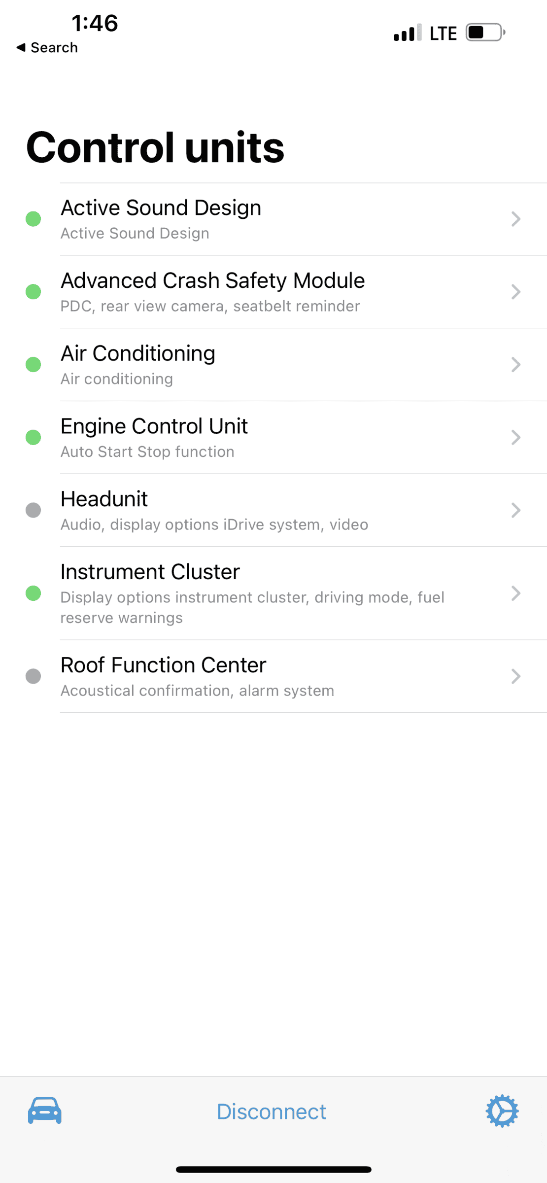

I just got a used supra and it doesn’t show the supra animation but instead bmw. Does anyone knows how i can change it back to supra without the bimmercode backups?

Unfortunately no, you will need BimmerCode to change it. Pretty crappy whoever changed it, and possibly other things, didn’t revert it to factory settings before selling it/trading it in.

lol. Just BimmerCode.

damn. i thought it can be done without their backup. wish bimmercode put the supra animation in the app :(

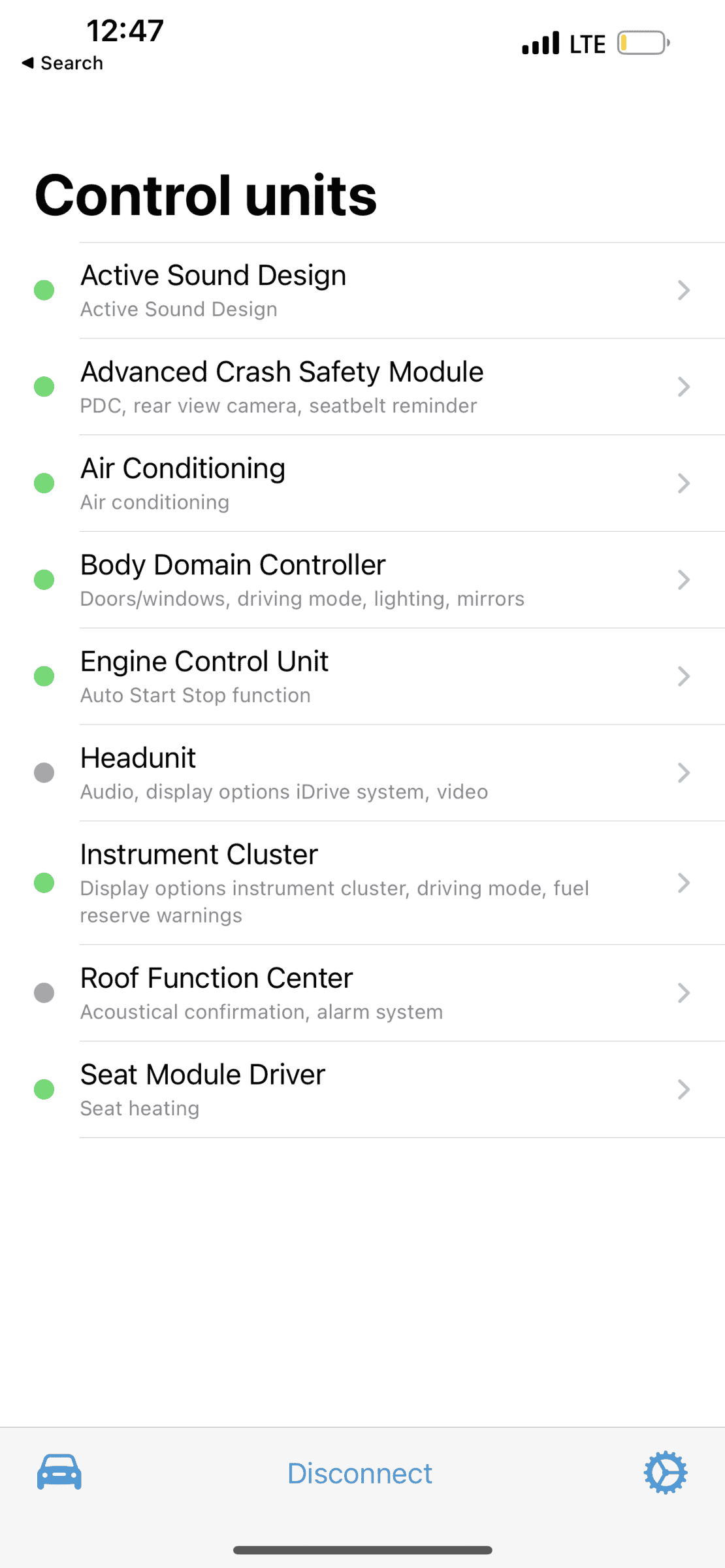

Just curious... is there any possible way that when the car start the seat goes to memory 1 and when turn off goes to memory 2? ???
Did you ever figure a way to do this? Not sure if bimmercode will let you change to a full seat retract after turning engine off. Right now i'm hitting memory 2 before I get out of the car etc.
We are missing a line of code for comfort access. I tried and researched it for a couple of days.
