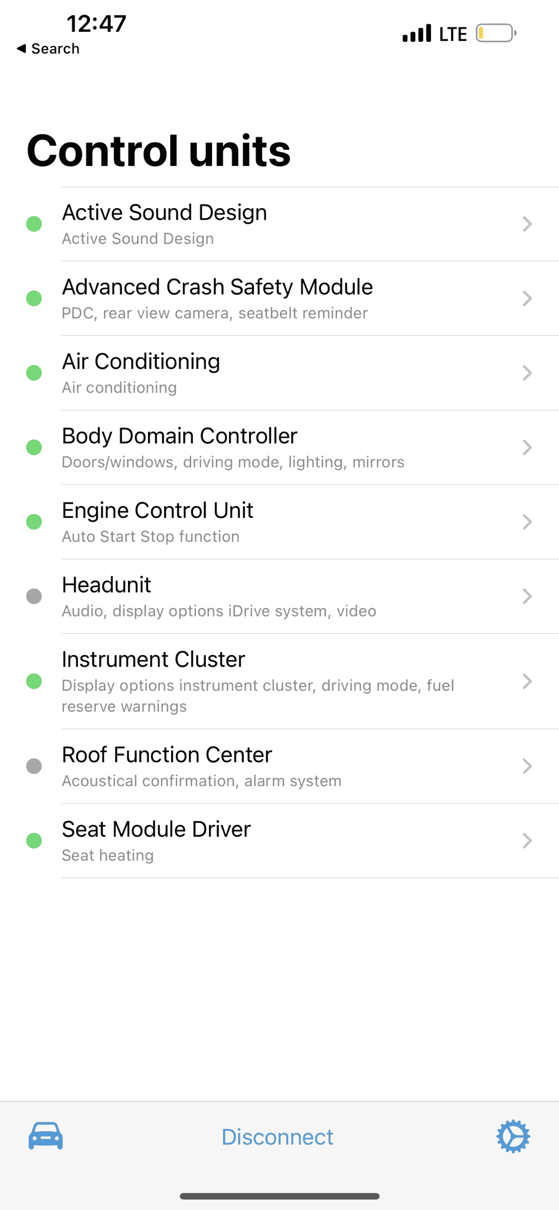

Sorry if this has been asked but I want to change the brightness of my touch screen with my Bimmercode on my 2021. In the list of ecu's, I do not have the "head unit" ecu option. The car is used and I do see Carplay is on it. I am able to make and save other changes on other ecu units. What do I need to do to be able to make the head unit ecu available? Thank you.
Did you choose Z4 and not Supra?

Got it figured out. "Ignore Headunit" was on in the settings. Thanks for the help
Did yours look like this?
