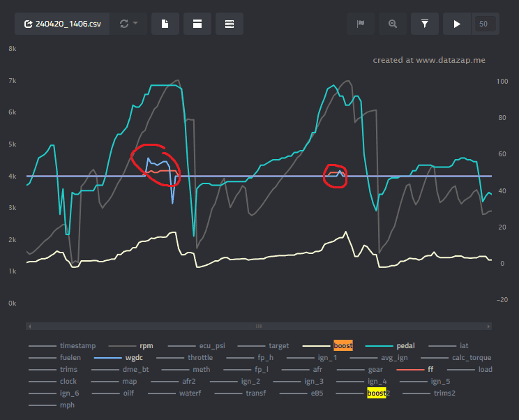

Hello, new to the forums, but had the car for almost a year now. Just got my JB4 installed a week or so ago. Can anyone please help take a look at this log, also let me know what I should be looking for here (as in good to go for the next map), in my eyes it seems fine. This is map 1, everything is stock on the car except intake (MST). Thanks!
https://datazap.me/u/josa90/map1intake?log=0&data=1-2-3-4-8-9-15-20
EDIT: I am running 93 atm.
i3igpete
May 16, 2022
46
1,306
1,574
Chicago
2023 3.0L 8AT
For most of the first pull, and pretty much all of the second pull, your jb4 isn't even activating wastegate control because your foot isn't all the way down. If FF and WGDC are flat lines at 50 - it's not doing anything.
Because of this, your boost curve is pretty much line-on-line with dme_bt (the ECU's boost target). The JB4 is basically not adding any boost. The second pull here is deceiving - it looks like it's adding boost, but the throttle is mostly closed. and therefore boost2 (what's actually in the intake manifold) is still tracking dme_bt.
try a pull from 3k or below all the way to redline, in 3rd or 4th gear. foot all the way down, include a shift if you'd like.
Thanks, I'll try that, need to find a nice road out in the boonies for this, so I'll see if I can better logs tomorrow.

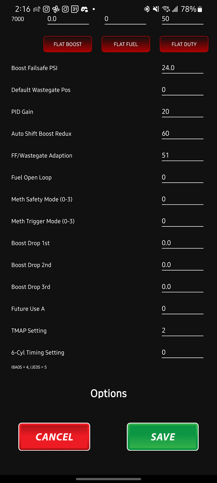

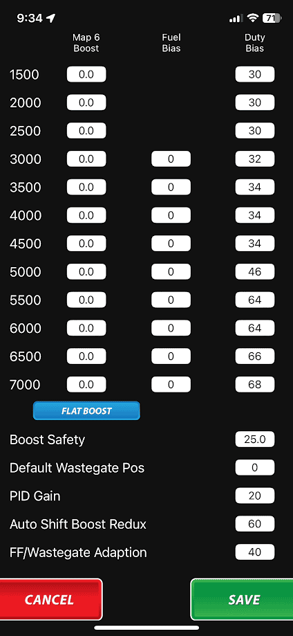

Stick with Map 2, but drop FF to 40 and try out these duty settings that I run (also catless)
duty_15duty_20duty_25duty_30duty_35duty_40duty_45duty_50duty_55duty_60duty_65duty_70
30​
30​
30​
32​
34​
34​
34​
46​
64​
64​
66​
68​
Few Map 2 logs with above adjustments (screenshot below). Felt even better and much more dialed in like stock/pre DP - thank you!

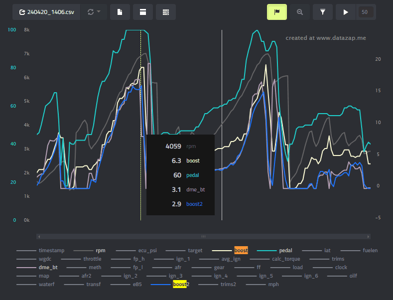

Well, I got a couple more logs here, let me know if these are any better.
https://datazap.me/u/josa90/map1intake01?log=0&data=1-4-5-15-34
https://datazap.me/u/josa90/map1intake02?log=0&data=1-4-5-15-34

its not bad, but car is wanting to run a lot of boost, hurting timing a bit. Want to try out Map 4? Some cars prefer absolute mode.
Remember to set FF to 40 after switching maps.
