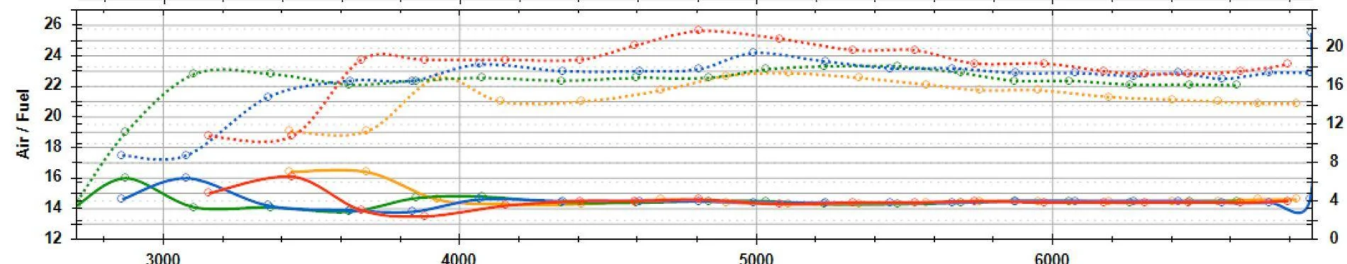

Here is the latest log with the latest settings you listed.
https://datazap.me/u/sterrace/map6-rev2?log=0&data=1-3-4-6-20
So I noticed that the boost level fluctuates between pulls, 1-4 psi at the same RPM, is that the JB4 doing that or is that just inherent with the supra platform?

So this seems weird. I had to disconnect the JB4 as I had to bring the car into the dealer for them to finally activate the map navigation. So I reinstalled the JB4 and went to do drive it around and do some pulls with the latest map6. Doesn't this look to be boosting high? Is there weirdness that happens when disconnecting a JB4 and then reconnecting it a day later? Does anything have to be reset? I disconnected the battery for a few just in case lol. I didnt do a full pull to redline as it just felt weird as I was doing the pulls. The timing seems to be very low too. At the end is Map0 pulls, that boost seems high too?
https://datazap.me/u/sterrace/9-19-24?log=0&data=1-4
yeah its a bit high, try at FF 40 next

It seems to be happy now. Not sure what was up with that crazyness earlier. So along with FF at 40 I mixed in some E85.. Prob a mix of E22 or so now. The timing is much happier for sure. The trims though are hitting low 40s 3200-4500 rpm or so. AFRs seem OK.
https://datazap.me/u/sterrace/e22-fuel?log=0&data=1-4-8-14-18-20
Yeah all the pulls look great.
you can try turning up the boost some on map 6 now that you have ethanol

Awesome, I will update the boost. At what point do I have to worry about the trims? if they stay in the 40s for how long?
Try to keep trims under 45. If it is 45+ for multiple datapoints, you are not leaving yourself enough headroom.
