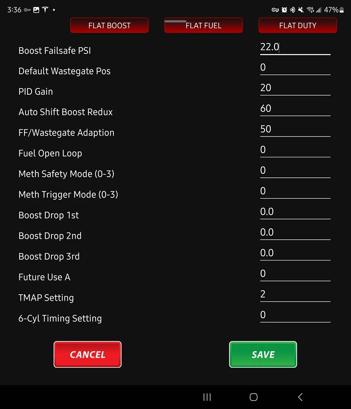

So if you lower FF on the adjustment setting and leave duty bias at 50 it’ll open the wastegate a bit more thru all the RPM band to let boost build essentially slower and hopefully not hit max boost causing a throttle closer?
or another way to say it is if I’m getting throttle closers when hitting high boost should I lower duty bias by RPM or lower FF on the other setting
Yes to both!
Adjust duty bias if it is only throttle closures in a specific RPM area, or FF if the whole RPM curve has throttle closures.
Different downpipes need different FF/duty curves, as the one standard on the JB4 is for stock dp.
