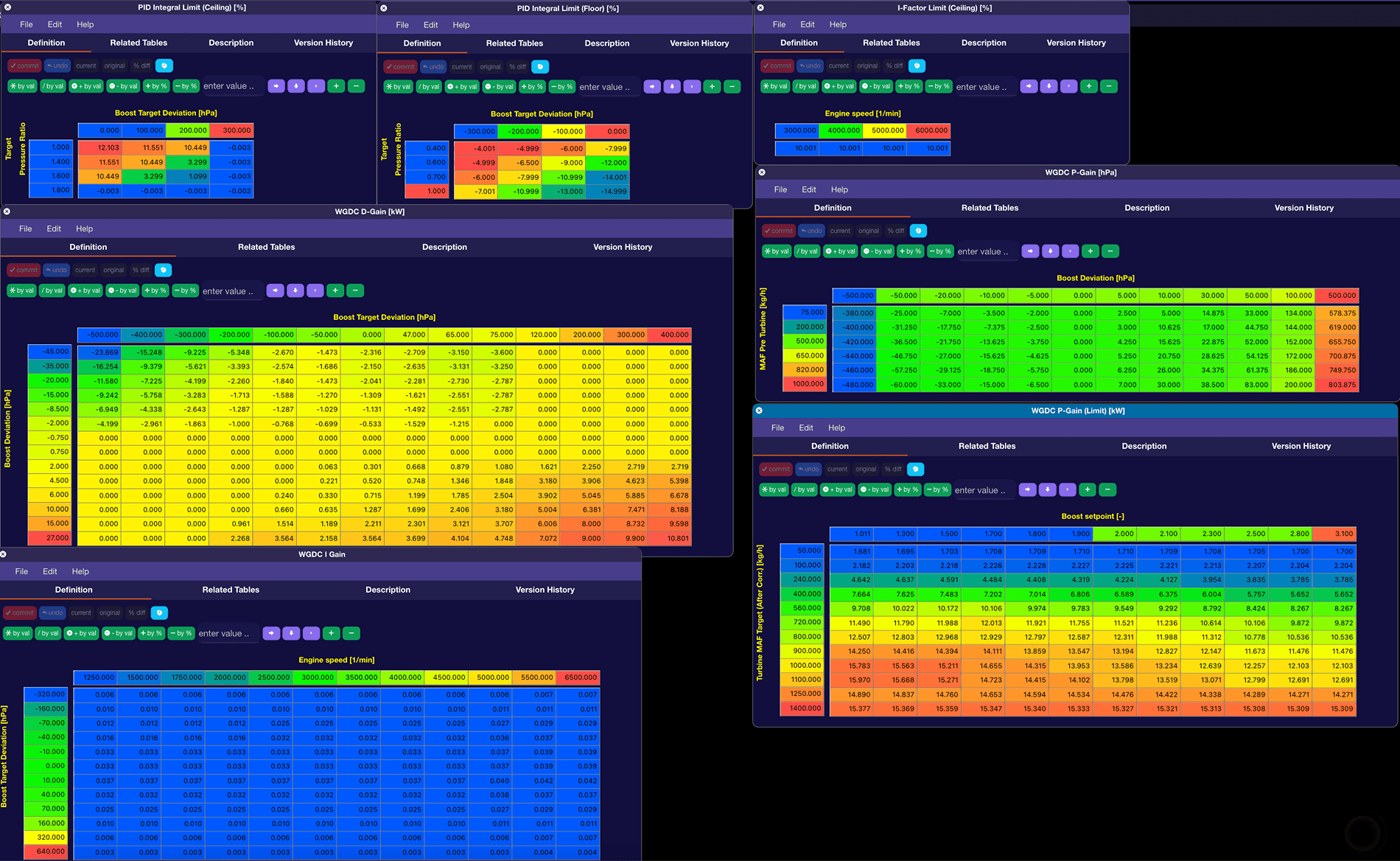

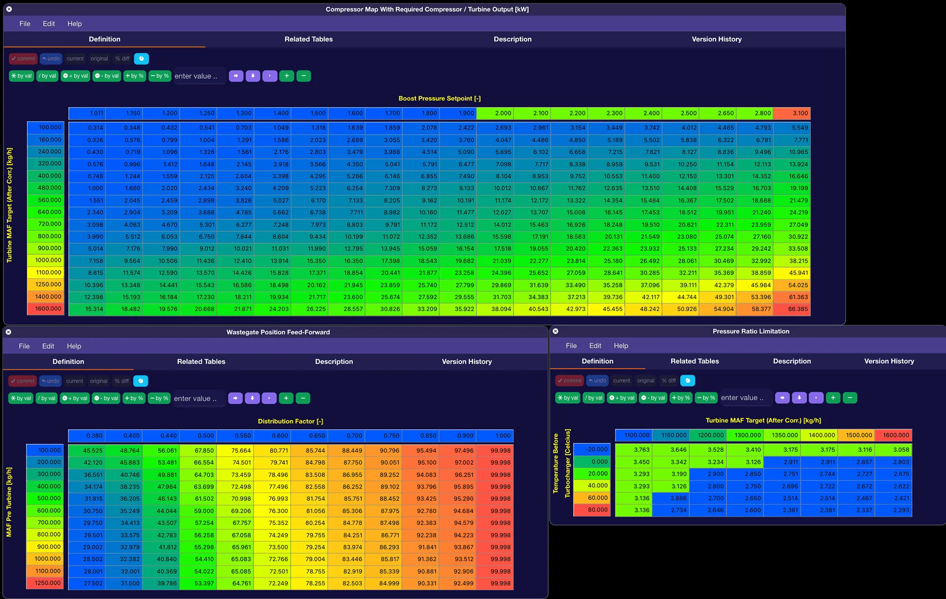

Yea, and your are probably fighting the boost PID control the whole time.
WGDC with the oem strategy is based on the Compressor table, which changes the distribution factor, which changes what cells the DME follows in the Feed-Forward table, then the PID control enters the room based on boost target +/-, which is derived from torque/load and Boost Setpoint via the Pressure Ratio tables. The P-Gain can change the Compressor table dynamically as well and is one of the faster PID controllers.

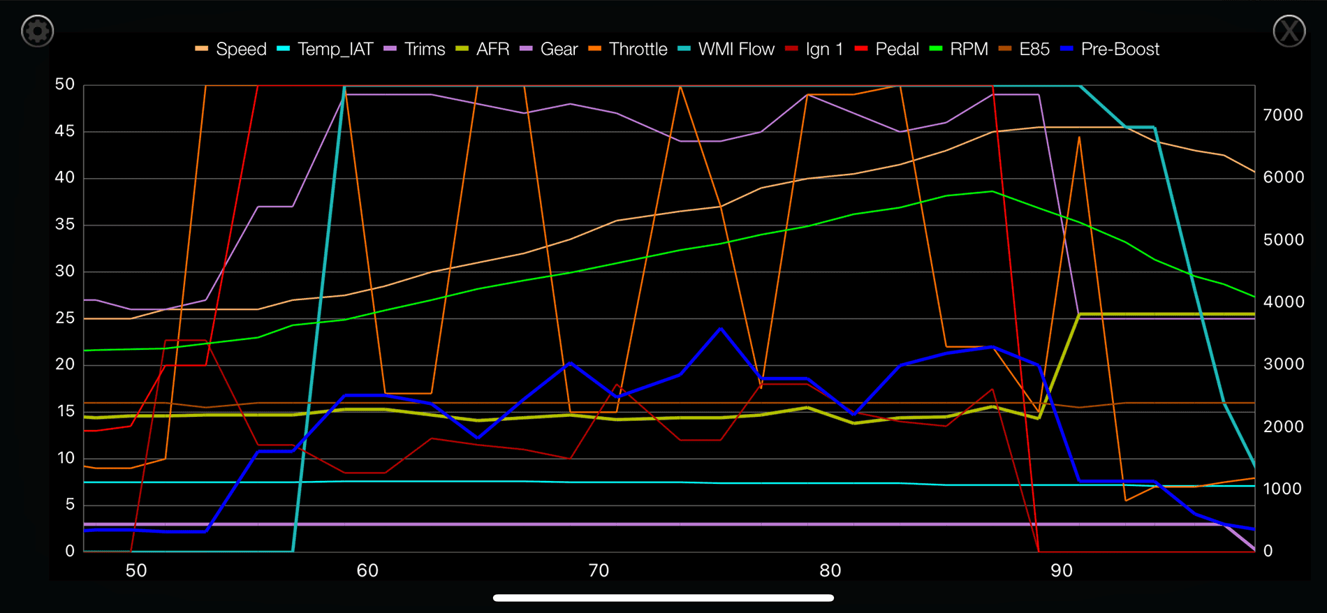

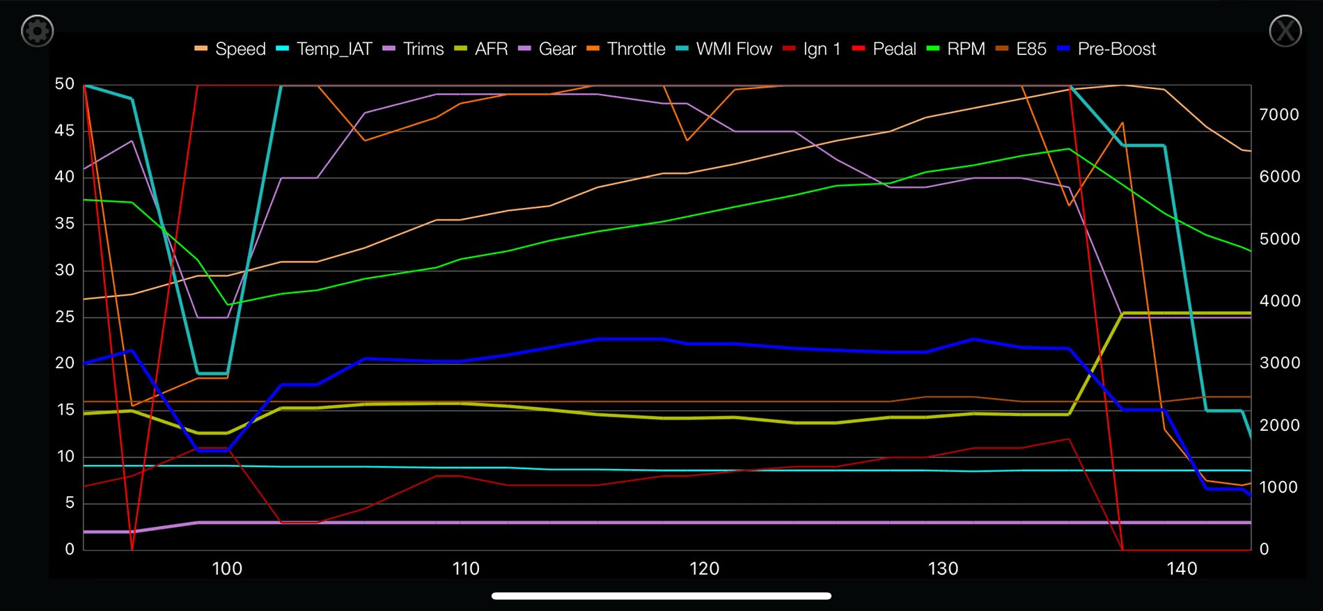

can anyone explain why my trims are at 49 if i roll into 3rd gear but as soon as i hard shift 4th it will drop into the 30s BUT when i start in 2nd and hard shift into 3rd my trims in 3rd look great and are usually low 40s? It seems that it is fairly consistent with doing it when the throttle chopping occurs and it typically only happens in whatever gear i first start the pull in.
Posting a log would help :)
It sounds like maybe you are on an absolute map? I find the additive ones are more consistent on trims.

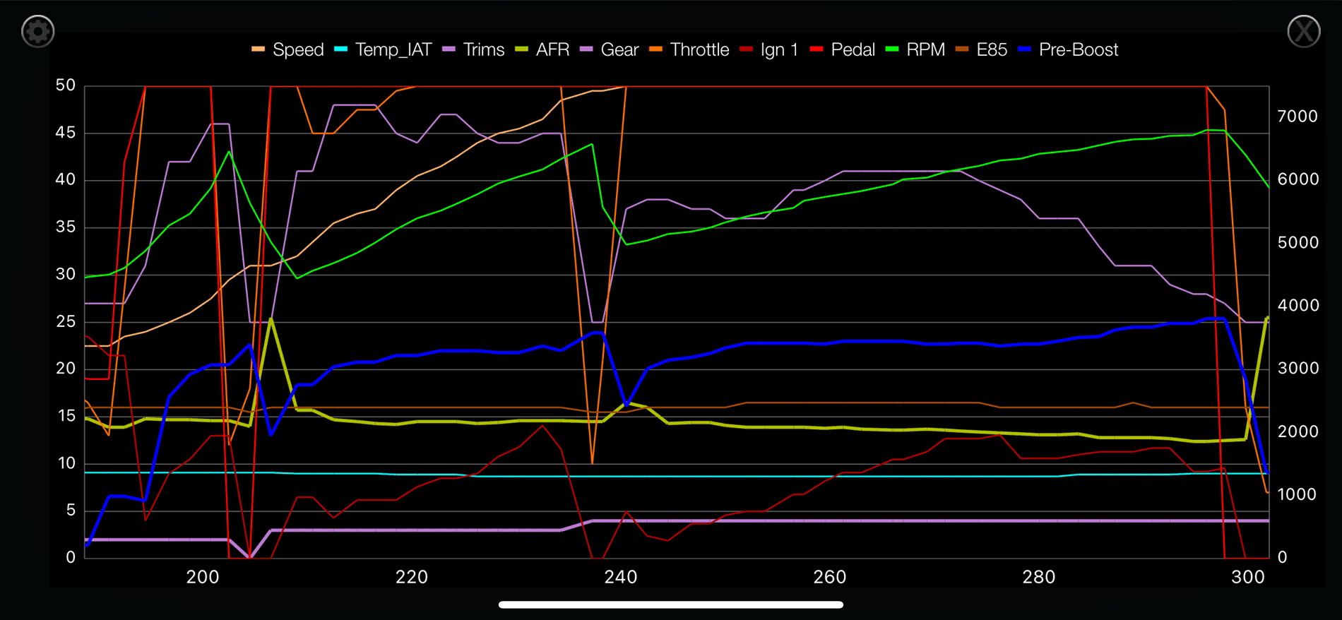

Follow-up for @Dven11 's car - we did a few more iterations in PMs, here's where we ended up (final pull specifically):
https://datazap.me/u/coloneladama/l...ata=1-2-4-8-11-20-25-26-27-28-29&zoom=304-334
Definitely a bumpy road/traction issues but pulling super strong on this 91/E30 mix! You can see the V24 firmware WGDC updates working nicely on this catless car.
Take a note at the RPM range where the high trims are occurring in the first pull. Does your second log have 3rd gear in that same RPM range?
here is one that I did
with a hard shift from 2-3
here is one rolling into it in 3rd
and here is a 60-130 pull starting in 2nd
