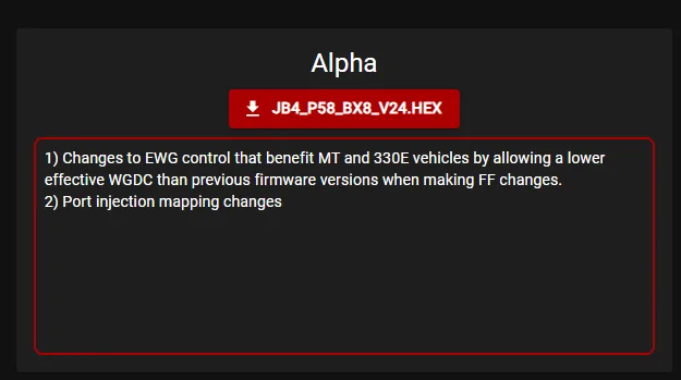

Great news to share!
Many of you have heard about the "MT/330e V24 firmware" that I've recommended for a while. I worked with Terry at BMS for several months to identify the aspects of the V22/23 firmware that were incompatible with MT cars, and also found that it helped significantly with dozens of AT cars as well.
Essentially the only changes are :
  • "increased range of WGDC", previously capped at a 29 minimum. Now it is full range. 0-100.
  • JB4 WGDC control active during spool, previously not active.
This is especially helpful for catless/hi flow dp cars, and anyone else who struggles with throttle closures despite any WGDC tweaking. I also found it to be helpful with LCI M340s/M240s/etc.
Anyway, today it has been officially released at Alpha for V24 and is available for anyone to upgrade to in their app. Very happy to have been a part in testing, solving this issue, and bringing it to official release.
https://dev.jb4connectkit.com/client/firmware/?platform=58
