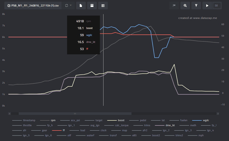

Any time WGDC is offset by 5 or more from the FF curve, that is a region where you should adjust duty bias, since the PID control can only +/- ~8. That is why you're barely boosting over stock.

keep going, here's the diff between wgdc and ff for both pulls:
Draw a line through the middle of those two curves, and add it to your last duty bias curve. Note that if the JB4 isn't doing anything (during part throttle or spool up) then both curves just report 50.
Not a coincidence that it's starting to look like the table in adam's first post ;)

The tricky part of this WGDC tuning is that, unfortunately, there is usually more to it than syncing up the FF/WGDC curves.
Remember that the B58 is torque targeting, so when FF is too high, sometimes the car will just take the extra boost, consider it as cylinder overfill and reduce timing to stay under the torque target. Its not ideal running conditions and can overstress the turbo and just blow hot air. I have seen cars on Map 1 running 23 psi with horrible timing on 93 octane.
more info: https://ecutek.atlassian.net/wiki/spaces/SUPPORT/pages/170557464/B58+Tuning+Guide
So the best way to mitigate this, imo, is do a Map 0 log and figure out what ecu_psi /dme_bt range the car wants to run at. Your goal with JB4 is to adjust FF and duty so that ecu_psi / dme_bt curves look as similar to the Map 0 log as possible.
ecu_psi is ideally 1 psi below dme_bt (any closer is throttle closures)
dme_bt should usually be in the 12-17psi range depending on conditions. (cylinder fill ~100%, or whatever cylinder fill desired is)
This is a B48, but is demonstrating exactly what I mean. 23.5 psi on Map 1. No timing. But the boost control and WGDC stuff would appear to be a good fit right? I would start dropping FF on this car, and you'll find that dme_bt will drop too.
https://datazap.me/u/coloneladama/log-1724333400?log=0&data=1-2-3-4-8-11-15-20&zoom=61-144

Regarding the last log, I would argue that cause and effect might be getting mixed up. If knock is detected during the spool up phase, then that would disable ignition advance because combustion is already unpredictable. (The DME can't differentiate between pre-ignition or detonation, so it just avoids timing advance either way.)
The DME goes for increased boost because that's the only knob it has left to meet the torque target.
That's a viable theory. Notice there are 2 logs in my link. The second is with an E blend and no improvement whatsoever with timing. I think it is because cylinder fill % is just too high.
