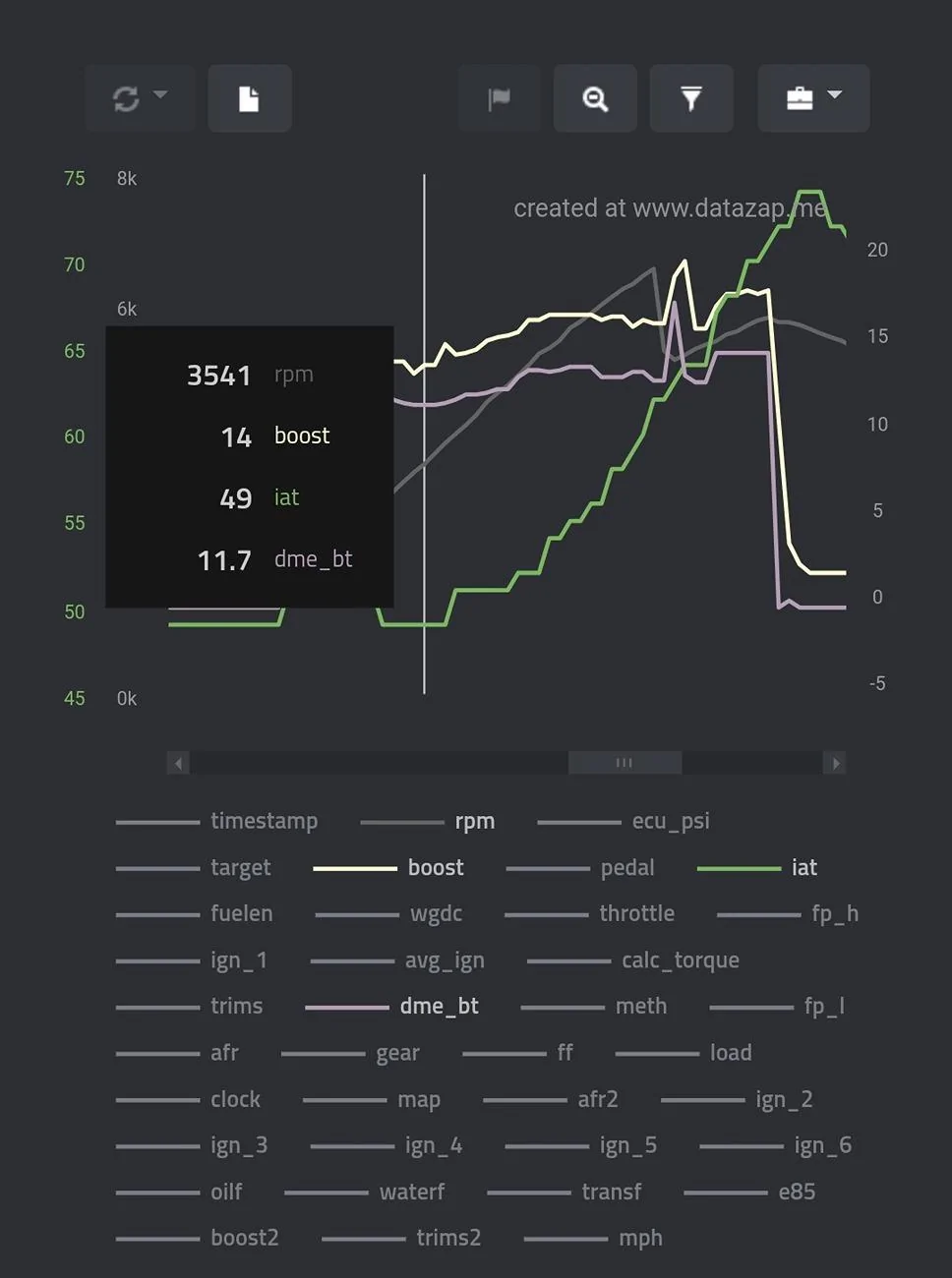

i3igpete
May 16, 2022
48
1,325
1,623
Chicago
2023 3.0L 8AT
It depends on IATs, but yeah under 100 IAT, my car will read ecu_psi as 11-13.
can confirm, here's a log from over the winter. dme_bt targets are in the low teens and peaks in the ~13 psi range when iats are low. makes sense, if knock is unlikely, the dme will meet the requested torque with more timing and less boost to optimize fuel economy.

8,776
17,216
For the future, I know some “tuning guides” state that the DME uses timing to meet requested torque when IAT’s are lower but that actually isn’t 100% true. In stock tune trim, the ignition maps are pretty aggressive and so is the IAT timing reduction. So when the IAT’s are cooler it basically uses way less IAT timing reduction. It’s not actually calculating more timing to meet the torque request, it’s just using less timing reduction.
However, boost does change depending on temperature as it has temp and baro compensation.
So when the DME is tuned, depending on the way the tuner sets the ignition tables, you see much less timing difference, if at all, in different temps.
