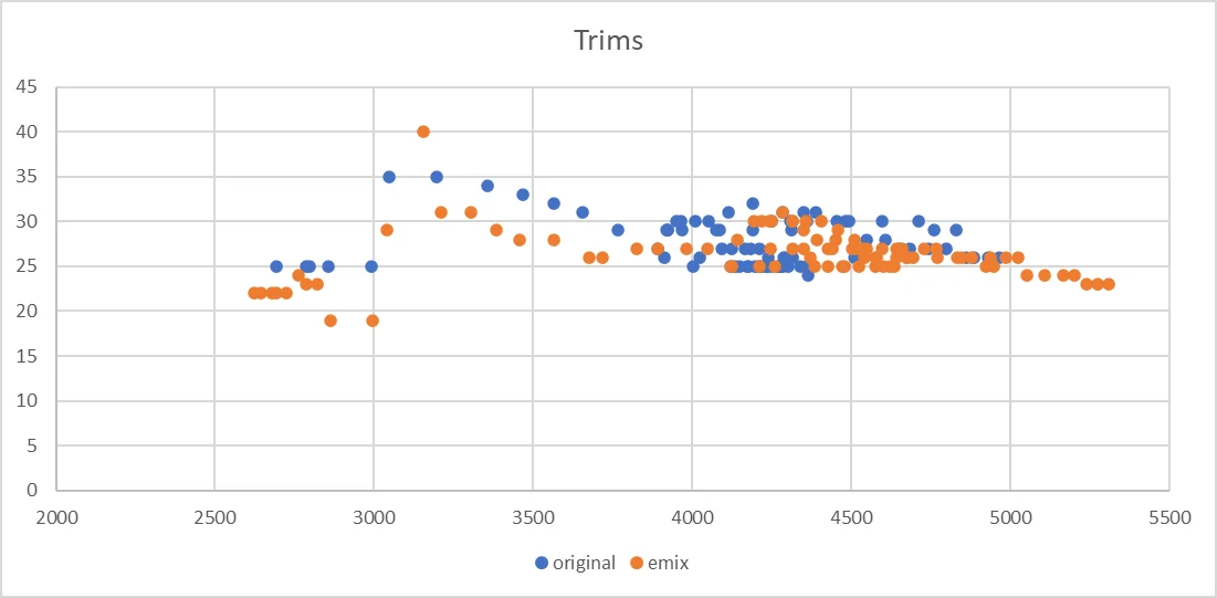

It doesn't look like they mixed very much E85 in, here's how the trims look across both pulls:

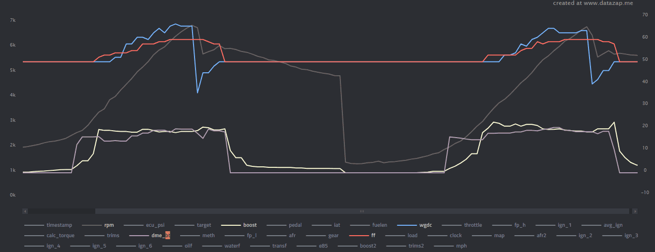

keep going, here's the diff between wgdc and ff for both pulls:
Draw a line through the middle of those two curves, and add it to your last duty bias curve. Note that if the JB4 isn't doing anything (during part throttle or spool up) then both curves just report 50.
Not a coincidence that it's starting to look like the table in adam's first post ;)
duty_15duty_20duty_25duty_30duty_35duty_40duty_45duty_50duty_55duty_60duty_65duty_70
old505050505050505050505050
new505050505050525555575757
new2474747474750565961616363
323232323536394855576262
FF= 35~40 ballpark ;) But its good to see the process as a demonstration
catless and hi flow dp cars have a big drop off of duty under 5k typically.
I initially did plug in the settings from the first page to see how the car would feel. I then decided against it in case something went wrong lol But I do see the process and how we are getting there. I will try new2 and report back.
This person typically mixed 2 gallons in, but I will confirm that its the same with this tank of fuel. 91 with 2 gal E should not have knock/pre-ignition issues on Map 1.
The higher ecu_psi is, the less trims change with added boost or ethanol. Presumably because the fuel tables are more generous at higher boost levels. lower lambda/etc.
+4 psi additive on a car running ecu_psi of 12 psi is going to have dramatically higher trims than +4 psi additive on a car running ecu_psi of 16 psi. JB4 would be spoofing 25% of total boost compared to 33% on the lower boost car.

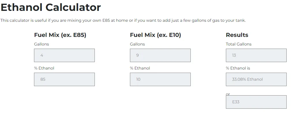

I remember mixing 4.2 gallons of E (I wasn't paying attention I usually do 3 max) and the rest with 91 but my fuel-it app was only reading E32 kinda weird no?

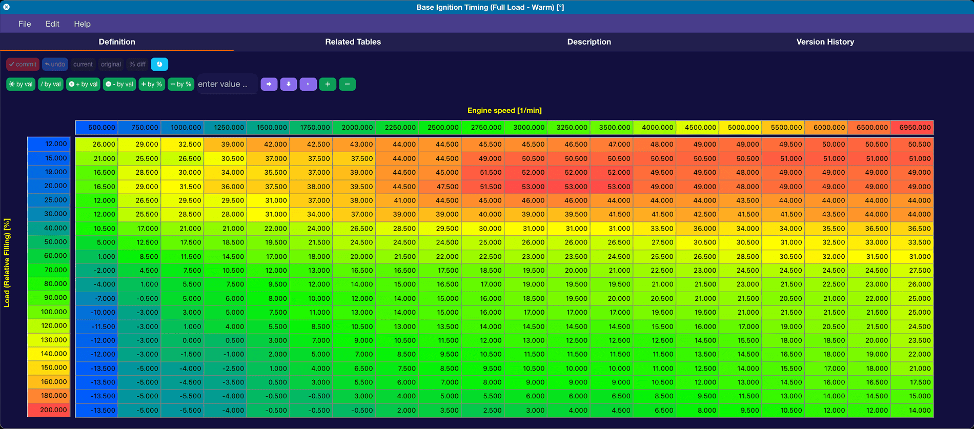

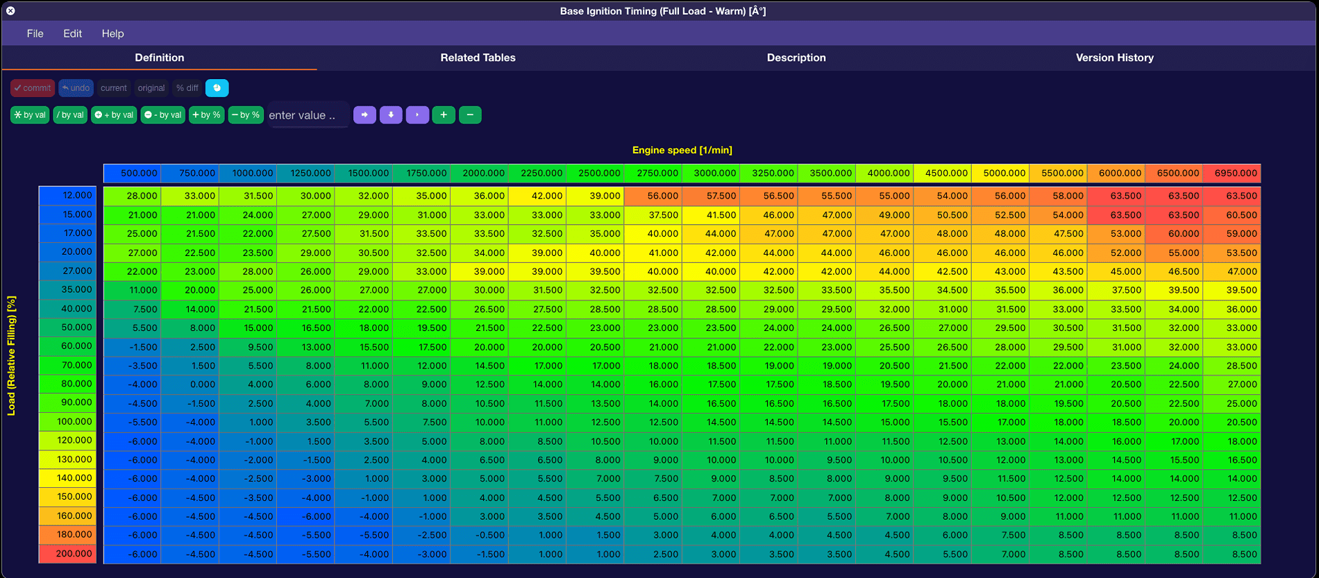

Here are the ignition timing maps for 2020 and 2021+ for reference. I figure at the least this will help to see how much ignition retard you might be seeing.
2020:
2021+:
2020:
2021+:
Thanks for sharing. I have seen these tables on the ecutek guide I shared earlier.
To me, it still looks like base timing drops as relative filling % goes up. That is just cylinder fill right? And cylinder fill % is directly correlated to boost, and in the case of the JB4, that is ecu_psi. So I feel like the logic I presented still holds?
I know there are other timing reduction tables, primarily the IAT/coolant temp one, so it makes sense to me that a car will run little to no timing at all if IATs are high and the cylinder fill% is too high. Even if its not an octane issue.

What you are seeing is a combo of preemptive knock control and the reduction tables working. The OEM timing is pretty aggressive and even more so when you start adding additional boost. Remember the car is calibrated to run in all different environments, who knows what kind of fuel quality, driving style, etc
When you tune the car with a timing table that makes more sense for a more controlled environment. Example, knowing you will have E40 in all the time, knowing you are beating the hell out of the car on track as it's main purpose, etc, you will see that the ignition timing is pretty consistent to the tables, unless the reduction tables come into effect.
I have purposely set fill target very very high to see the affect and the car will not add timing above the base ignition, it will however push the boost PID hard to add boost to hit that target. Unless you pull PID down.
Fun fact when doing this, if you set the torque target super high, the throttle gets very very twitchy, since the throttle tables are mapped to the torque request, it tries to hit that torque request and the throttle snaps open. It feels great. ;)
One thing to note is some tuning guides are taking Gen 1 B58 tuning into account as well and some of the Gen 1 vs Gen 2 DME strategies are different.
