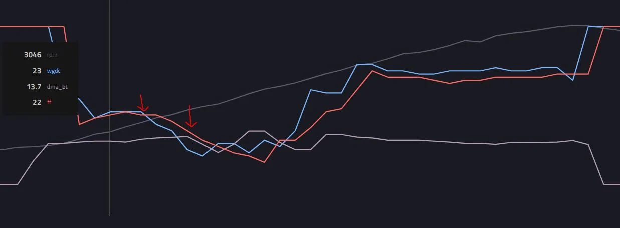

Cool news coming soon again. Terry and I (and @RyanA90 ) have been busy developing an actual "MT mode" this week. It is activated by setting autoshift boost redux to 0, since that feature is not used on MT cars. Unreleased firmware only right now.
A fundamental function of the JB4's EWG connection is the boost PID. Allows JB4 to directly control boost levels, rather than spoof the sensor and let the car raise WGDC/boost.
As a refresher:
  • PID Output = boost_error (boost vs. boost target) * Internal Mapping * PID Gain (see wastegate tuning)
  • WGDC = FF + PID Output
So you can figure PID output = WGDC - FF.
The PID boost target for MT mode is 80% of DME boost target, rather than the ~95% it is for AT cars. This achieves the "underboosting" that MTs have needed but with the JB4 PID actually working with us, rather than against us (by pushing boost too high and causing MT stutters)
There is no "underboosting" method for MTs after this is finished, since it will already be built in to the JB4's MT mode.
You will attempt to fit the FF curve to the duty curve just like any other wastegate control JB4 car:
https://www.jb4tech.com/forum/model...g-review-ab/4229-jb4-duty-bias-ff-tuning-info
Confusing, but there will be results (and hopefully the new firmware available) soon.
*pic: new firmware, PID response goes negative when the underboost margin is reduced (arrow 1). PID can't correct enough, dme_bt drops and boost stutters (arrow 2)*
More work to do here, but already I can tell it makes tuning easier.

Will there be any advantages for autos with this fw?
Yeah it could potentially help. AT cars need a positive PID response (wgdc>ff) to not have throttle closures.
In other words, AT cars like a little underboosting to avoid throttle closures, but an MT needs it to be drivable.
