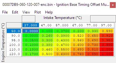

That is the multiplier table to ignition correction with IAT temp. Absolutely insane to spoof that with no control over the main IAT ignition correction table. RIP anyone that tracks with a JB4 and that spoofing on. Not to mention other tables that depend on IAT reporting. RIP your knock tables.
Also, one of those axis is wrong in your screenshot. ;)
JB4 to DME:
Yep, well, they've done it with N54s for almost 20 years without issue. I'm not concerned.
Whatever table I shared not being the main one isn't really the point. Its just that variable base timing is not compatible with absolute boost targeting. Spoofing freezes all IAT-based timing tables.

Wrong is wrong. N54 lmao. "Without issue". Yea... okay. I know you make money tuning these things and a good guy for helping everyone but good lord what trash that product is. Doesn't help that Terry is almost as big of a D-Nozzle as Visconti.
Yup I know it's ecutek, and a lot of things are not correct in their definitions.

I know you make money tuning these things but good lord what trash that product is.
brother I have not even made a week's worth of my day-job pay doing this for a year ? I have no skin in the game so there's really no need to go on the offensive.
I'm literally doing it for fun just like you have your tune thread. Because its the right platform for me and many others at this time, anything else is a bonus.
And there's really no need to try and undermine my recommendations to @Timmy_Jones , unless you can prove to me why spoofing at 100F while his ambients are in the teens is dangerous in any way whatsoever. I would argue it is more conservative. What I am doing is not unlike anything Terry at BMS or Jesse would do.
Genuinely if you have something to educate me, I'm all ears. I've only seen as many of the dme tables as I could research.

You can download tunerpro and all the XDF and BINS off MHD and MG GitHub’s and see everything.
