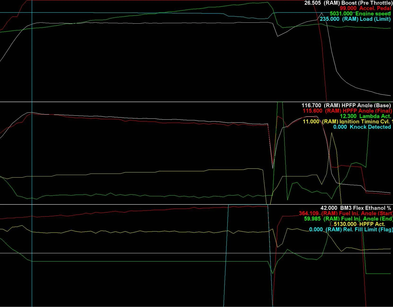

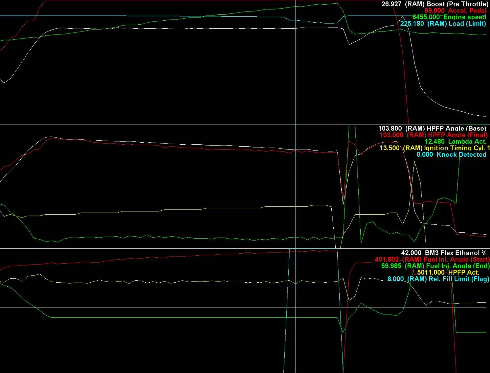

That is when the SOI hit over 400. No way a stock turbo B58 is hitting over 400 SOI
Mine doesn't even hit that until high rpm 6500rpm+ at 28+ PSI on a Pure 700
EDIT: My bad, I thought that was the link to EOI and SOI since you mentioned injector IPW. That is HPFP angle limit at 126, not injector IPW or anything. Stock turbo can def hit that in lower/mid rpm. I don't see how this is MT specific though?

@ColonelAdama
Here is an example of load limitation created by injector SOI (Fuel Injector Angle Start) going over 400. Notice that load limit logging item (top light blue plot) drops as soon as SOI crosses over into 400+ and the Fill Limit Flag "8" gets tripped.
