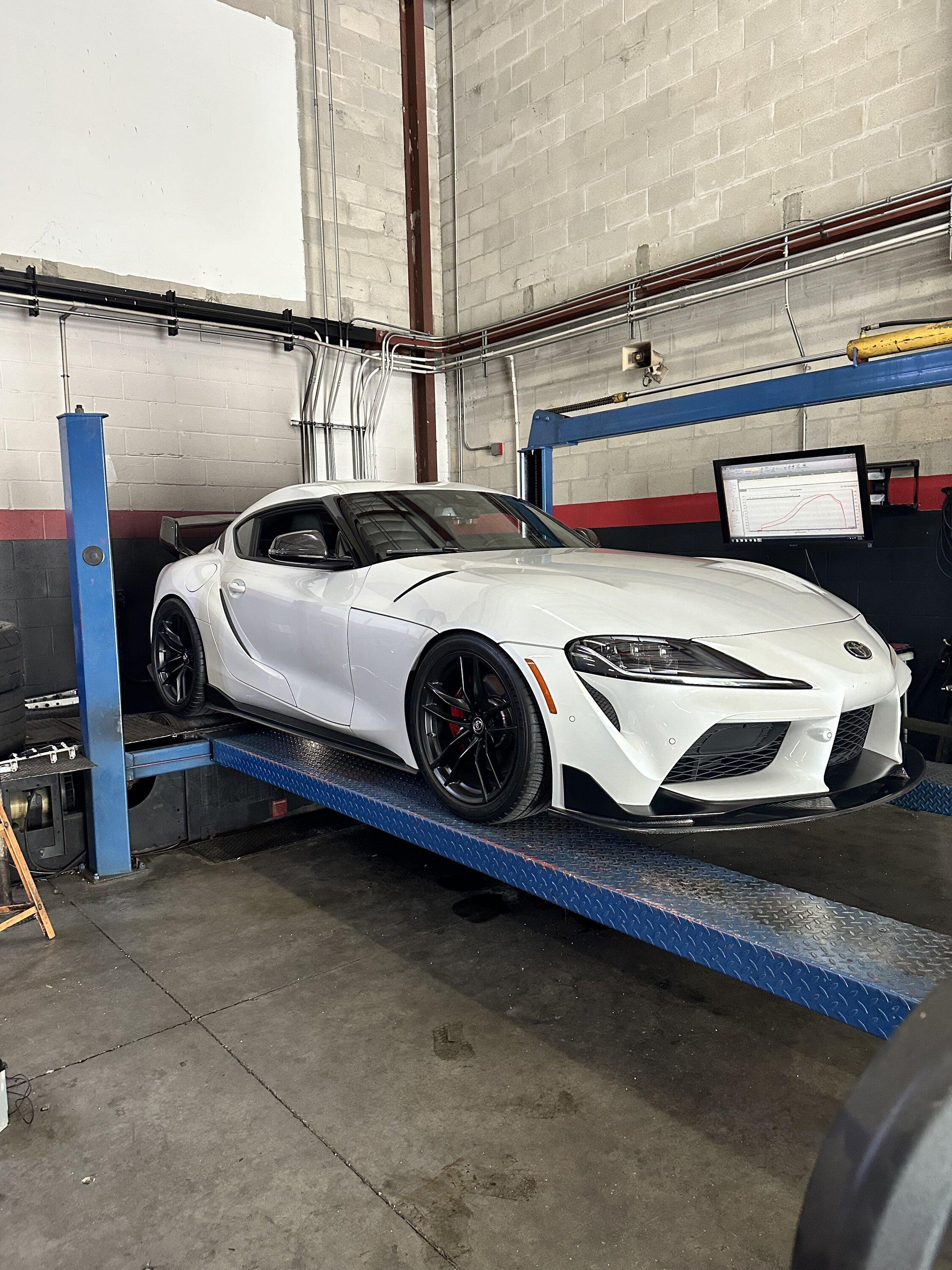

Strapping down moment of truth LOL

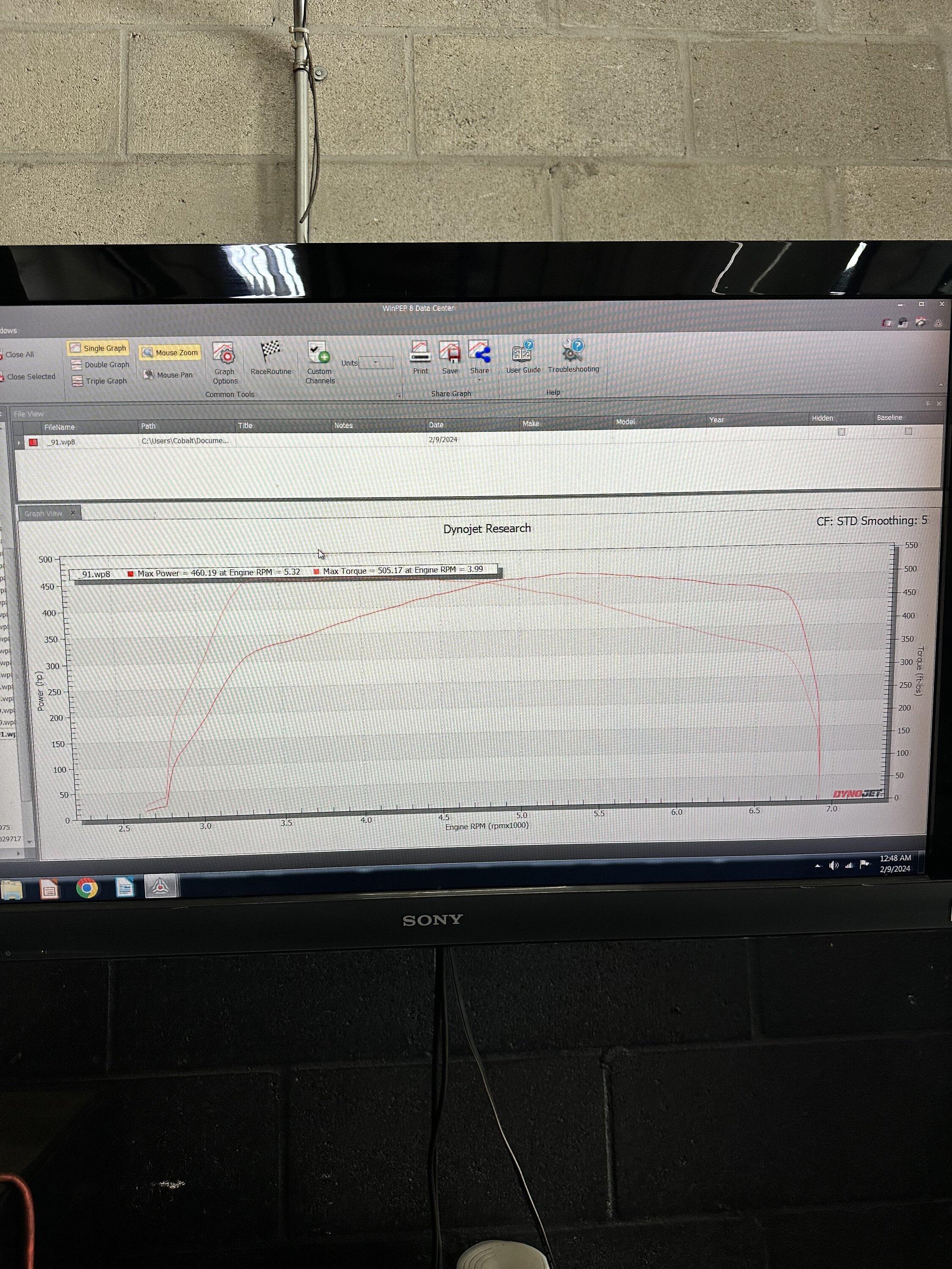

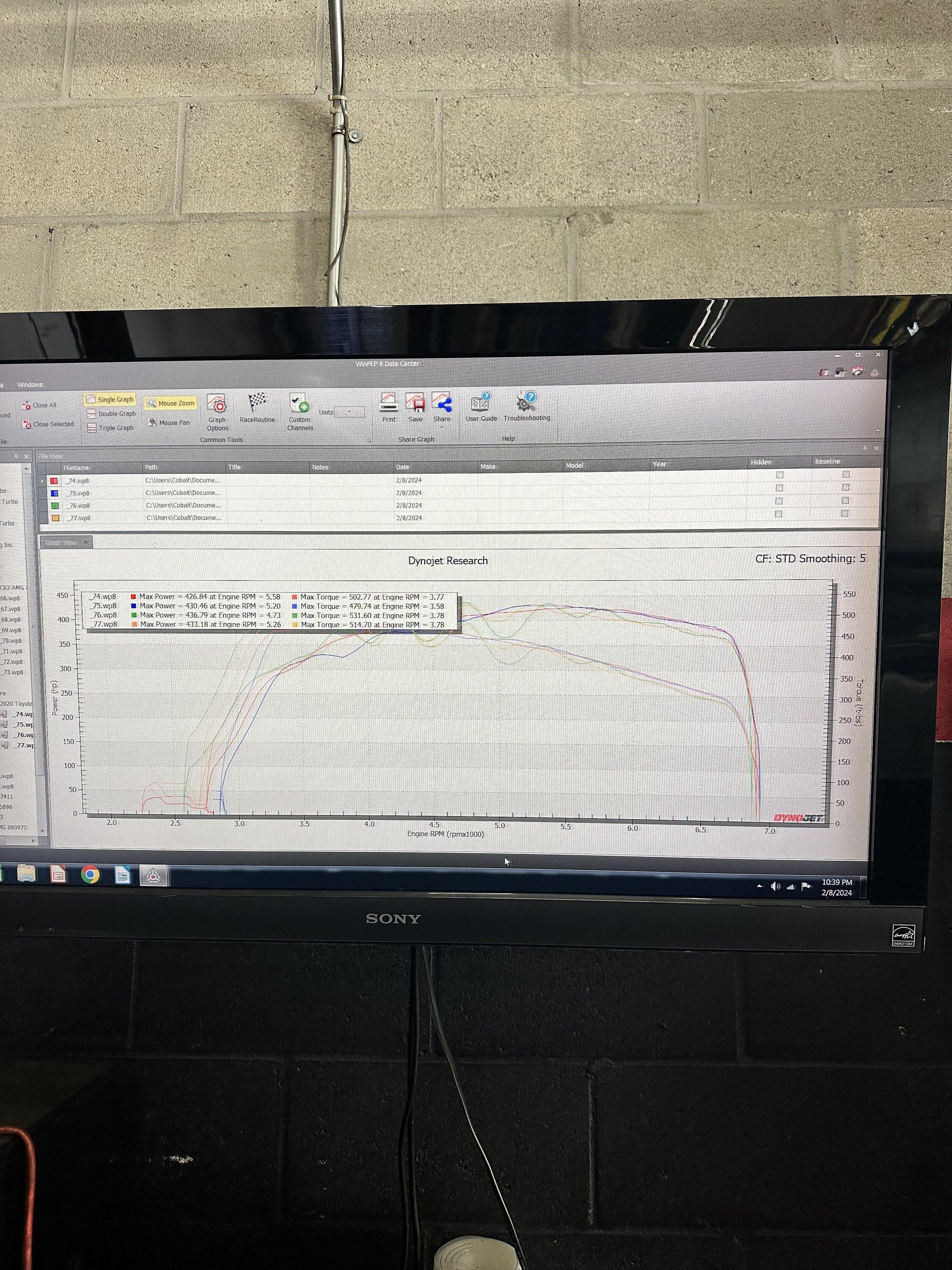

Best run 436rwhp/531rwtq
JB4 didn’t do much for HP but managed 25lbft tq so not worth it. The MHD OTS e40 did 430/505
when you add drivetrain loss back in it’s about 500hp crank so a down pipe, some exhaust and filter and tune added 150+ hp over the stock 335 the 2020 had.
seeing if we can grab a custom e30 map if there is any more power to be had.
graph below
Run 1 - MHD OTS - super smooth line
Run 2 - MHD OTS and JB4 Map 4 20psi target added. - smooth but no real change in power
Run 3/4 - MHD OTS JB4 Map 5 22psi target. Run 3 pulled boost and timing. Run 4 adaptations started kicking in and started looking better. Not as smooth as run 1-2
cooling down will go again… hopefully adds some new info to the tuning scene with real numbers.
graph below
Looks pretty strong on the OTS. Looks like throttle closures on the JB4 stacked runs. Can you post the logs?

Yea we are messing with map6 we are up to 457rwhp/525tq
it had a bit of a fit and decided it doesn’t want to play nice.
