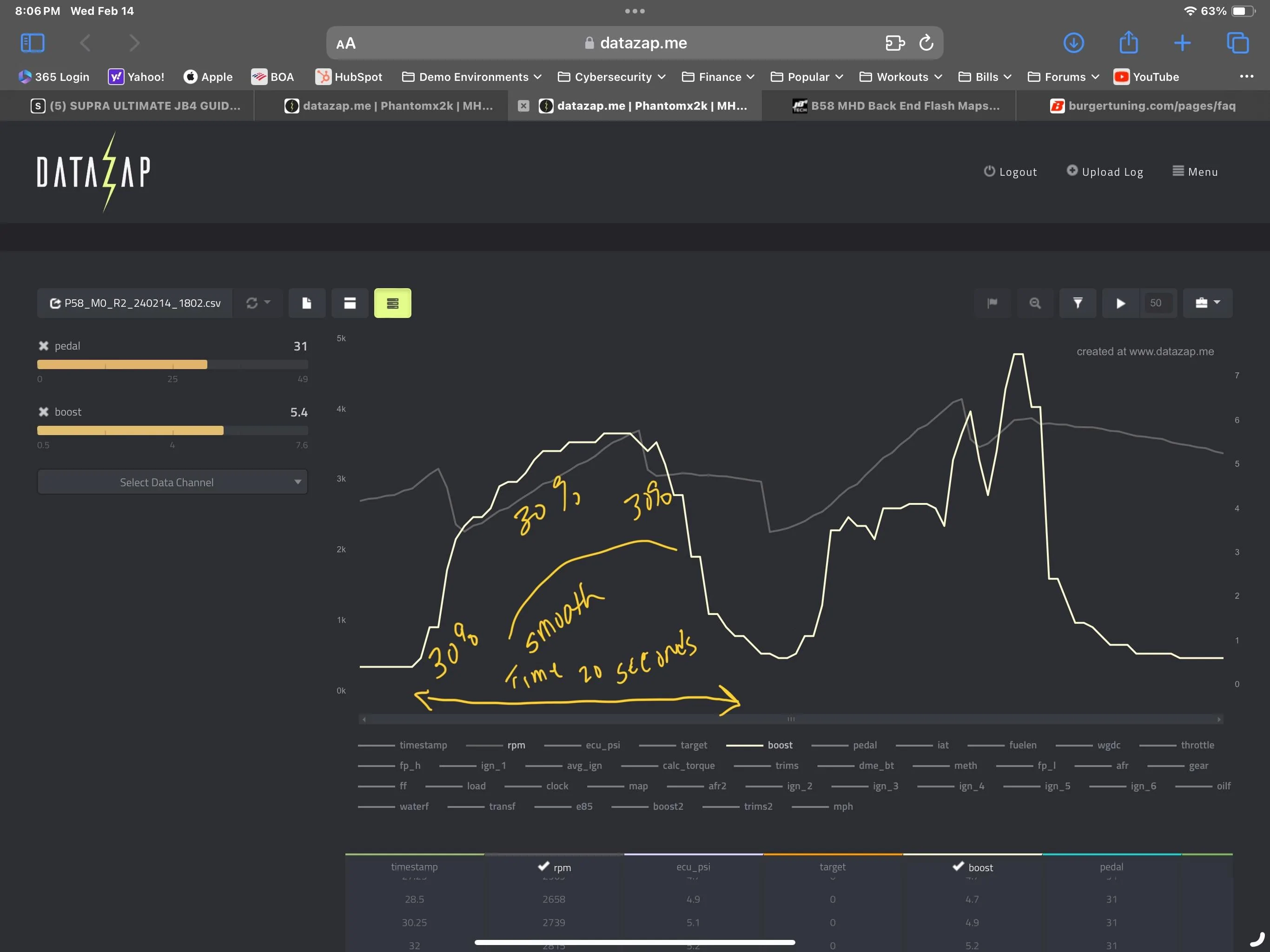

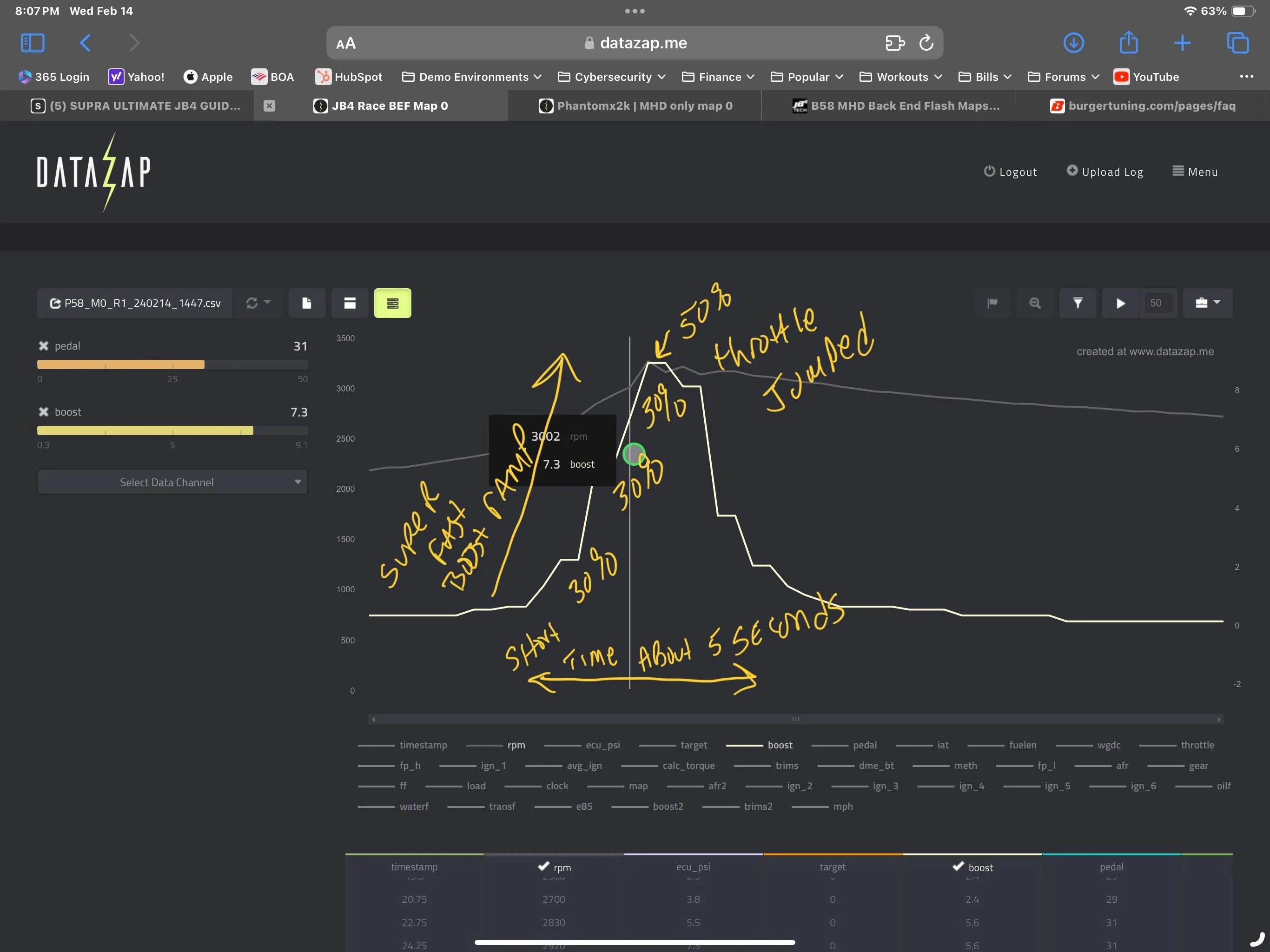

Here Is the difference to illustrate why this was scary.
The first graph is the MHD tune and you can see about 30% throttle and holding 30% for about 15-20 seconds and boost stays steady around 5psi like it’s supposed to With a nice easy ramp up and then holding like it should.
The 2nd chart. You can see a massive boost spike throttle still 30% but ramping up super fast even though i’m holding 30% the boost is ramping super quick this was like 5 or so seconds and the throttle opens up to 50% (I really didn’t move the pedal) I’m guessing because the boost was coming in so fast it applied more throttle to compensate as it went from 5psi and I let off when it hit 9 because it was coming in like I was accelerating but I wasn’t i was going easy.
you can see the exact same throttle values in both graphs and wildly different boost behavior.

Just do a normal log and post.... I see a peak of 9 PSI at 50% throttle input.

Not sure what you read that log shows 9psi at 30%. Those graphs clearly show boost spike abnormally fast not to mention it surges and bucks, throttle response isn’t right. It’s like it’s not meant for the car it shouldn’t be trying to run that much boost pulling out of my side street in the neighborhood
I can’t do a normal log has been my point it over boosts drastically. I jumped out of the throttle after barely touching it and it has hit max boost under part throttle I’m not blowing the motor up for a log file. It is clear something is wrong as Adam’s pointed out the lat issue and if not working either and they should
and say I do post a log and it shows 22psi at part throttle way over boosting nothing anyone of us can do the Burger map is the problem unless you guys can fix there tune?

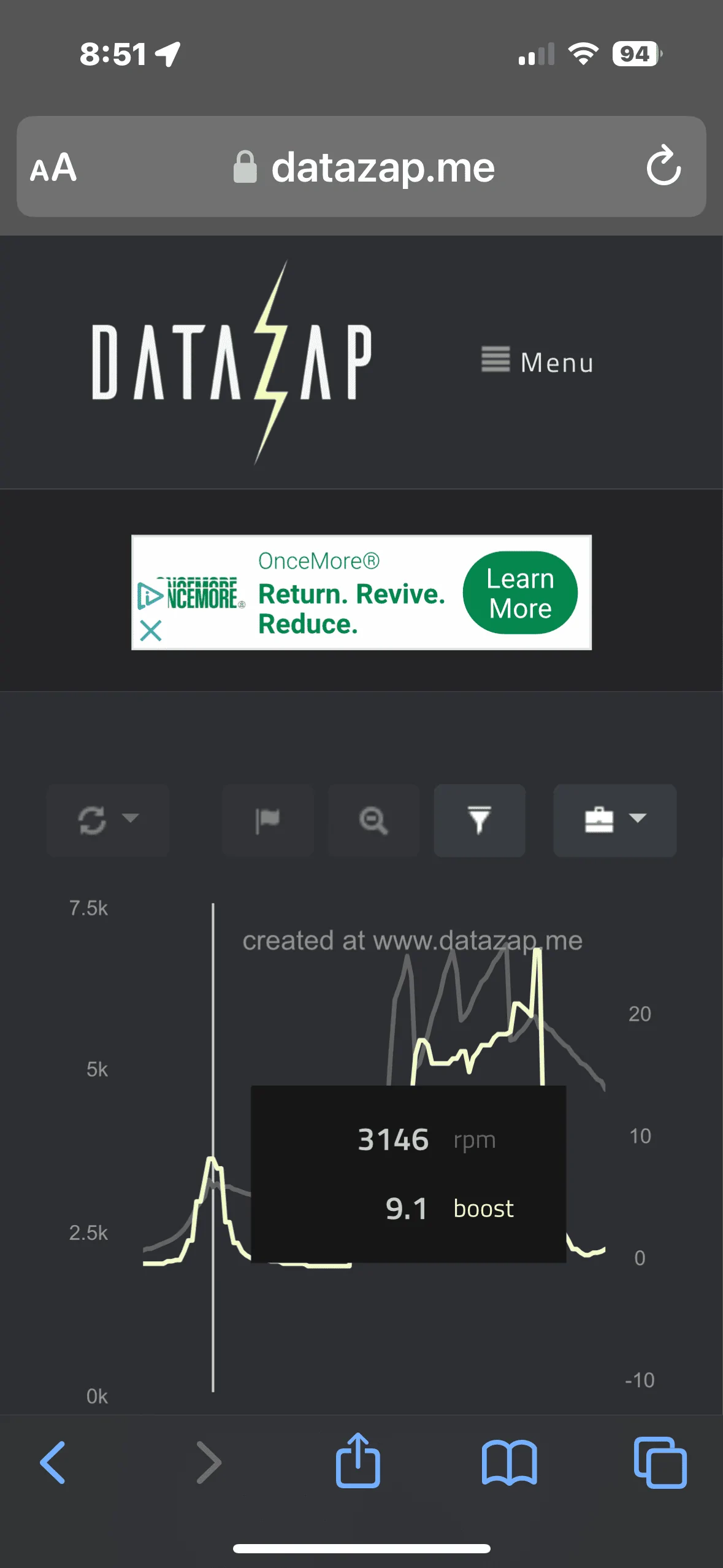

Look at this log. Since Jb4 combined runs this one shows the same crazy boost spike hitting 9.1 psi just pulling out on the street. The car should not do that at 1:/3 throttle easing out
the back half of the graph where the run begins is reflashed and is the MHD tune. So 2 different flashes in the same chart
notice the iat doesn’t work and ff. Then the flash change and it suddenly works.
