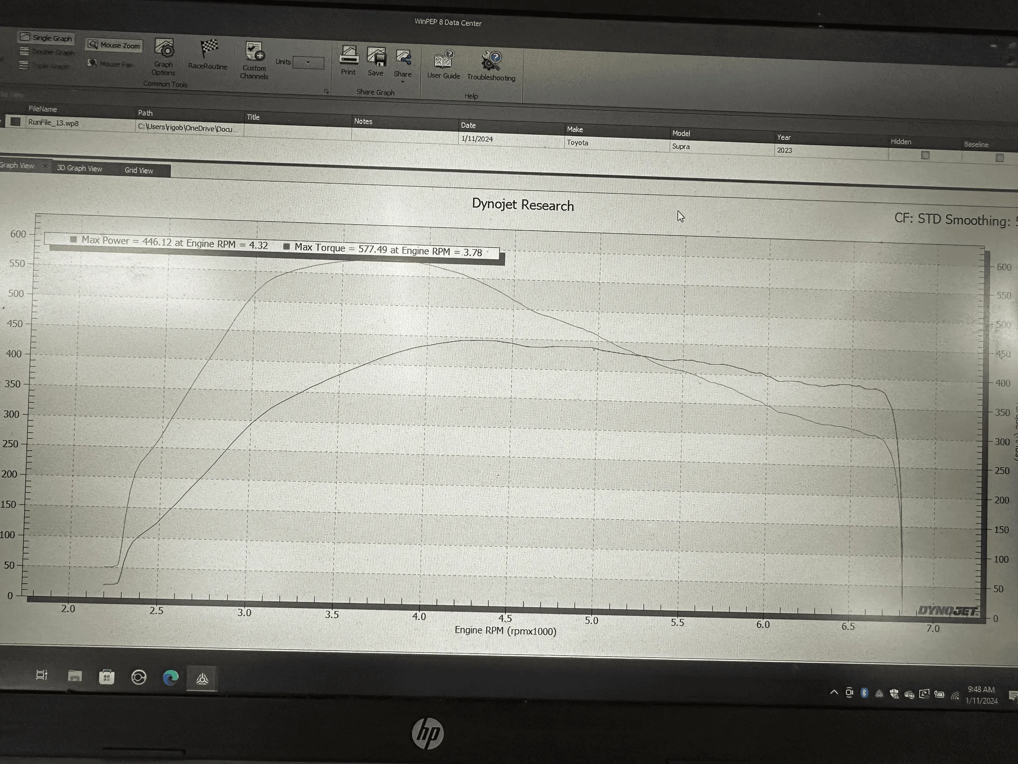

This was the last 93 MT car we did.
They are definitely doable just this is about as far as i can take them so far. Maybe 10-20 more HP and thats even with an Eblend.
If anyone has issues ive never turned them away but I just dont know who wants to sit and do 20-30 logs to get it this good lol.

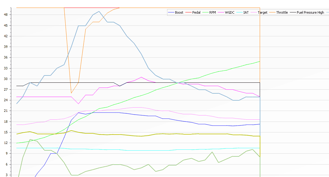

After driving for a while I finally found some back roads to do a few pulls after work.
Here are some runs on Map 2 and Map 4.
https://datazap.me/u/adm613/log-1706653433?log=0&data=1-2-3-4-5-8-9-15-20-23-34&solo=23
I'm still trying to interpret all of this to any useful degree, but I feel like I'm like trying to read a book but while learning the sounds of letters.
Map 2 is all over the place but Map 4 has potential. lets work off of that. Just looks like overboost from DP that needs to get worked out.
Set FF to 47, set bit 1 on to keep it adapting poorly.
Duty biases for downpipe: start with these:
duty_15duty_20duty_25duty_30duty_35duty_40duty_45duty_50duty_55duty_60duty_65duty_70
40​
40​
40​
42​
44​
46​
48​
50​
50​
50​
50​
50​
