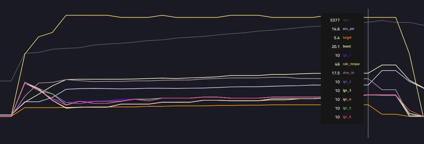

Good example of proper tuning on MT - my car today.
Here's a useful tip if you're struggling with throttle closures- Keep dropping duty/FF where you see calc_tq exceed 48. You can see mine is perfectly smooth thru the usual troublesome mid range since I keep calc_tq under 47. Make sure to use V28 firmware or newer.
You will typically see calc_tq spike towards 50 before you get a closure.
I can't say for sure why it works but I figure the injection monitoring BS doesn't kick in until you get near the dme load limit (or in JB4 terms that would be calc_tq at 50)

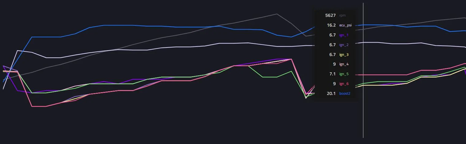

Not all 93 (or premium) fuel is created equally.
Here's the strongest pump gas 93 (shell) JB4 car I've been finishing up at 20-21 psi. Easily a 440whp/500wtq car.
https://datazap.me/u/coloneladama/log-1749237553?log=1&data=1-2-11-25-26-27-28-29-34&zoom=52-90
This is why logging is so important. My car won't even run Map 1 this cleanly on 93 around here.
The BMS map suggestions are rarely accurate in my experience.
Cali 91 on Map 1 will be rough. Consider not tuning your car unless you have ethanol.
Proper 91 on Map 1 will be ok.
93 on Map 1 will be good.
93 on Map 2 will be iffy (usually not good enough). 2 gal E85 in the mix guarantees a strong Map 2.
Rare cases where Map 3 works fine with E30, but its really more for Gen 1 b58 or B48s handle it pretty well. M40i engines can't handle it as they already run so much boost factory.
Map 4 or 5 on P158 firmware are strictly to be used with E30-E40 with FOL control ONLY (fp upgrade).
In this case, this owner got a Map 6 (similar to Map 3) out of his 93 fuel.
His testimonial is that his wife's JB4 tuned X4 is now quicker 60-120 kph than his M240 on MHD stage 2. (2.95s vs 3.12s) JB4 car in worse DA and about 500 lbs heavier. Definitely unusual for JB4 to be so much quicker than MHD on pump gas!! Shows that OTS is usually conservative for the given fuel, and a custom JB4 map can match it or beat it if the fuel is exceptional.
