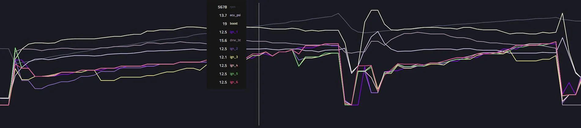

Just wrote a section on Ethanol blending, as it is common for people to run too much and go lean. I have seen many logs like this.
It is best to start low (~2 gal), as each car can vary how it handles the extra fuel load.

I’d like to post my log for yall to see it having trouble figuring out how to link my datazap. I’m on E40, I feel like my car should be getting more out of this mix.
