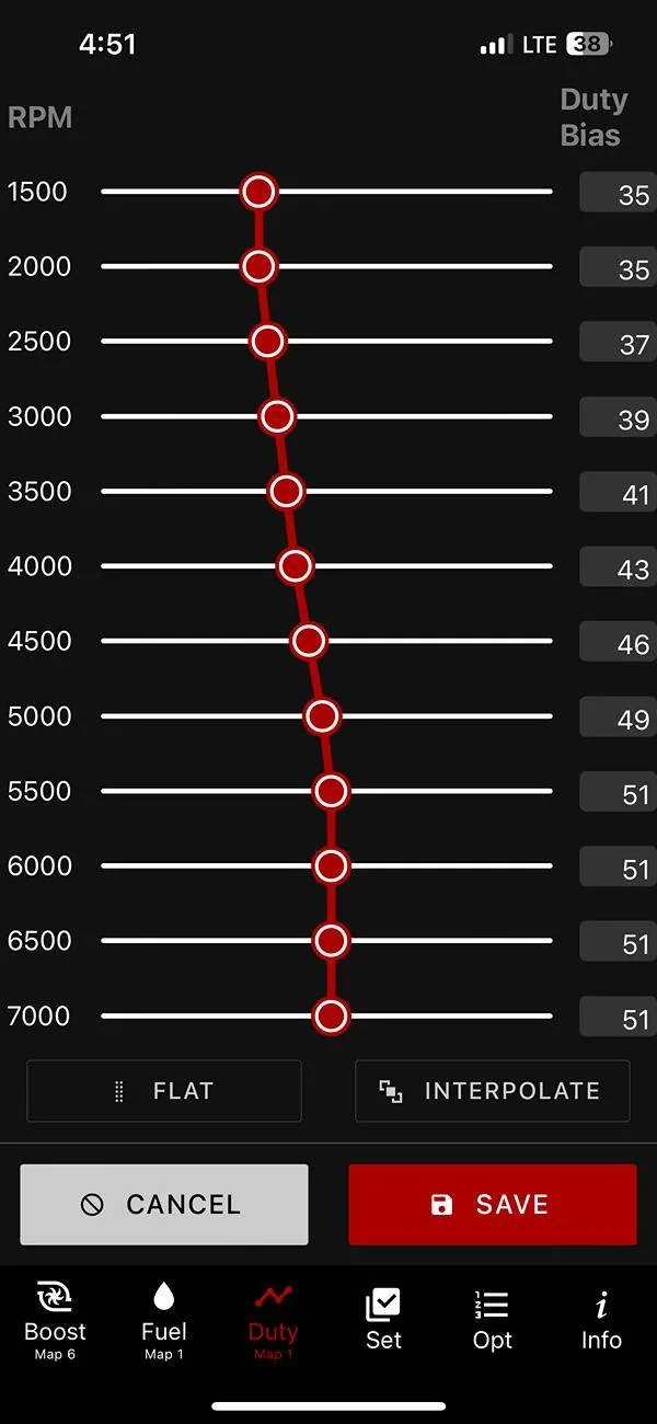

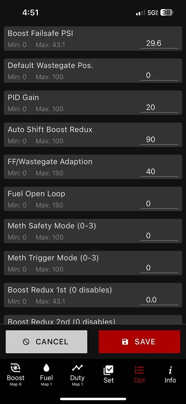

Does anyone know what the default values for the following parameters should be for map 1 (V28 firmware)? I got mine used so I believe these values might’ve been entered in by the previous owner.
I can't remember what the default biases are but definitely lower the boost failsafe to 22 until you start adapting the tune to your car and get logs to make sure everything looks healthy
those look like settings for something like a 400 cell DP (AA for example).
Standard FF and duty bias is all 50 for stock DP
shift redux is 60 standard
