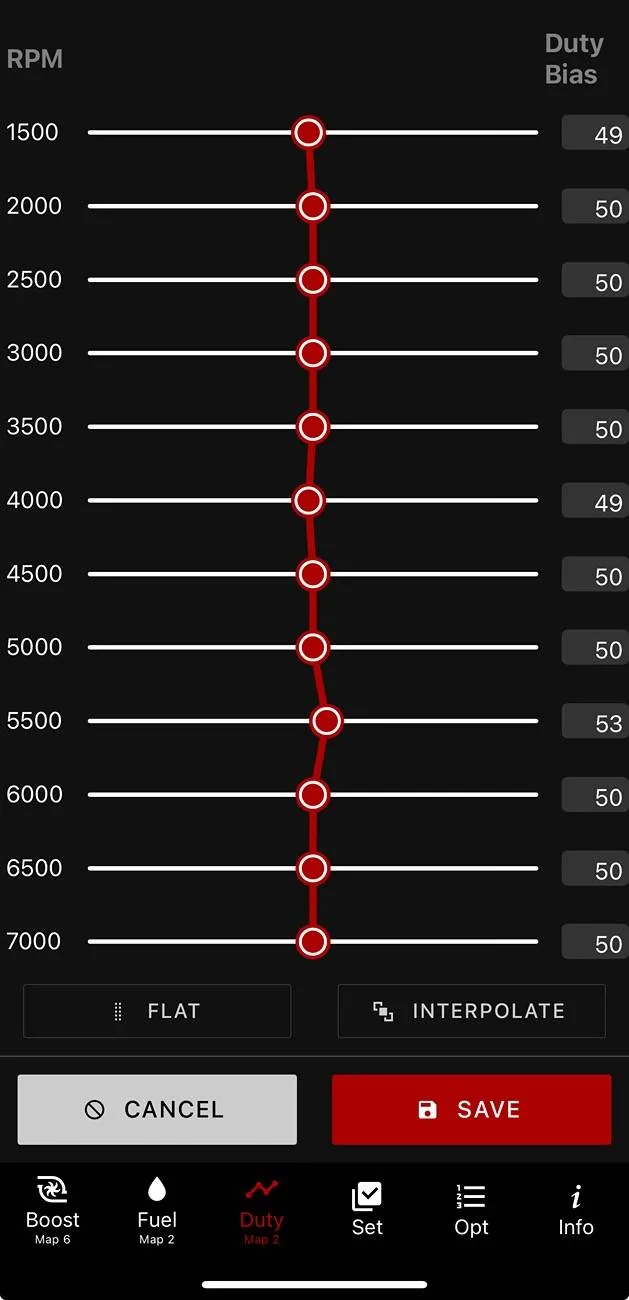

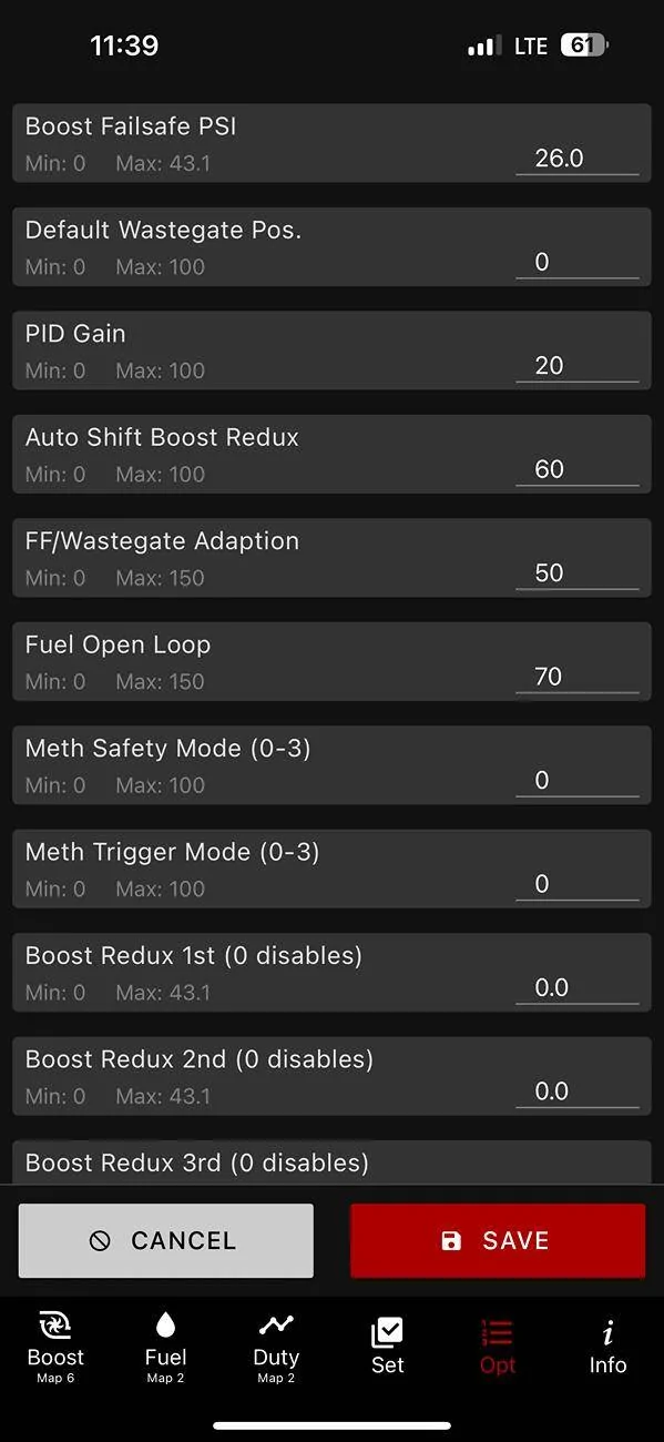

Map 2. 3rd gear pull. Car feels slower. Fuel pressure sensor installed. Changed FOL to 70. No other changes. Running latest firmware @ColonelAdama advised me to run.
i meant V28+ for firmware, but it looks good. Just reduce duty in increments 3-5 in RPM ranges until ecu_psi sits about 1 psi below dme_bt the entire pull. ie. add some duty at 5500, reduce 4000-4500

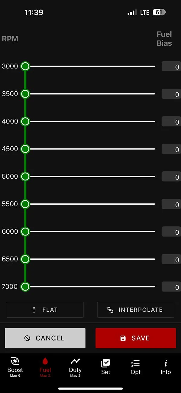

Running the jb4 with fuel sensor set at 70 and fuel-it (this is only for showing e content in jb4) but I also am running water/meth injection and did the DAW hypercore upgrade, AA dp. Running around e30-35 w/91 oct and hitting 27psi and still under 45 trims worst case. Feels really good.

Which kit are you guys running? @ColonelAdama I may need a translation for your last post? “add some duty at 5500, reduce 4000-5000
He is saying to adjust your duty/fuel up and down 2-3 until your boost level at those rpm’s during a log read 1 psi off target boost. Make sense? Reduce 4000,4500,5000 by 2-3. Raise duty at 5500 by 2-3.

Car in diagnostic mode. Thx btw
you've got the right idea. You can set duty 4000 and 4500 to like 45, 5500 to 55. See how it looks based on that ecu_psi and dme_bt criteria and go from there.
If you just want me to do the custom map, PM me and we can work that out. Been busy so just doing custom maps for paying folks rn
otherwise all the info to custom tune yourself is here :)

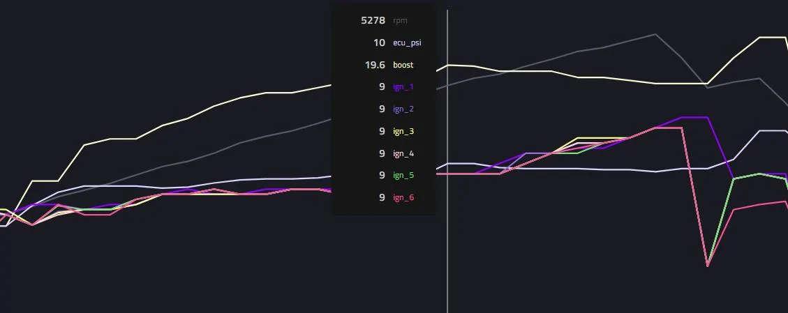

https://datazap.me/u/coloneladama/log-1745430389?log=0&data=1-2-4-11-25-26-27-28-29
Non m40i "low output" B58 (540i) responding nicely to the Jb4 FP upgrade, allowing nearly 10 psi additive on E40. double stock boost! Right on the limit of JB4 capabilities for the platform/fuel. Previously only 6psi additive without FP add on, so that is gains well over 50whp for the upgrade, and over 100whp compared to stock.
Reference log of MHD OTS E40 on a Supra
https://datazap.me/u/coloneladama/log-1745432189?log=0&data=1-2-4-11-25-26-27-28-29
I'd wager similar power figures, not far off on the JB4. Can definitely get you 90% of an unlock for <$600.
