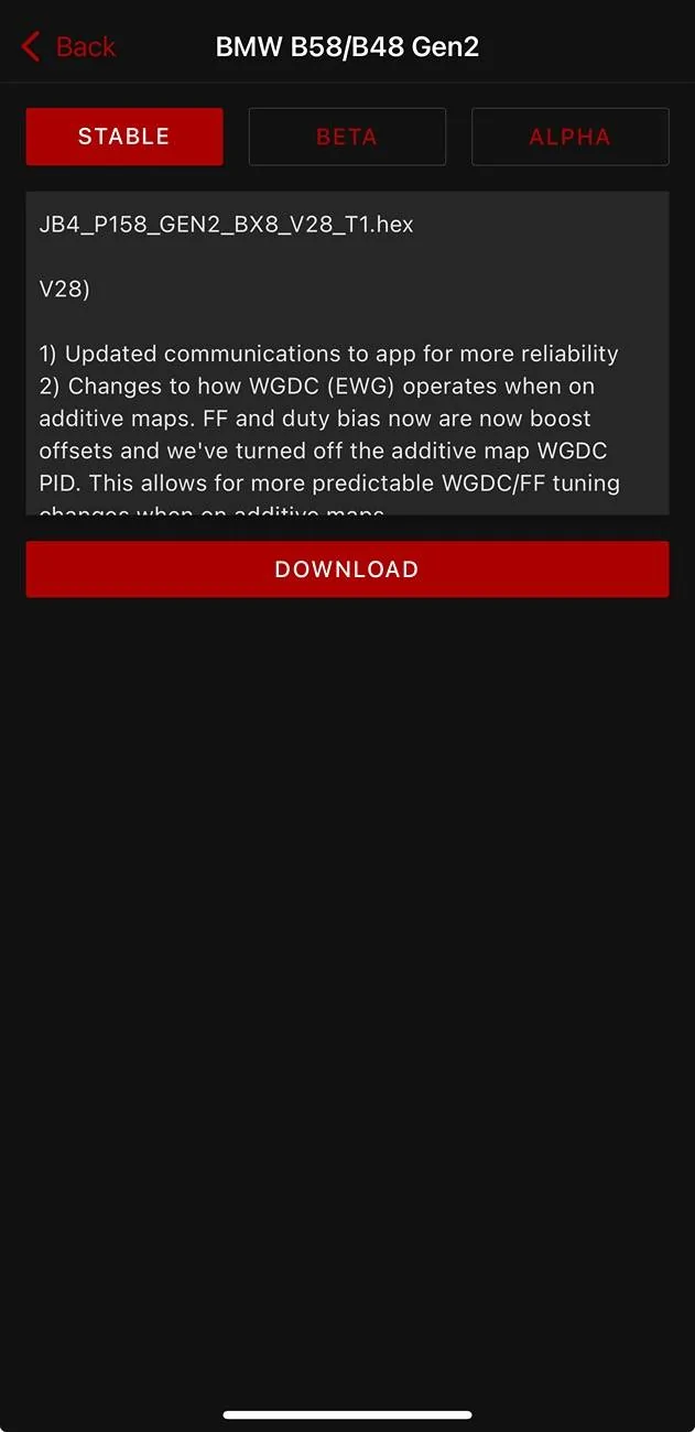

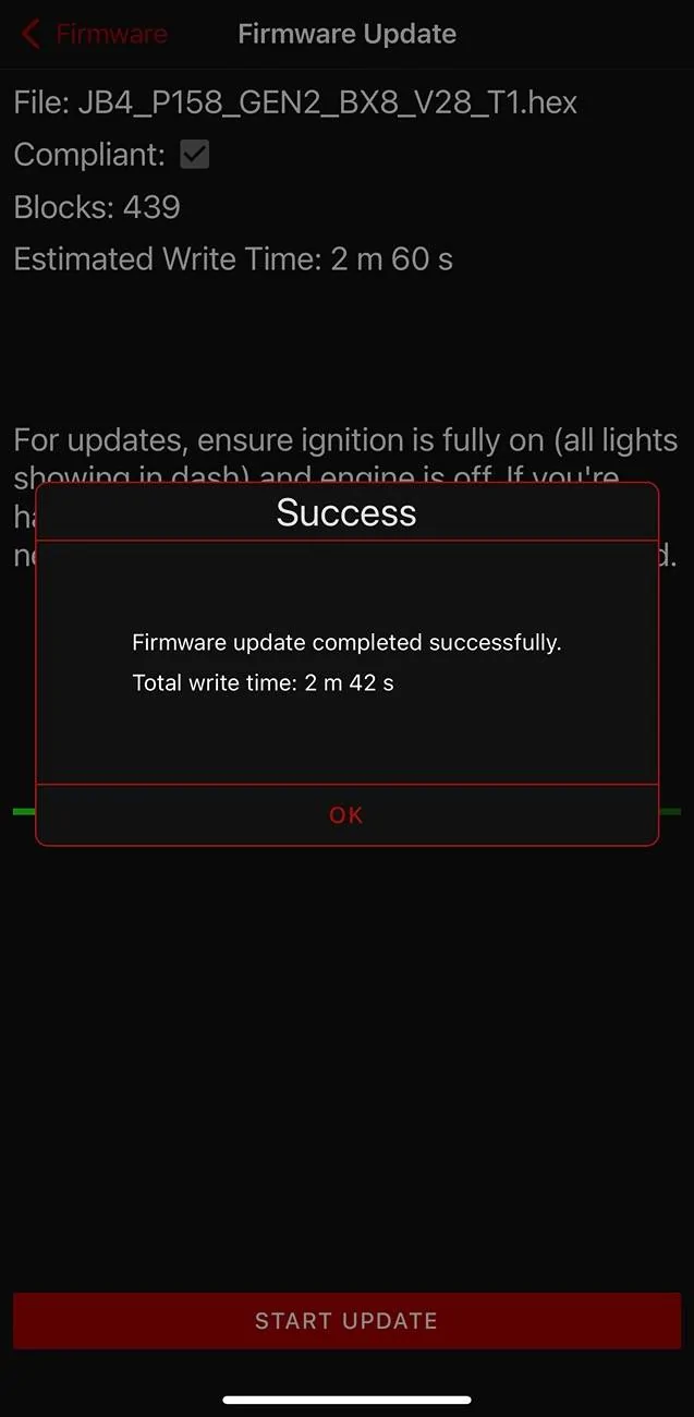

looks pretty good, I recommend updating to V28+ firmware, but this is a good E blend for map 2. You will need a bit more ethanol to run anything higher
I’m willing to crank it up to another map and more E but like you mentioned I would need that FP I assume first.
