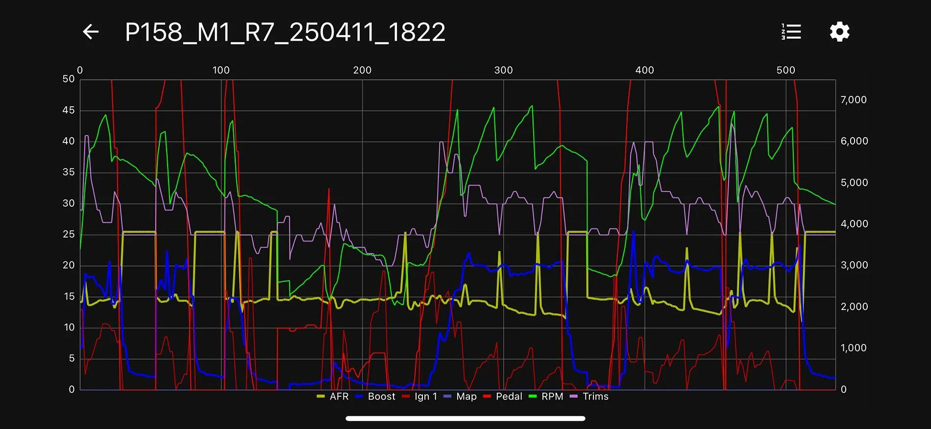

Ok i put E-40 which is probably a little less due to having some 91 in it already. I got it down to just 1 bar of fuel and put 4 gal E-85, 6 Gal 91 oct.
This is my map 4 log. It isnt liking something. Its pulling boost and then getting back on it over and over without me lifting the pedal. This is 2 runs of a 3rd gear 2k RPM log.
looks like typical MT fun lol, would need the datazap but I can tell your FF needs to come down a good bit. I usually prefer additive mode for MTs anyway on V28 or newer firmware.

Exactly what @Got_M said. Map 2 is pretty solid but a little octane deficient. like 2 gal of E would help it make more power. If its hot out, I'd probably stick to map 1
Thx guys
So couple gallons of ? on Map 2? Or 2 Gallons of ? on a different map?
Not putting the wagon ahead of the horse, what’s the max ? can run with the JB4? I would like to get a custom map.
Try 2 gallons E85 with map 2.
E25 max without FP upgrade, E40 with.

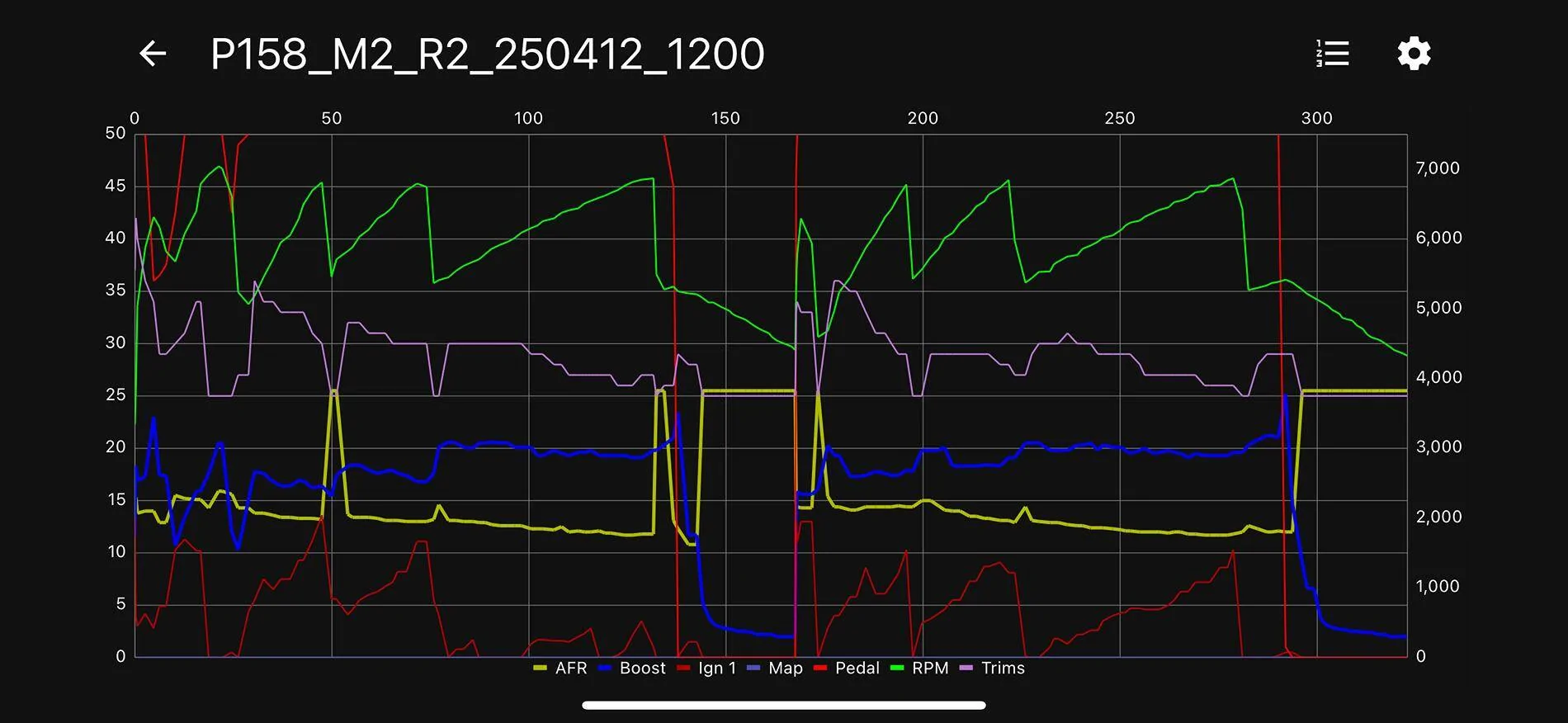

https://datazap.me/u/bayeauxsupra/log-1744673644?log=0&data=1-4
Another log on Map 2 today with a splash of ?
TIA
Weird I tried doing several logs but seems like only 1 record and it may been one where it hit the rev limiter. I was trying to run the draggy also at same time. Speaking of what’s a target 60-130 time with the little mods I have.
If you can get a decent amount of timing and traction the jb4 with a little bit of tuning can get you in the 8s 60-130 most don’t get out of the 9s tho

looks pretty good, I recommend updating to V28+ firmware, but this is a good E blend for map 2. You will need a bit more ethanol to run anything higher
Totally lost on how to do this. Is it somewhere in this thread? I’ve actually skimmed through all 60+ pages.
