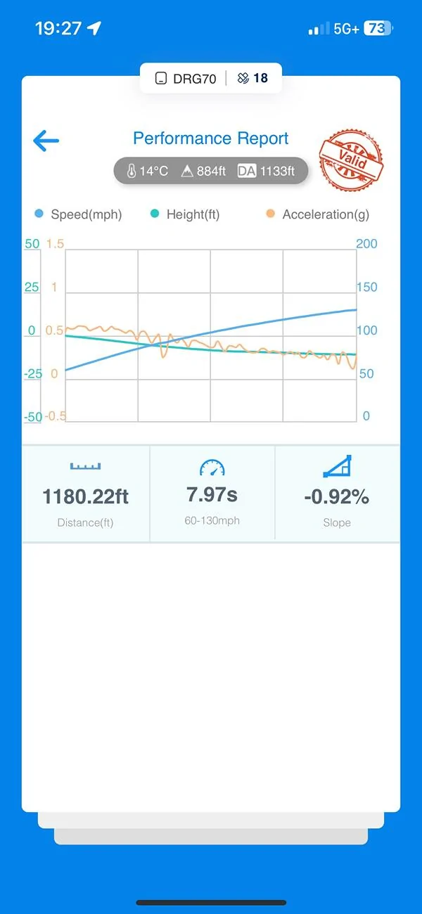

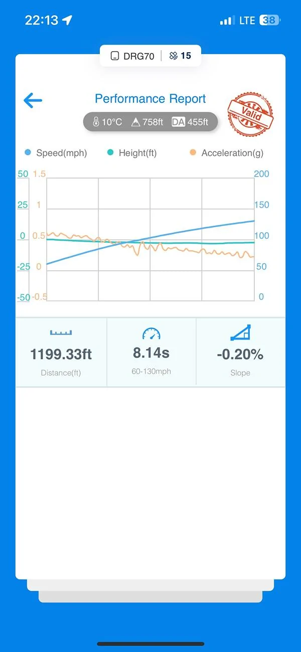

Nothing wrong with the throttle, it's just because of your downpipe. Car is overboosting and the throttle is preventing the excess from entering the cylinders.Haha, I know I am getting throttle closure based on the log (and how the car is behaving). I don't know how to figure out why. What do you mean look at the throttle plate? Forgive my stupid question. The car has 7k miles and I haven't ever messed with the throttle body. Do you think it is defective? My understanding was that the throttle normally only closes like this when boost is significantly over the target but that doesn't seem to be happening.
It's still running your wastegate as if there is the stock dp restriction. So you need to reduce FF(feed forward) until throttle pretty much stays wide open during the pull. FF is basically tied to turbine speed.
Try it in the 35-40 range first. It saves per map, under settings-advanced-user adjustment.
So you need to be on the intended map, then save the new FF value.
