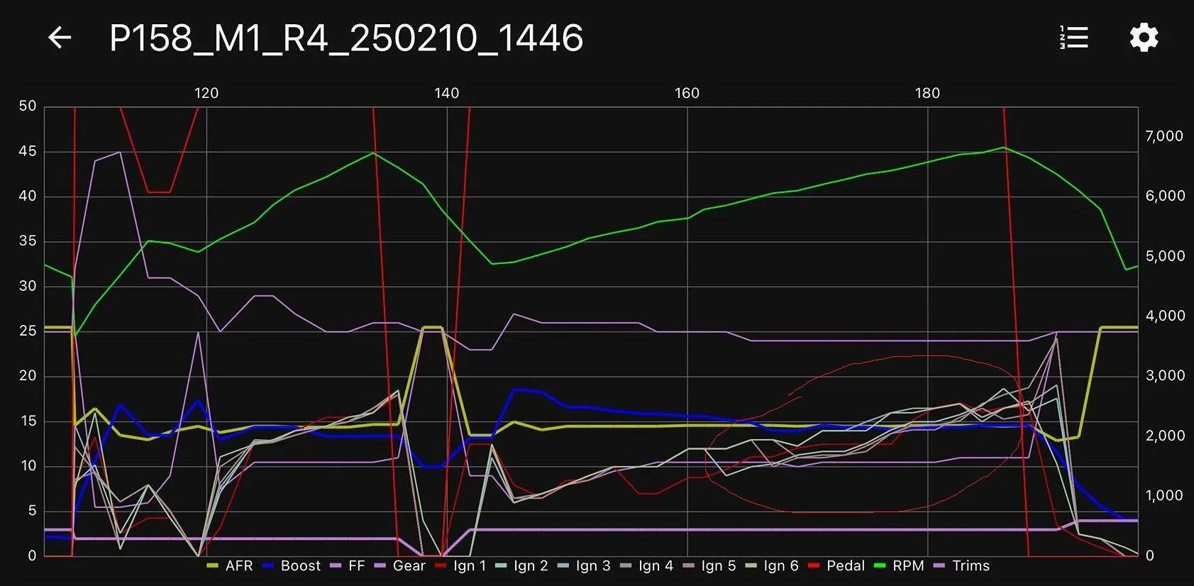

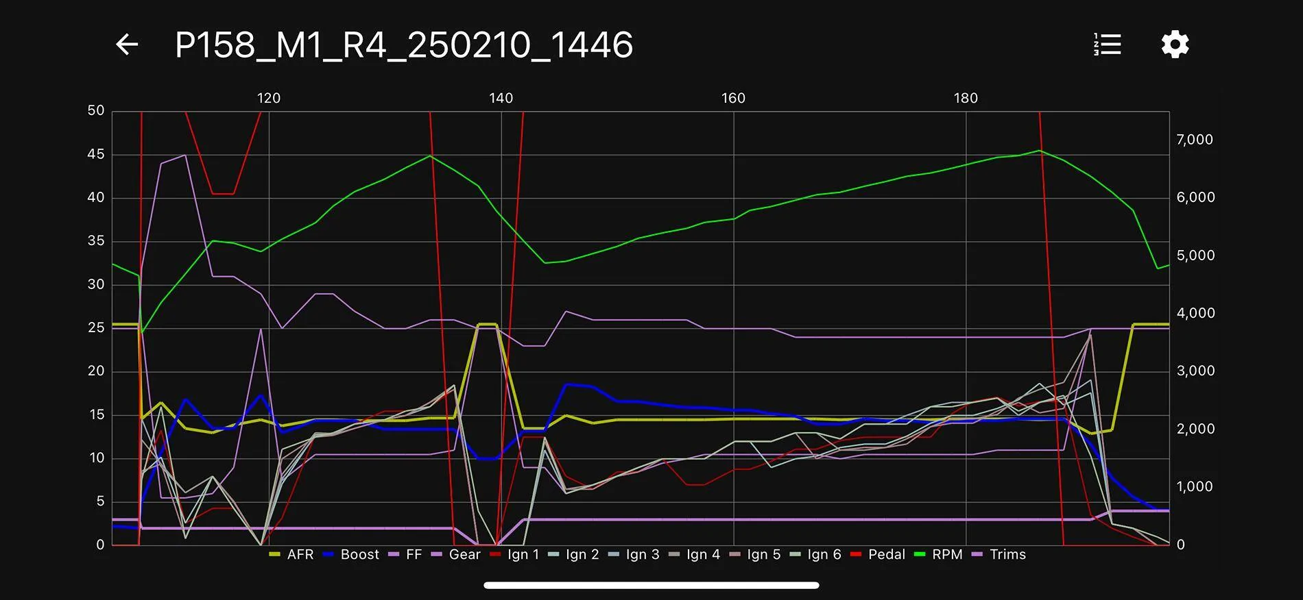

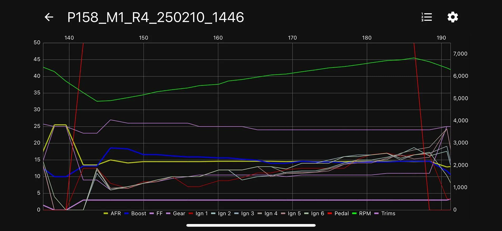

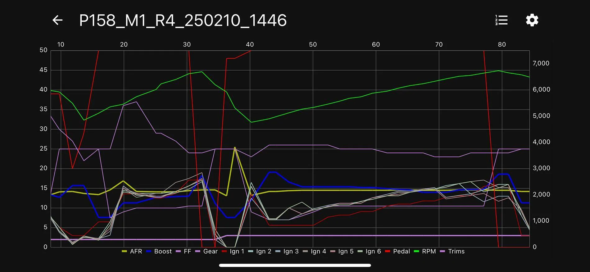

@ColonelAdama okay I got my valve open to run full straight pipes and Log. Here they are.
Let me know if you dont mind, if you see anything odd. Let me know if Map 2 still a no go on my 91 at 6k ft above sea level. 32 degrees today btw and 2nd couldnt grab tractions at all, little slippery lol

Yeah timing isn't super clean so I still wouldn't exceed Map 1. It will just have more timing corrections and rob any power from the extra boost.
