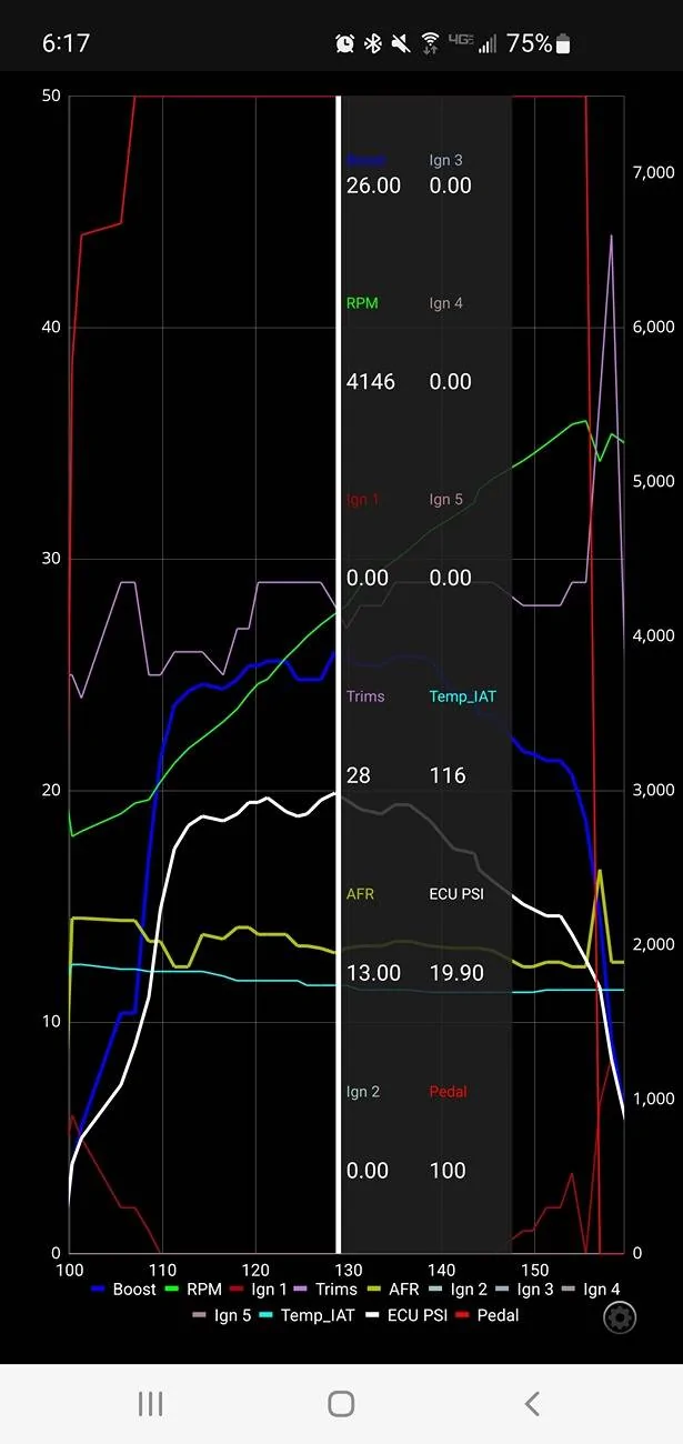

JB4 has no control over fueling,
yet... lol. Terry is working on an O2 spoof but not sure how brave I'd be ? ? ? bias it into the 13s
its like biasing a knock sensor... like uhhh idk.
He's only trying it since that dude in this thread ran no O2 sensor and it fixed all the MT injection-monitoring issues
Damn now that I think about it, my GTI has the O2 bias for the JB4 for like 9 years hahah, no issues. Runs mid 12s-13s afr

26psi no timing corrections

IATs are a bit higher, May be worth running a map 6 somewhere in between map 1 and map 2 on that fuel.
FF to 45 after switching to map 6
map6_15map6_20map6_25map6_30map6_35map6_40map6_45map6_50map6_55map6_60map6_65map6_70
1.3​
1.8​
2.3​
2.8​
3.8​
3.8​
3.8​
3.8​
3.3​
2.8​
2.3​
2.3​
1.3​
1.8​
2.3​
2.8​
3.8​
3.8​
3.8​
3.8​
3.3​
2.8​
2.3​
2.3​
Just changed the settings, but it looks like it saves numbers close to what i put in instead of the actual numbers, e.g. 1.1 instead of 1.3. Raining so unable to log but will as soon as it dries up
Yeah it can round a tenth or two, no worries. Won't make a difference.
