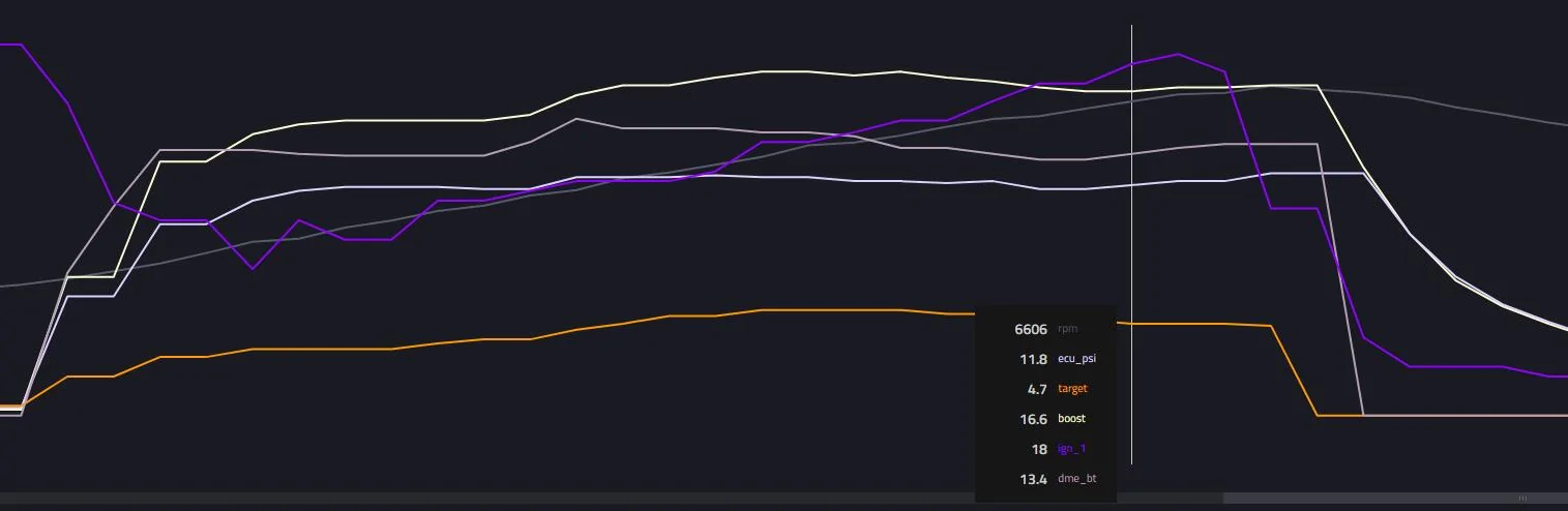

more good news coming for MT guys. Last update was an "mt mode" to purposely underboost.
newest additive mode testing says no underboost needed. Huge re-vamp to how it works. Updates soon!
https://datazap.me/u/coloneladama/log-1738636301?log=0&data=1-2-3-4-11-15&zoom=166-220

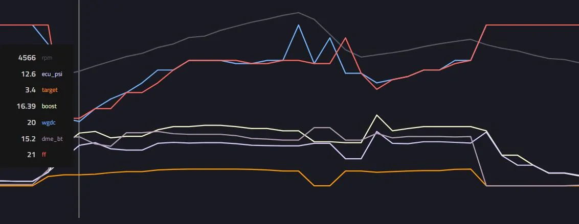

Tested on my own car this AM. V28 Hype is real, no stutters at all. And no underboosting. Will get more proper logs with TC off later (dip at start of pull). JB4 PID is essentially off and the algorithm for WGDC is completely different for additive now. WGDC is pretty much a function of ecu_psi only. Simplification is sometimes the solution.
https://datazap.me/u/coloneladama/log-1738683669?log=0&data=1-2-3-4-8-15-20&zoom=119-178

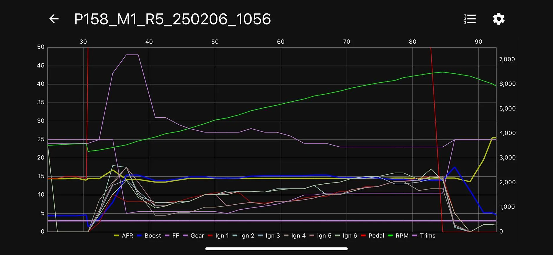

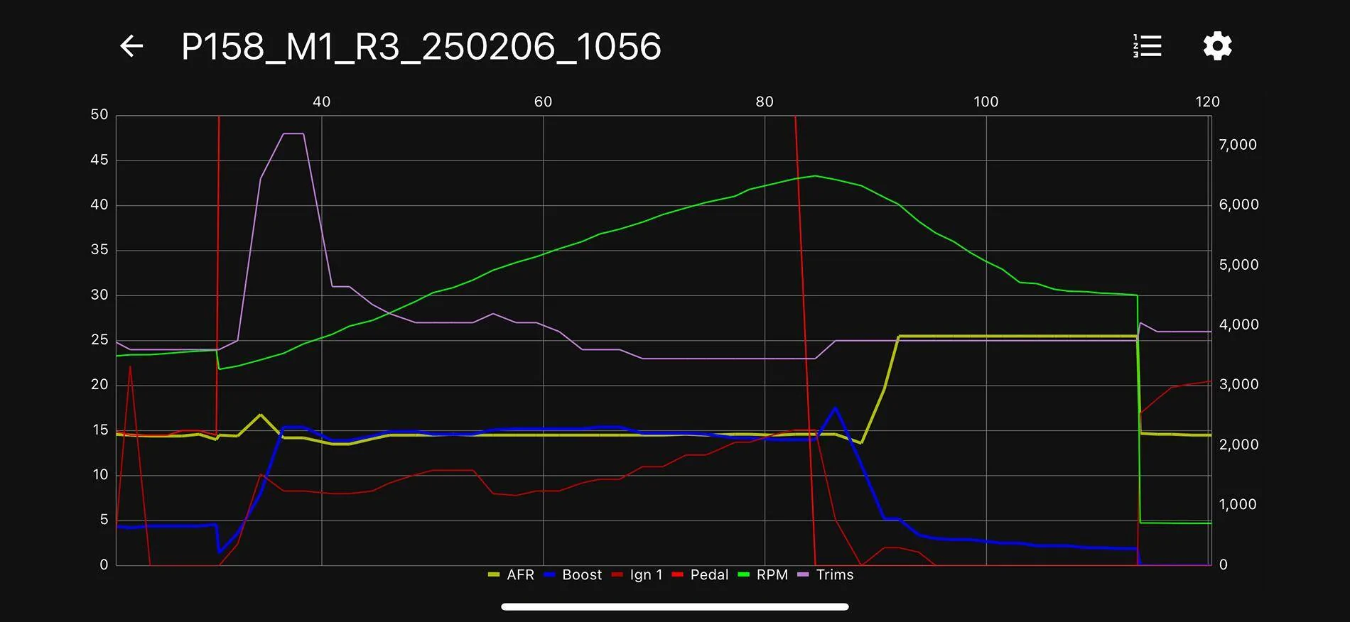

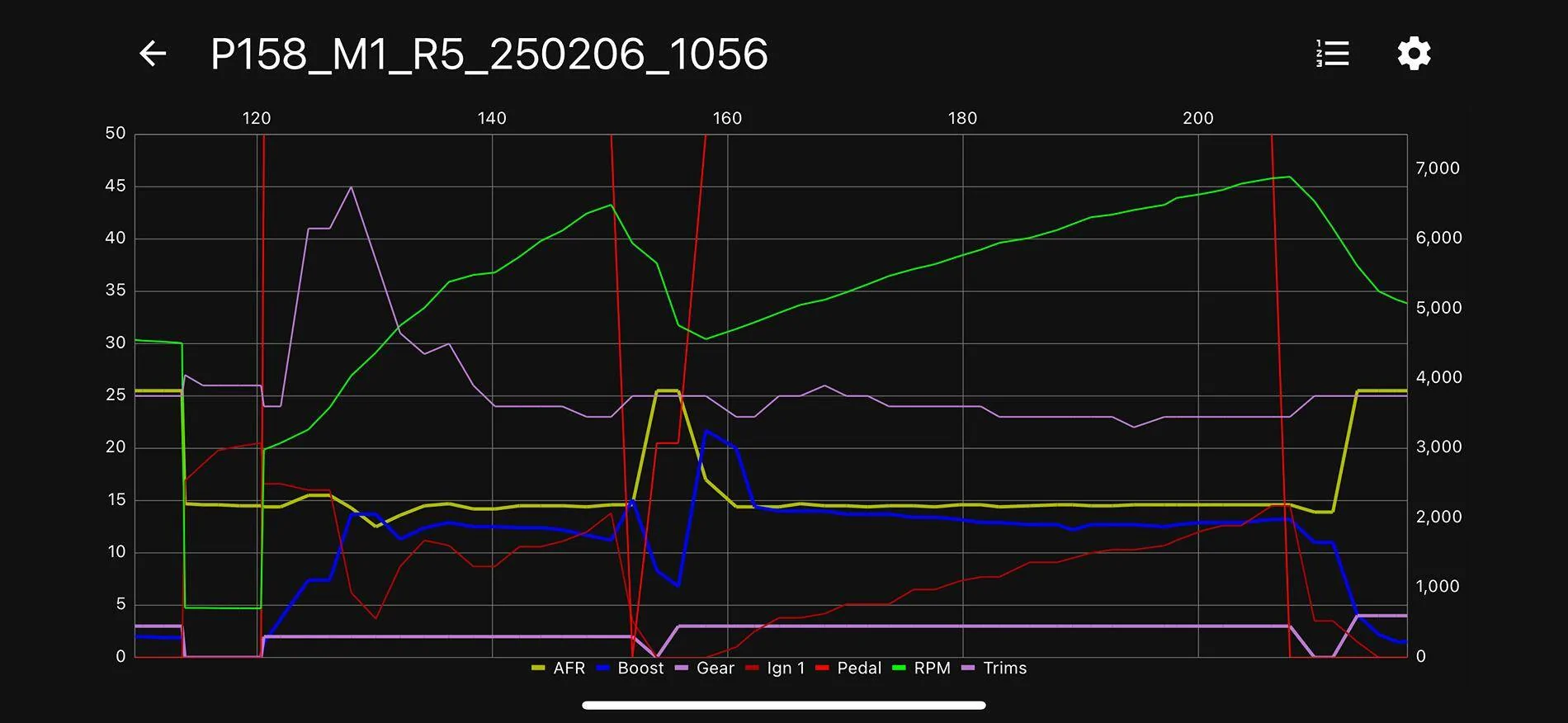

@ColonelAdama Here is my logs. FYI its 42 degrees out, and 6000ft above sea level. I did a 3rd gear pull, and also a 2nd and 3rd pull.What are your thoughts? AFR seems way too high imo. show 15 at full pull, but should be like 11.5? but that might be my oldschool turbo tuning brain working, and not direct inject cars
mid 14s is normal at WOT. Direct injection and relatively low boost levels. That's why JB4 pairs well with ethanol, since it runs leaner (and hotter) on a locked DME.
Log looks normal.

Need to see all ignition timing (all cylinders) on the graph for map 1 first
JB4 has no control over fueling, hence what you are seeing.
For DI, mid to low 12's are usually what are targeted when doing a proper tune. So yea, not mid to low 11's like older PI cars.

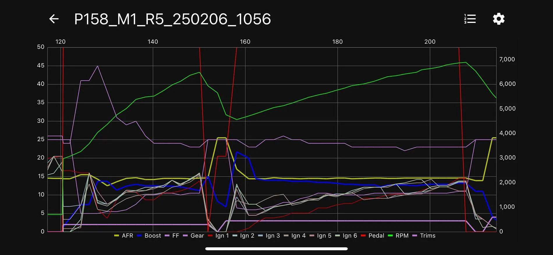

I added all ign cylinders to these pictures
Timing is already being pulled so no point in exceeding Map 1. Yeah the FP upgrade just raises rail pressure a little so trims stay under control when you blend ethanol. which I would recommend if you want more substantial gains.
