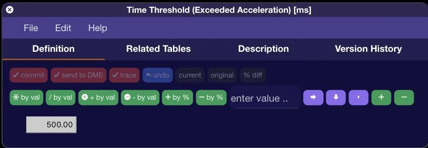

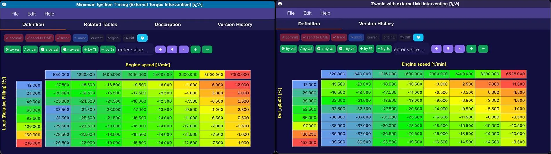

Quick search tells me 1F053C "traction control" related. "Max acceleration exceeded"
https://bmwfault.codes/
there are plenty faster JB4 cars lol.... not sure how we've managed to "go too fast" on yours ?
Maybe one-tap TC off "sport" TC for all pulls from now on. May have overwhelmed TC.
That is one 1D table tweak away in the DME. Easy peazy.
And yes, that will put the car in limp mode. Wait until you also see all the timing the car pulls for traction control with TC on 1 click off. Two 3D tables control that and easy to tweak.

that is so very helpful for us with locked dmes?
Unlock them and tune for real instead of being a lying partner to your DME. ;)

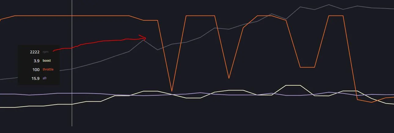

High AFR off throttle is normal, car isn't injecting any fuel while coasting.
I’ve heard that before. Thx for confirming. Since you live in MIA, if you’ve tracked yours, you ever get limp mode or reduce power with the JB4 on? I’m catless & other placebo effect items: heat exchanger, intake, exhaust, etc.
Edit: and just found this. I need to punch it and send Adam my log but I’ve been waiting to do it when it’s hot, so it will cut out.
https://www.supramkv.com/threads/afrs-jb4.21287/
