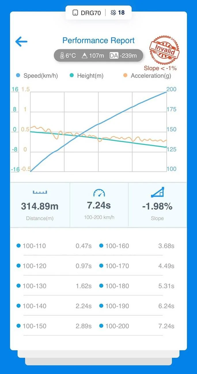

Very interesting thread. I'm going to read through it even if it seems a little more informative for the MT! This is my late October run with only the jb4 and catless dp. 100-200 run which is (62-124)
I should probably get a JesseDaBears tune, I feel a lot of turbo surge...
Need to get one without that -2 slope to really get a good idea what it’s doing sadly
Send me a PM if you want to get the stuttering worked out. Can take a few revisions on MTs. Solid time though!

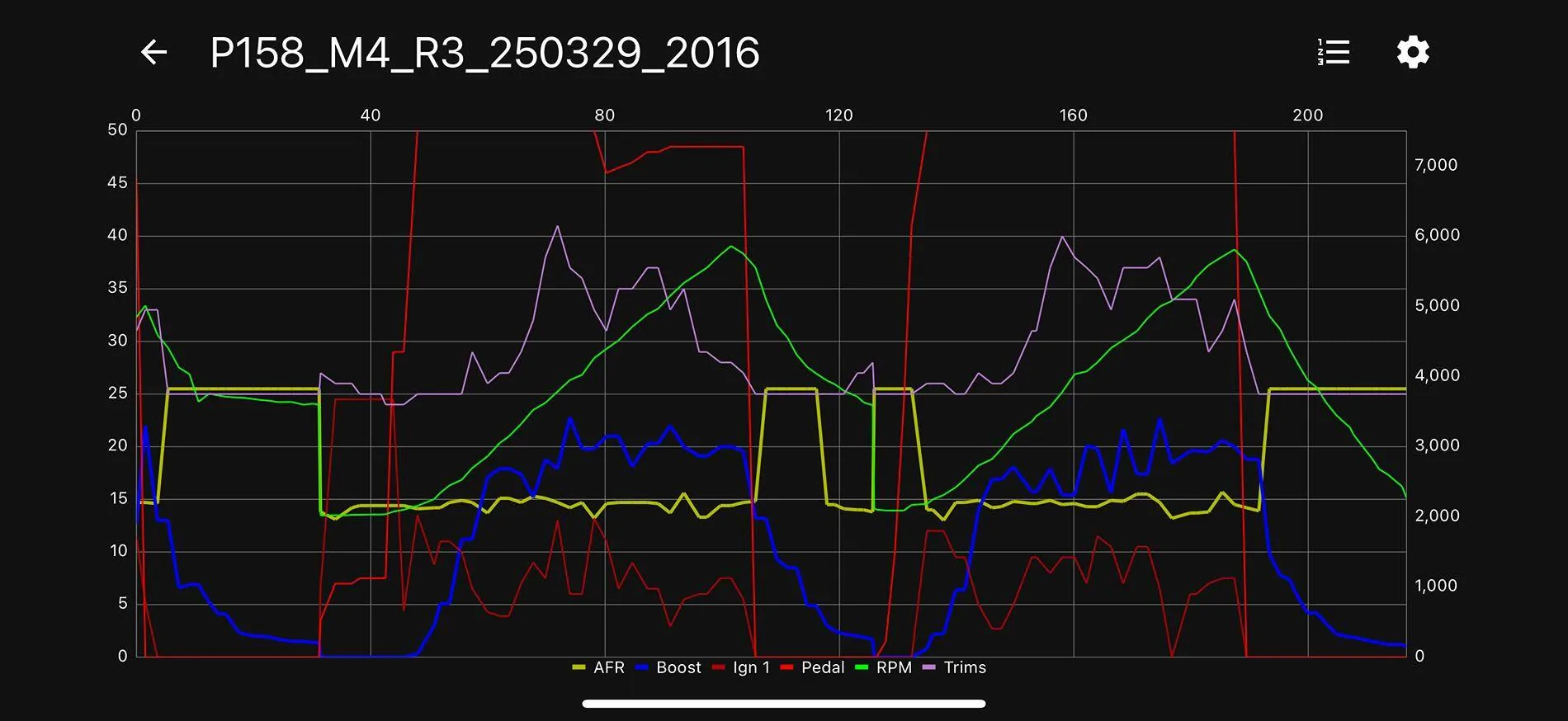

Ok i put E-40 which is probably a little less due to having some 91 in it already. I got it down to just 1 bar of fuel and put 4 gal E-85, 6 Gal 91 oct.
This is my map 4 log. It isnt liking something. Its pulling boost and then getting back on it over and over without me lifting the pedal. This is 2 runs of a 3rd gear 2k RPM log.
From the looks of your car, I’d say sheā€˜s running a bit hot ? But I’m no Colonel either. I wouldn’t even make rank of private nor pass JB4 boot camp.
