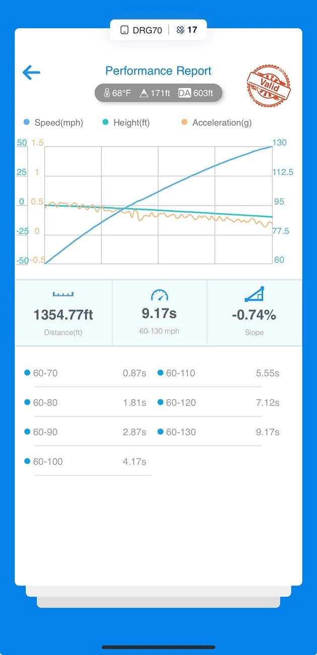

Inching closer to 8s 60-130

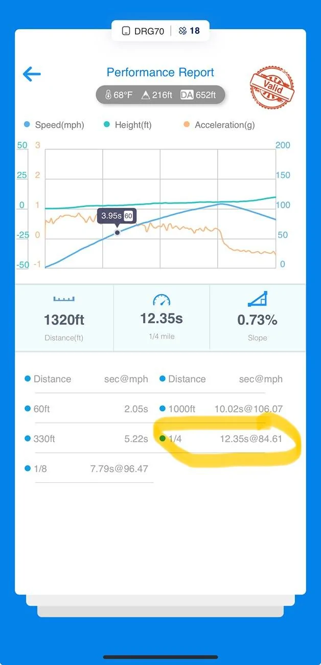

Stock rubber not hooking up. Highest trap speed in the 1/4.

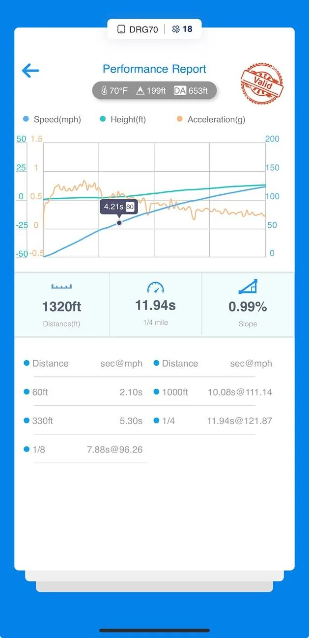

Was able to into the 11s in 1/4 but still not a good launch

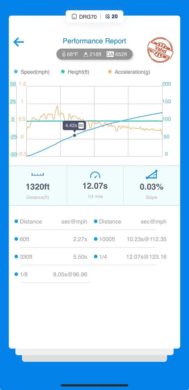

Here below I was practicing my launch. Wonder what the 1/4 would’ve been had I stayed in it.
Thanks everyone. Your tips and suggestions are working.
Was this map 6? log?
