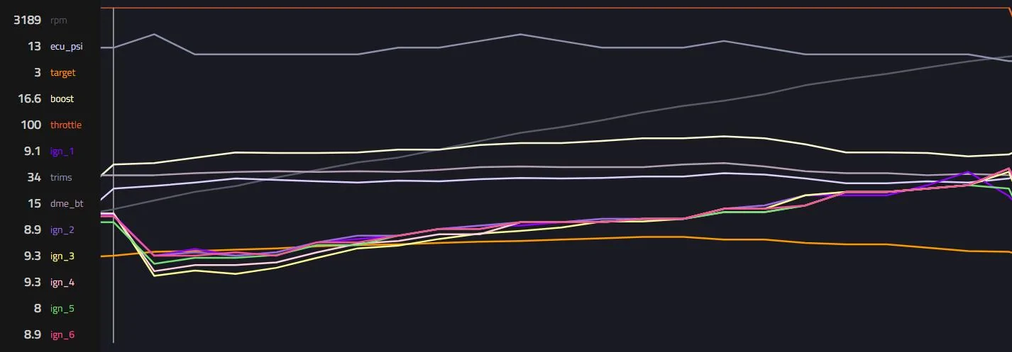

Hey guys, i just installed a hypercore on my 21 m340. Did some logs, and if you wouldn't mind looking them over. i am concerned about timing corrections if anyone could give me insight on how I can lower them.
Here's what's done to the car
- Dinan intake
-DAW Turbo inlet
-DAW hypercore turbo
-AA highflow DP
-Awe track exhaust
-BMS fuel pressure connector.
-AA chargepipe
-Sparkplugs are gapped to .22
cars on map 5 E33
https://datazap.me/u/chenzo/log-1751722681?log=0&data=1-4
- Dinan intake
-DAW Turbo inlet
-AA highflow DP
-Awe track exhaust
-AA chargepipe
cars on map 5 E33
timing looks great to me, map is fine
Should I not be worried about the ign 10 across 1-6? Genuine question, still learning about jb4. Also not sure how jb4 measures timing.
In general, ignition timing will do its thing and it changes with boost and gear and IAT (and which way the wind is blowing in cuba during that particular pull). We are primarily watching for knock by making sure all cylinders stay mostly aligned and rising.
yep, actually the newer firmware updates that change how ign1-6 are read is helpful in this regard. easier to tell the difference between low timing from IATs and actual corrections.
