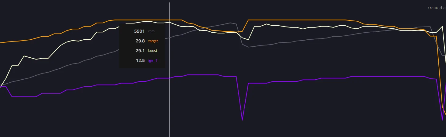

Welcome back forum. Here's a cool one I've been working on this week.
https://datazap.me/u/coloneladama/log-1753761986?log=0&data=1-3-4-11
Ultraflow X + BMS PI CANFUEL + BEF on E65 at 29+ psi. Should be over 600whp easily. Still working out some throttle closures in the BEF.
@mustafazumit pushing the JB4/BEF platform!

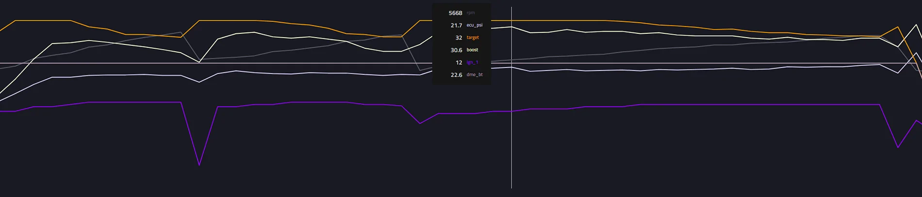

another spicy run at 30+ psi E70
6.46 60-130 at 1200 DA :thumbsup: Hunting down 5s next.
https://datazap.me/u/coloneladama/log-1754017158?log=0&data=1-2-3-4-11-15
