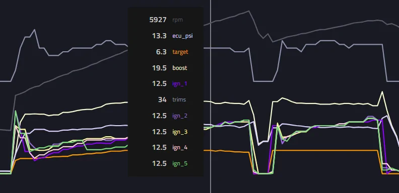

I added some ethanol, Fuel-It reads 50% now. I made a few adjustments after this log. Dropped WGDC in the lower rpm, dropped the FF from 35 to 30, increased FOL from 60 to 70, PID from 20 to 18. Is throttle closure related to calc_torque being 50 or is the HPFP low and offsetting with throttle? I did lower the max additive 1psi in case the HPFP was near its limit. Ideally I’m thinking of a target around 23psi with as much ethanol as it’ll take (up to 50%e) and then add boostane to see if timing increases with additional octane. Stock Dp currently, but have a Kenji “race” on the way.

you just need to drop duty4000 by 5 or so till the throttle clears up. yeah try to keep calc_tq under 49.
The car seems to take E50 fine but thats because boost is low. Ideal blend is more like E40 so you can run more boost, and timing should be fine.

Typically E40 you can run an additive 6 psi but with a taper up to 5k. I am around +6.3 psi on my car, it is about 20-21 psi but depends on IATs. Not really far off from an MHD map, but will never be as potent due to running leaner. (jb4 cant control AFR... yet)
FOL >70 starts to make the car behave strangely, VANOS faults, weird boost targets, limp mode, etc. You can't lower fuel pressure with JB4, only raise it.
My car for reference at FOL 65 at E35ish, Trims between 35-40 usually and quite flat. should be around 460-470whp.
https://datazap.me/u/coloneladama/log-1755810285?log=0&data=1-2-3-4-11-14-25-26-27-28&zoom=138-327

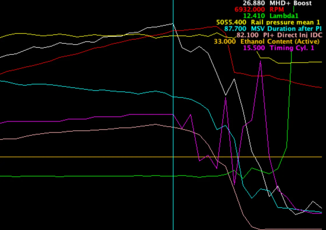

Yea, you won't be anywhere close to maxing out the oem HPFP on the stock turbo in the high mid and high rpm range. It's the low and low midrange you need to keep the boost down.
Even on something like a Pure800 you can run a bunch of boost through the top end on oem HPFP and ethanol. 28psi or so out the top you will max the oem injectors, depending on ethanol level.
For reference, here is a Pure800 with E33, stock fuel system.
Even at almost 27psi there is room. HPFP angle and Injector IDC have a good amount of room still. You can see the HPFP angle isn't even above 90 here (max of 126) on a Pure 800 with basically 27 psi. So stock turbo ain't going to be an issue.
