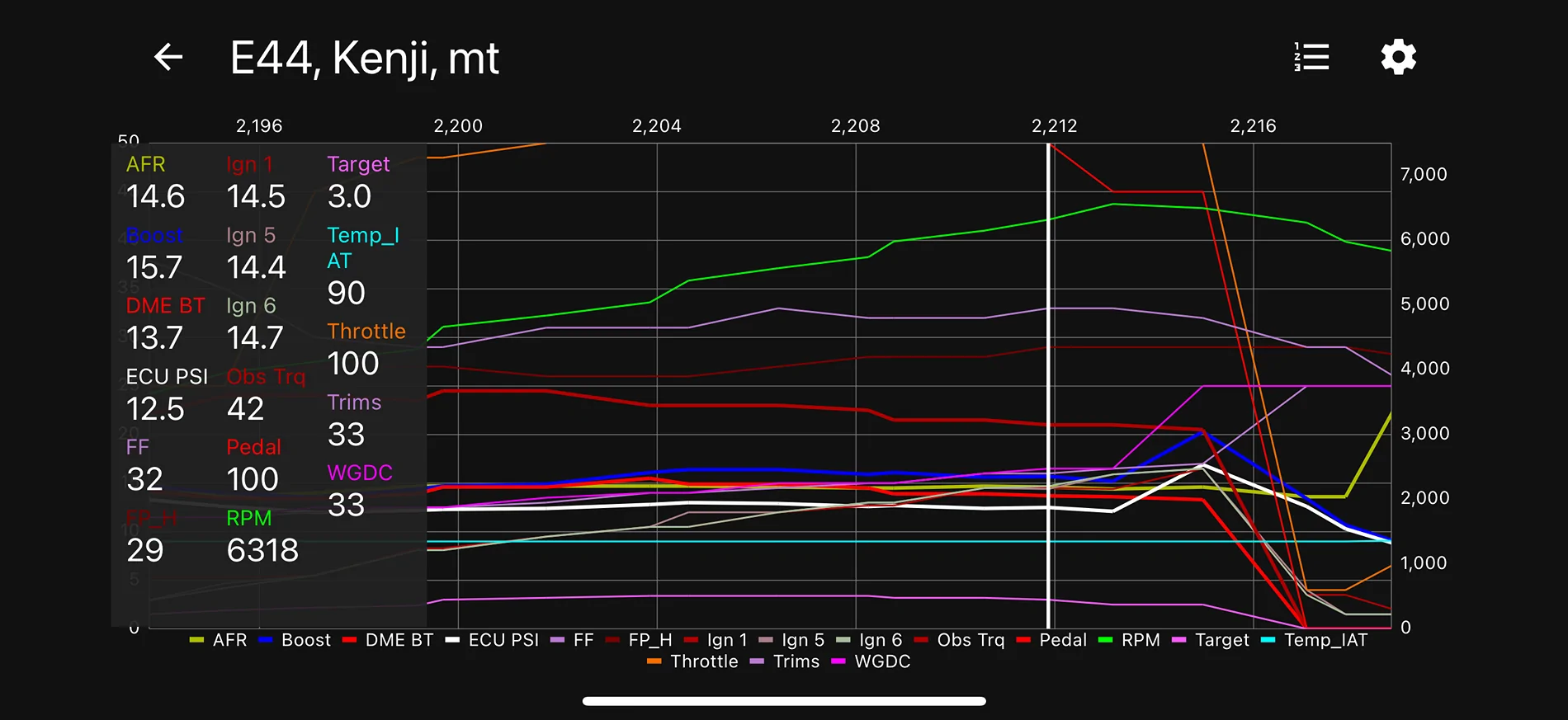

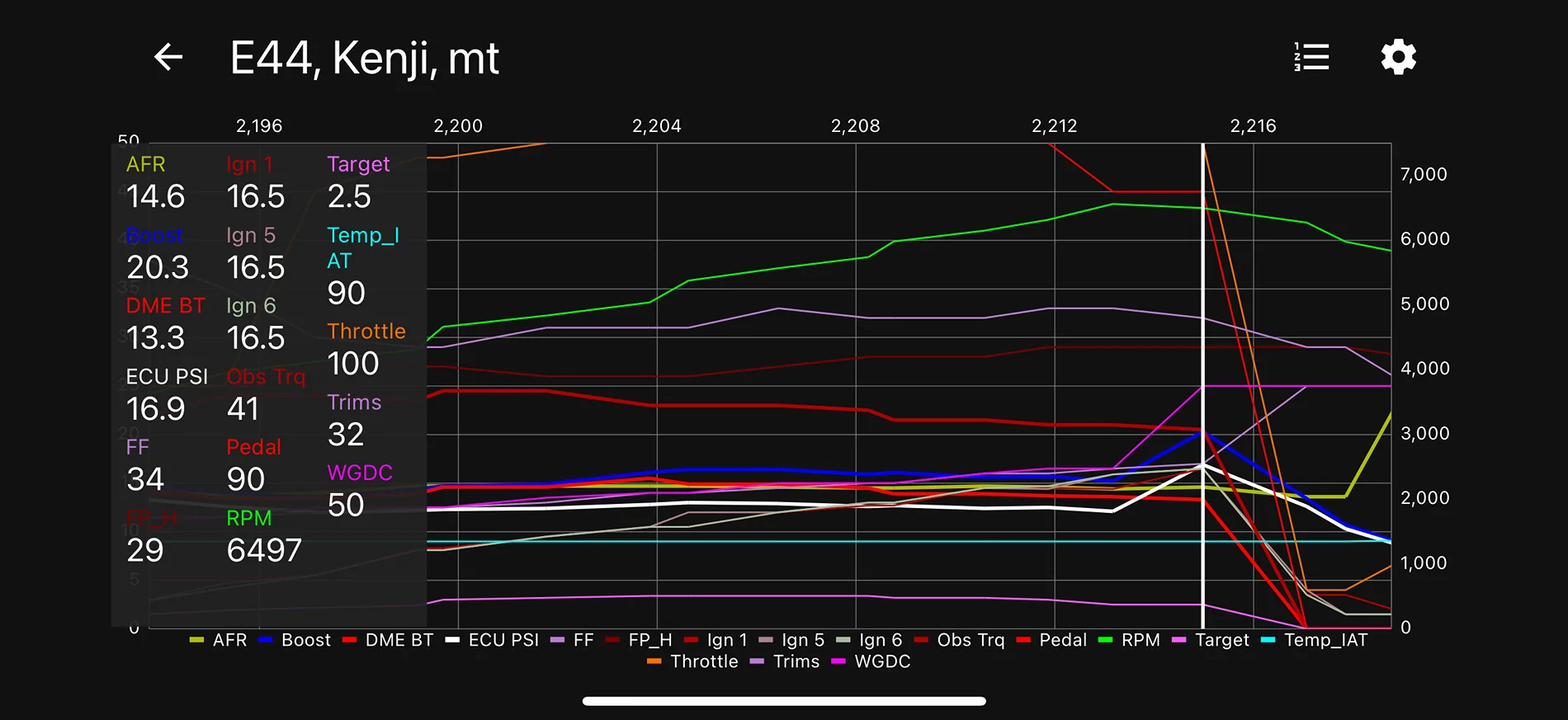

@ColonelAdama have you ran into over boost on up shifts with a mt? Jumped from 18psi to 28psi the other day. I’m assuming shift redux from each gear will be better than setting default wastegate position because I could control how much boost I’ve got going into the next gear vs a global wg default position making it variable on different shifts/load. Is shift redux field number related to WGDC %? Pedal drop at high rpm makes WGDC go to 50 while throttle is still 100%. I still have the boost low and have dropped from E50 to E44, but the HPFP isn’t keeping up with demand. Plan is to work ethanol down 5% at a time at lower boost until the fp_h is >28 and then add boost until I reach 21-23psi. Also assuming lower boost <4000rpm is just compensated by additional timing from the looks of it. I now have a Kenji race dp, lowered ff from 30 (stock dp) to 15 (Kenji) and dropped to 10 because of throttle closure. This was a 2nd gear pull letting off at 6500rpm.
yeah I get boost spikes when letting off and sometimes between shifts. I'll have to see with Terry if we can just have WGDC drop to 0 between shifts or something. Just look at boost2, the throttle definitely keeps boost under 28.
If you get on newer firmware you can see Aux3 is true wastegate position (range 0-80), and it is usually at 80 (100% dme WGDC) between shifts. I recommend E35-E40 for max power.
If you get on newer firmware you can see Aux3 is true wastegate position (range 0-80), and it is usually at 80 (100% WGDC) between shifts. I recommend E35-E40 for max power.
My assumption is dropping wg initial position would hurt response <1500rpm and on tip in where you could tailor boost on shifts with the redux feature. The other log went from 18-28psi on 2-3 shift and immediately reduced throttle. I read where he stated he wanted it high because manuals would drop boost on shifts, but the log suggests otherwise.. I may try 30-40 wg initial or 10-30 on the redux to see the changes.
MT car dme flash intentionally closes wastegate when off the pedal for response, yes.

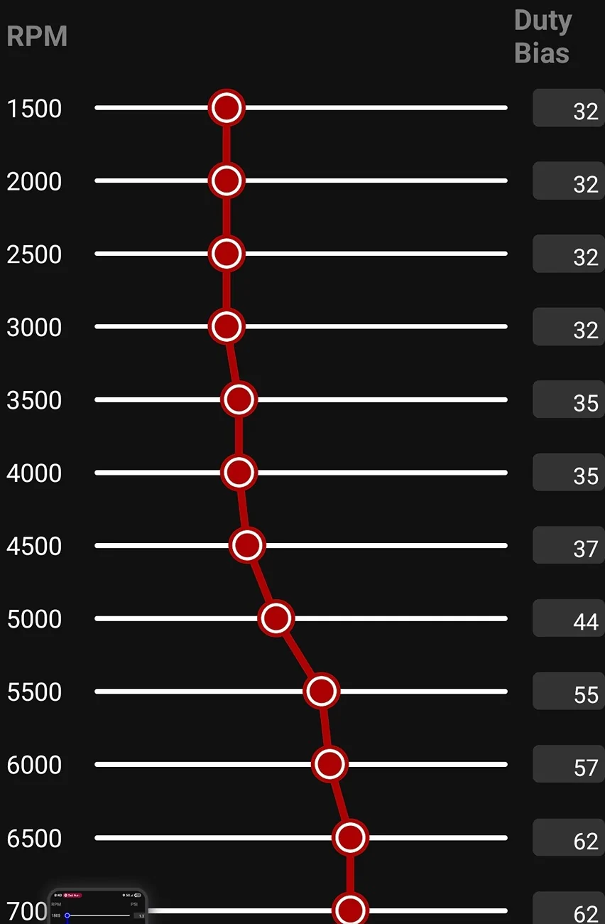

Any idea what might be going on here? All three of these pulls were within minutes of each other on the same drive. Only change was lowering FOL from 65-60 after the first pull. I've been getting major boost dips ever since I tried increasing FOL to 65. Second pull looks good, had really bad wheel spin at the start, but the third is terrible again. Absolutely zero changes between the second and third pull.
I've had the FP upgrade installed for weeks with no issues until I changed FOL. Running about E30.
it seems to just be the calc_tq>47 causing the closures.
In your good log, you see >47 tq at 3300, 4000, and 5000. At 5000 you can see it even try to pull boost back a little. So your best bet is starting to lower duty bias around those areas in increments 3-5 or so until calc_tq stays under 48, shouldn't really have closures, maybe occasionally.

duty_15duty_20duty_25duty_30duty_35duty_40duty_45duty_50duty_55duty_60duty_65duty_70
60​
60​
30​
30
30
40
45
56​
59​
64​
64​

I'll give that a shot. Thank you. Just threw me that the biggest closure on that last run was at 47 tq. I've had plenty of runs with closures, but never at 5000 and never that cut boost so hard after 3500. Maybe just a bad day.

The window of settings where you get it consistent is very small but possible.
